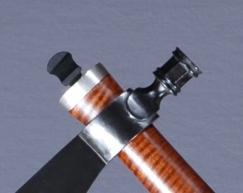

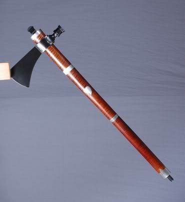

Thanks so much for the tips. I knew it would be tough but I'm not getting it right somehow. I had a 12 " bit an a drill press but had runout on the side about 2/3 from being all the way through. I wonder if I am trying to go too fast and pushing to hard. Anyway thanks again.
akmike-
Is this the head you started out with?
Did you get it from R E Davis co? I ask because I'm thinking about getting a head from them myself, but am wondering what kind of steel they're made from.
How did you harden yours? How well did it respond to hardening? In this other thread here it sounds like they're either made from 4140 or 8620. I wanna make sure which it is before I try buying.
You also have to clear the flutes about every 1/2" of depth. As soon as the flutes plug then it will take the path of least resistance which is never straight. Plugged flutes will also over heat your bit. That is why it took me almost an hour to bore out 12" of handle. Every 1/2" I had to unlock the lathe tailstock, pull the bit out, clear the flutes, re-advance the bit, lock the tailstock and drill another 1/2. For 12" of hole that is 24 cycles.
