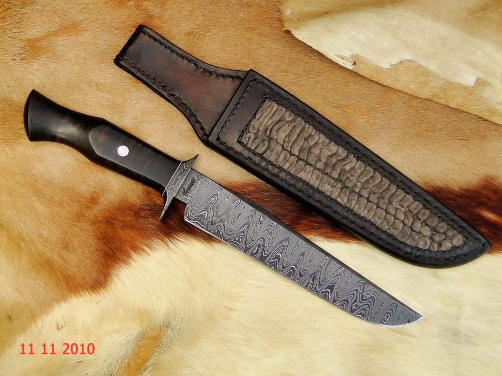

1° knife
best bowie knife
Damascus steel blade and guard (15n20 x 5160), 320 lines
Selective tempering, finishing with phosphate.
rosewood handle radicals
steel pin 1020
sheath cowhide leather insert and stomach (bovine)
dimensions:
width: 41mm
thickness: 5mm
Wire length: 191mm
total length: 332mm

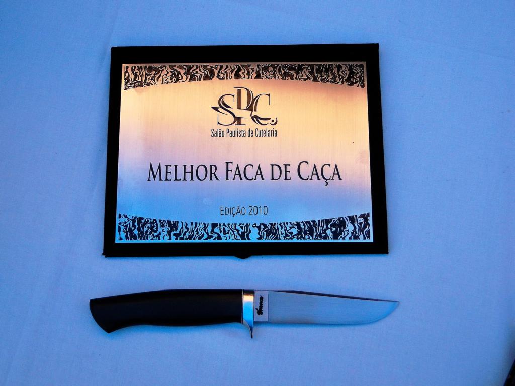

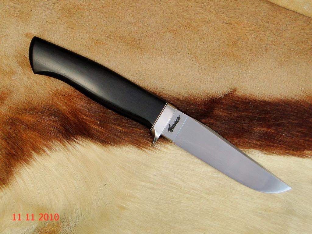

2° knife
best hunter knife
5160 steel blade, selective quenching
satin finish
Stainless steel guard
spacer Formica
ebony grip
leather sheath
size:
width: 30mm
thickness: 5mm
Wire Length: 112 mm
total length: 245mm

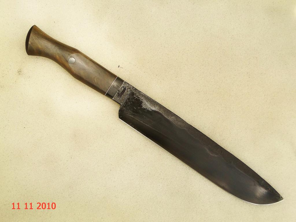

3° knife
best camp knife
Forged steel blade 52100
Triple selective hardening
phosphated finish
1020 phosphated steel ferrule
spacer Formica
grip Jaboticabeira
leather sheath
dimensions:
width: 44mm
thickness: 6mm
Wire length: 236mm
total length: 381mm
