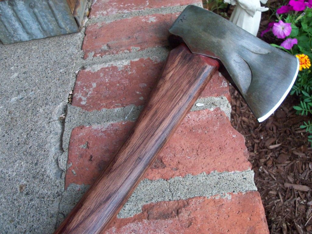

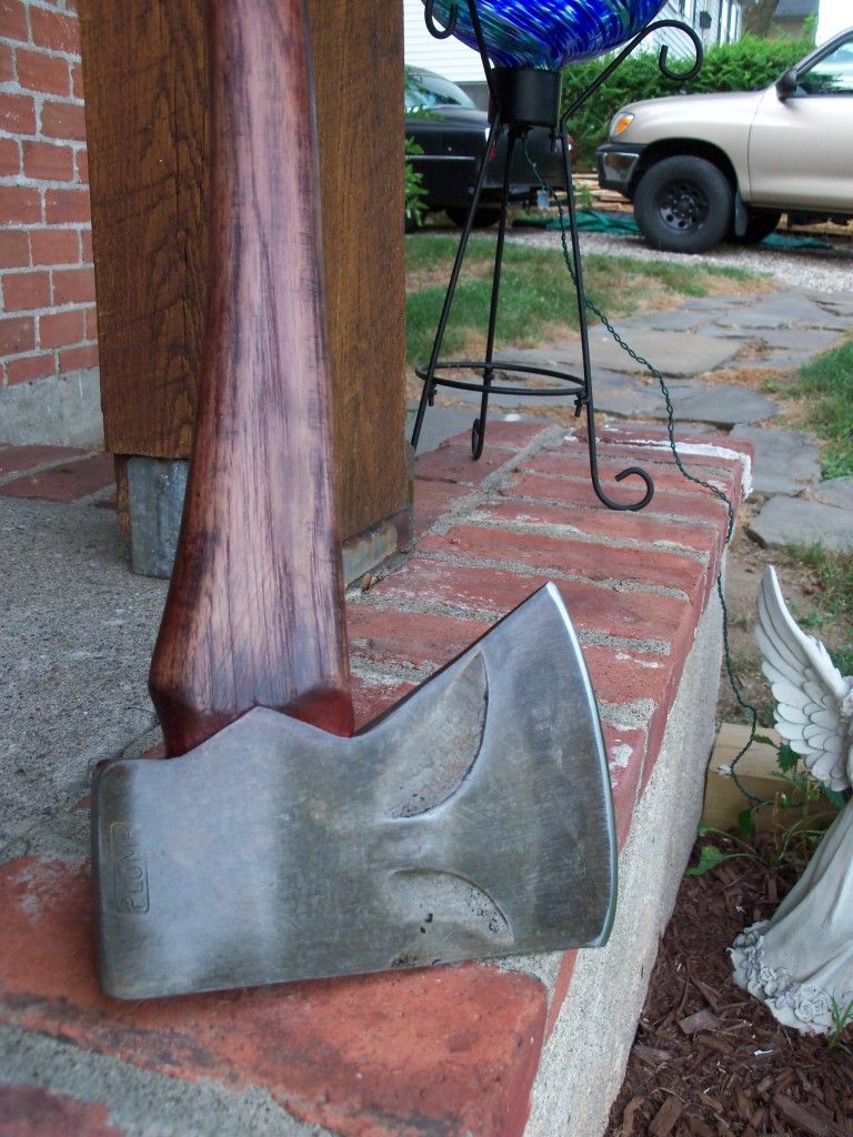

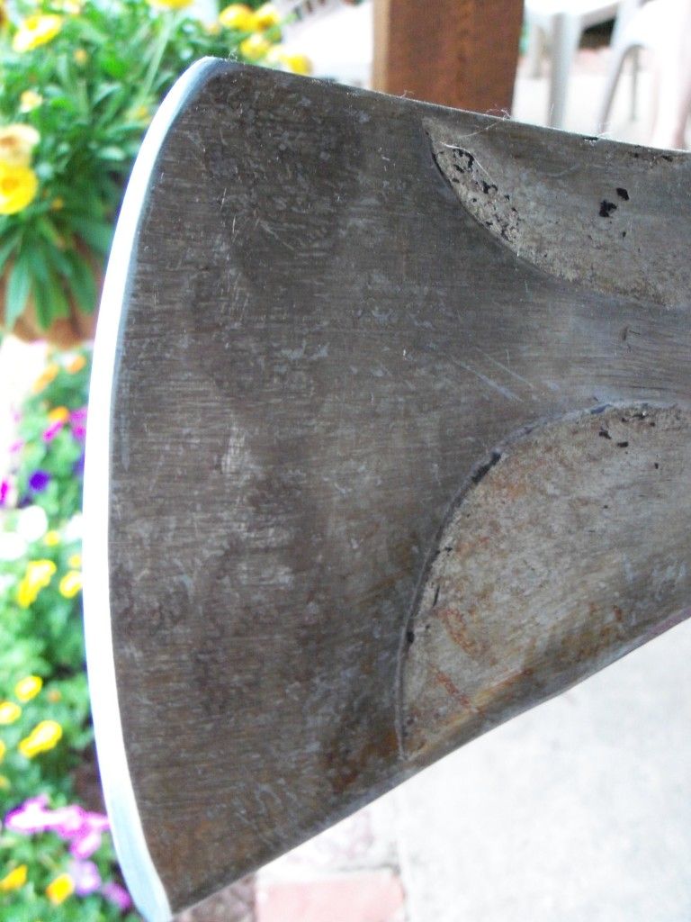

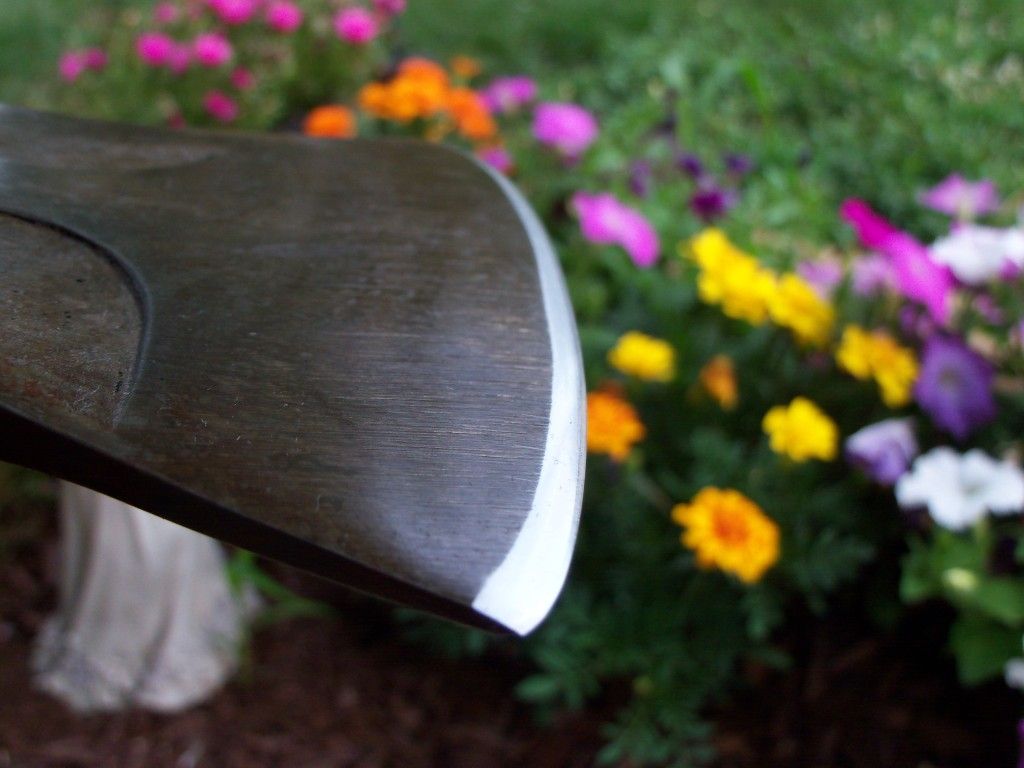

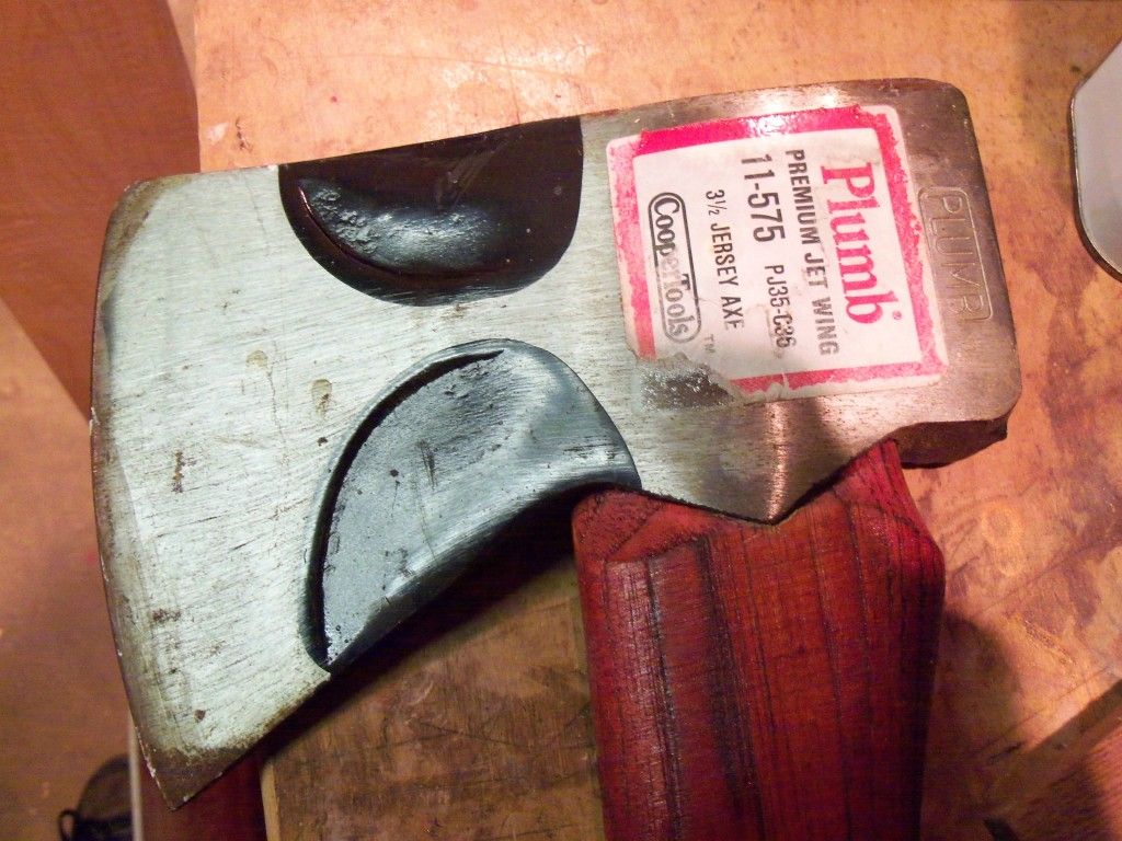

Hey all! I found this in a customers attic almost a year ago. She said it was likely her husbands or the previous owners. She also said she had no use for it and I could have it! So I took it home and stripped off the nasty red paint, filed all the edges round and smooth. Then I wet sanded the whole thing from 220 up to about 600 just to satinize and smooth it up. Totally re-profiled the HORRIBBLE edge and gave it a quick semi polished edge.

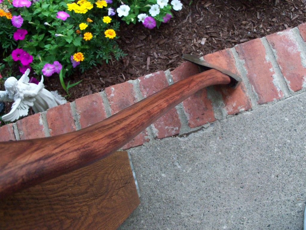

THe handle was sanded to about 1000 grit. I 2 color stained it and then applied a million coats of danish oil and rubbed it till it felt silky!
I also forced a hearty patina, then oiled well to keep rust at bay.
What do you guys think?

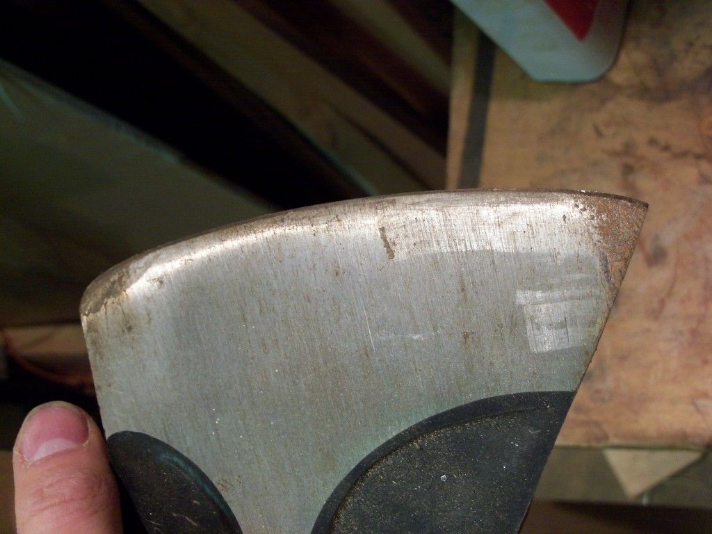

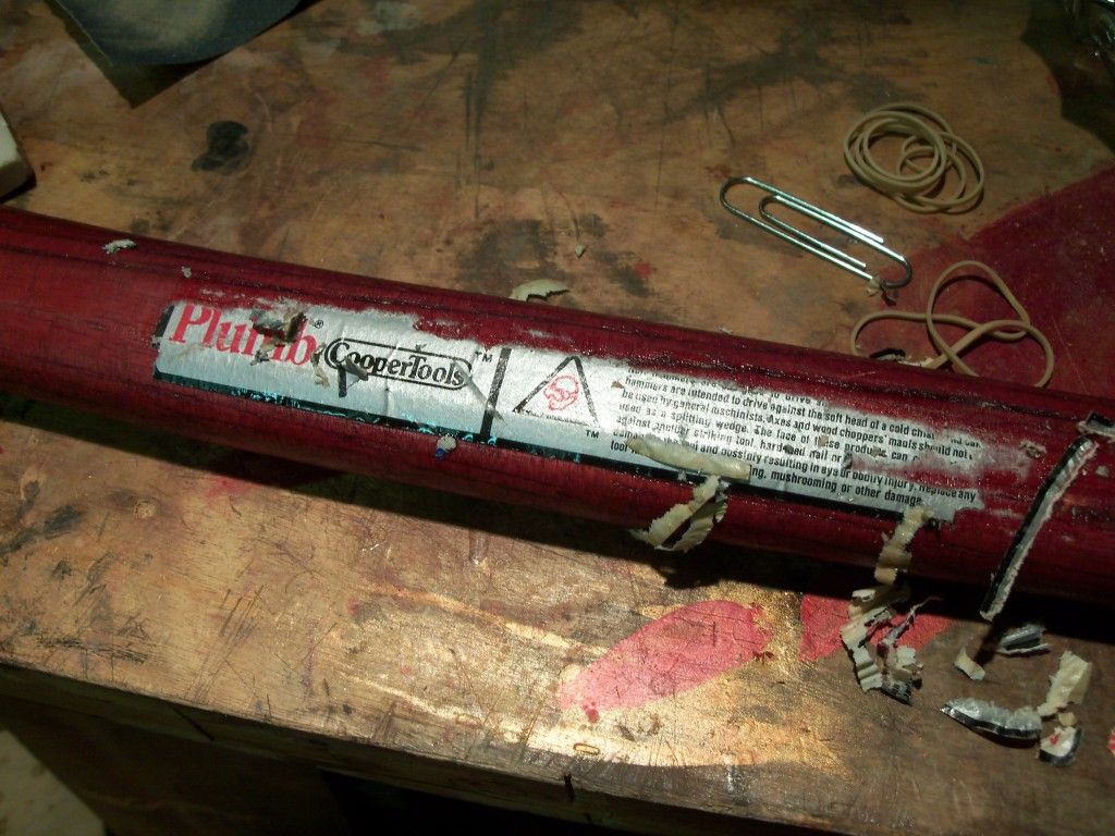

BEFORE
AFTER
