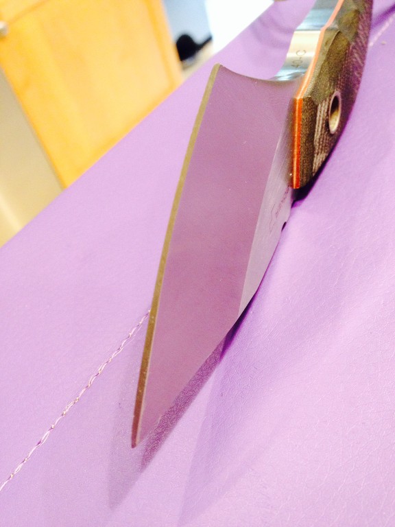

With the aligner, I was able to restore a pretty good consistent bevel on the MTT:
The edge is actually a little beat up again in this photo because I went around stabbing and slashing everything in sight. I am really brutal to the knife and it really doesn't look too fazed from my abuse. (I saw a quote from a member when I first joined that said: "Sharpen it like you love it. Use it like you hate it." - and I decided to embrace that attitude.)

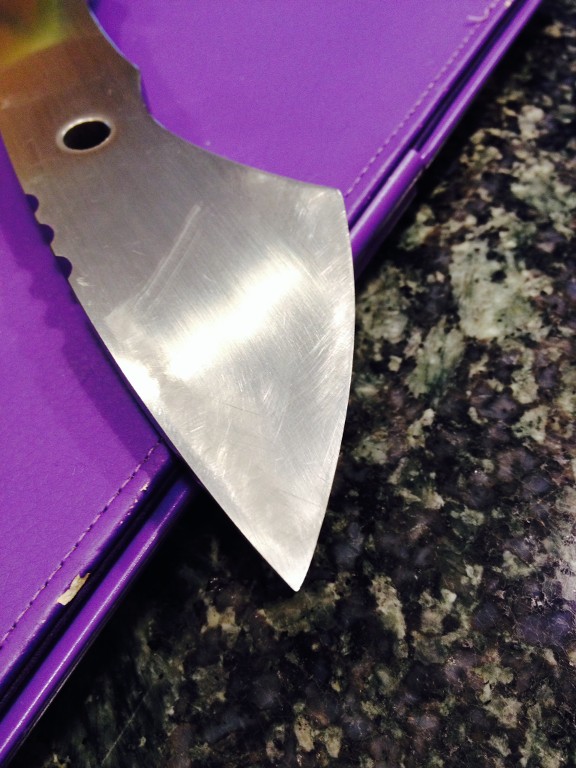

The back of the MTT is flat. I worked up a burr all along the edge and when I went to remove the burr it became apparent that the back of the knife is NOT perfectly flat.
What is the best way to get the back of the knife dead nuts flat? And the least expensive way?
Thanks again all. Loving my new knife hobby and this amazing forum.
(here is the back of the MTT):

As far as my extra question - I should clarify. I was able to get the clamp flat and tight on the blade no problem. I used setting 3 to re profile to approx 36 degrees.
Then I take the clamp off and take the stone out to run it flat (Zero degrees) across the back side to remove the burr. Well the flat 0 degree side of the knife is not perfectly flat.
I was thinking of holding it down on a belt sander until the back is a perfect plane, but then I worried about heating the steel up and ruining the heat treat.
Hopefully I'm explaining clearly but I'm still grasping at some of the proper lingo.
