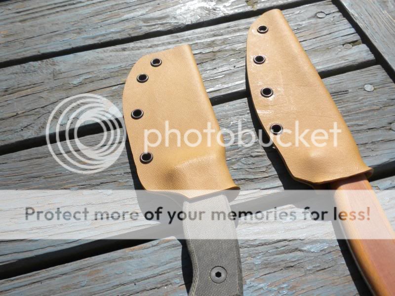

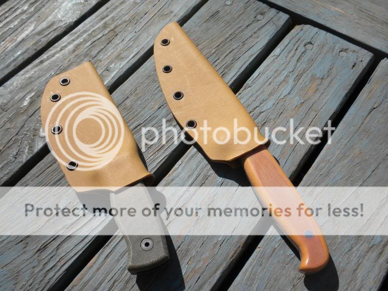

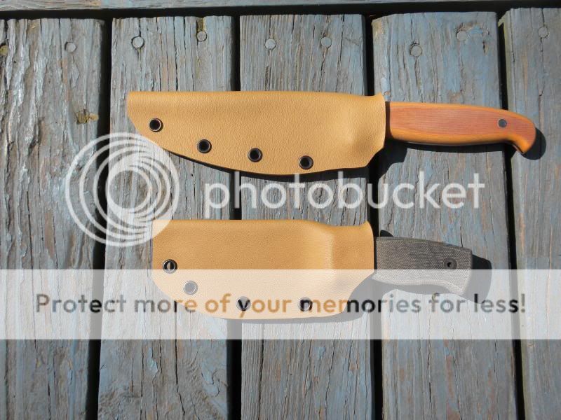

I'm hardly a craftsman so go easy on me, but I am pretty proud of what I've done so far here. This was done out of necessity. I recently got a custom boning knife made by Darrin Sanders (:thumbup: to that guy!) and wanted a way to keep it safe at work and during transportation from work to home. Leather doesn't seem very sanitary for food use, so plastic was the obvious choice. Since I was going through the trouble, I figured I'd finally make a useable pocket sheath for my Ontario Ranger Falcon because anyone who has any of these Ontario knives knows their sheaths are cheap junk. The knife is pocket sized, the sheath is trunk sized.
I spent about $38 including shipping for 2 square feet of coyote brown kydex, rivets, and a rivet die set. I used 3/4 of a square foot total on both of these, including a piece of scrap big enough for another small sheath. So I think I got my money's worth. I already had a heat gun, and for the "press" I bought a $4 foam mat that I just cut up and stood on with a piece of wood on top. This was a very cheap operation, I spend too much on knives as it is.
The molding took a few tries to get right, and the definition isn't great. I don't know if it's the thickness of the kydex or the kind of foam I was using. I think it may be too firm and not conform enough to the finer details like the blade. Then came the rivets. The first one went horribly, but after that I sort of got the hang of using the die. And as for form, well, I'm no artist. I did the shaping with a little hobby saw and 60 grit sandpaper, followed by 600 grit to smooth the edges. I redid the openings with tape strategically wrapped around the handles to get a little flare for smoother insertion. For the custom, I had to hand-flare the area where the choil/guard hit. I also hand-formed the thumb flare part...where you push off with your thumb. I don't know all the terms yet. Anywho, take a look.
Again, be nice. I know I could trim them down a little more, and I might. But for now, they serve their purpose. The boning knife doesn't really get carried, so I'm not too worried about it. The Ontario is actually pretty comfortable in my pocket as is, so I'm happy with it. The retention on both of them took a few adjustments to dial in, but they feel and work just the way I want them now. Functional, ugly, cheap, and mine!
