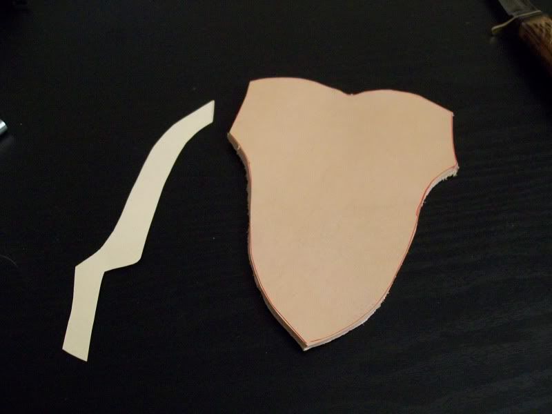

My uncle needed a sheath for his little German bird and trout knife, so I decided to try making him one. The Chuck Burrows video was a huge help to me.
I'm almost finished with it, but here's my progress up until now.

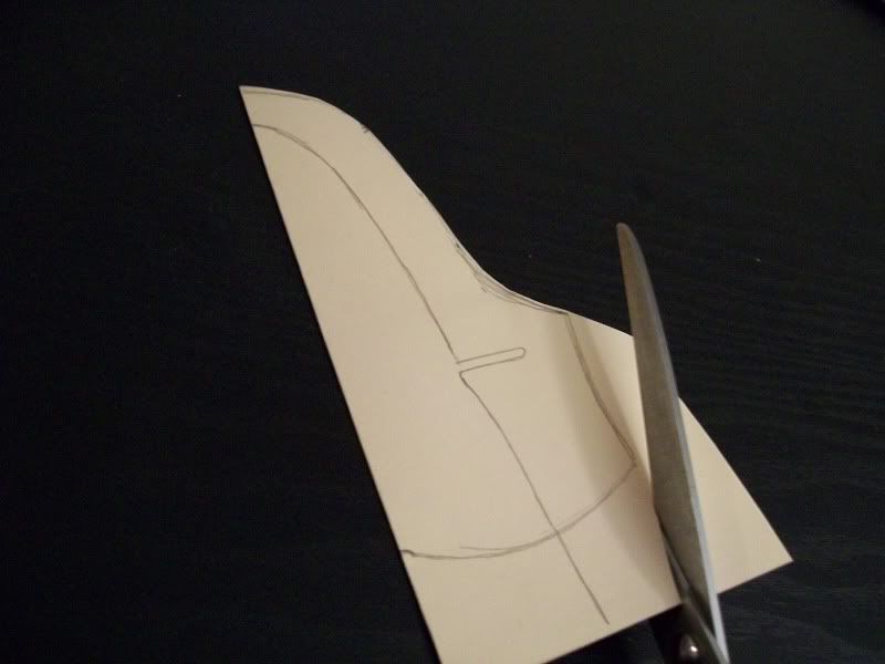

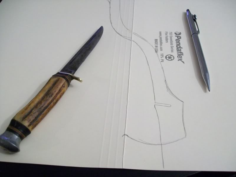

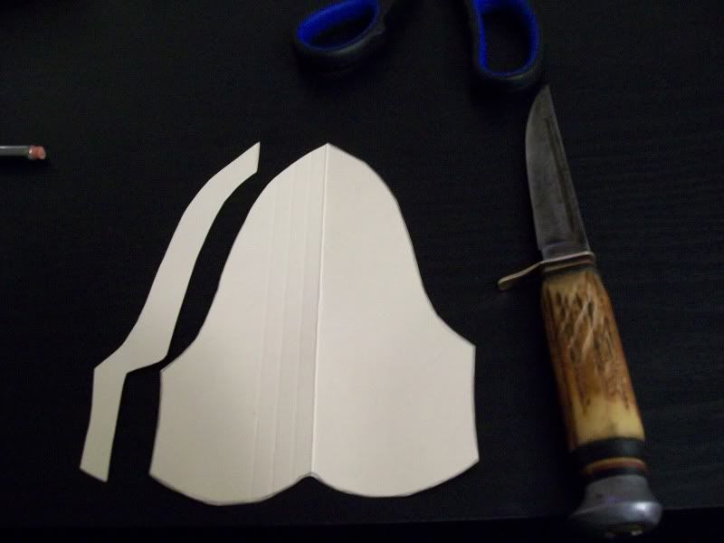

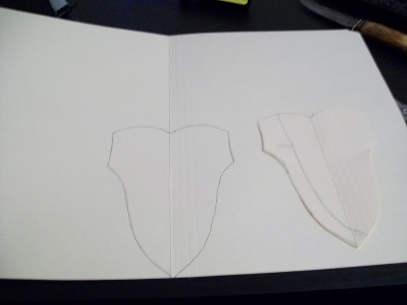

The manilla folder trick.

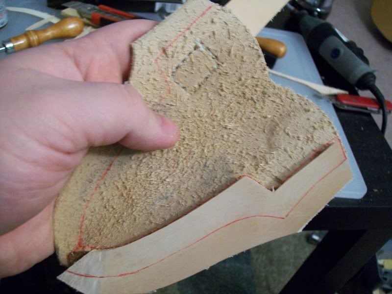

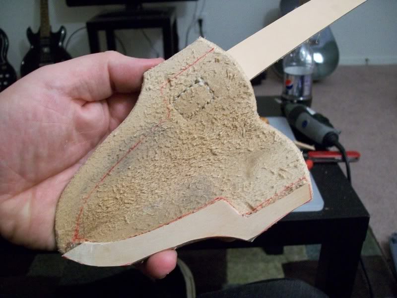

I decided to put my dremel to use for the holes. Makes things fast and easy. (It's kinda all i had too...)

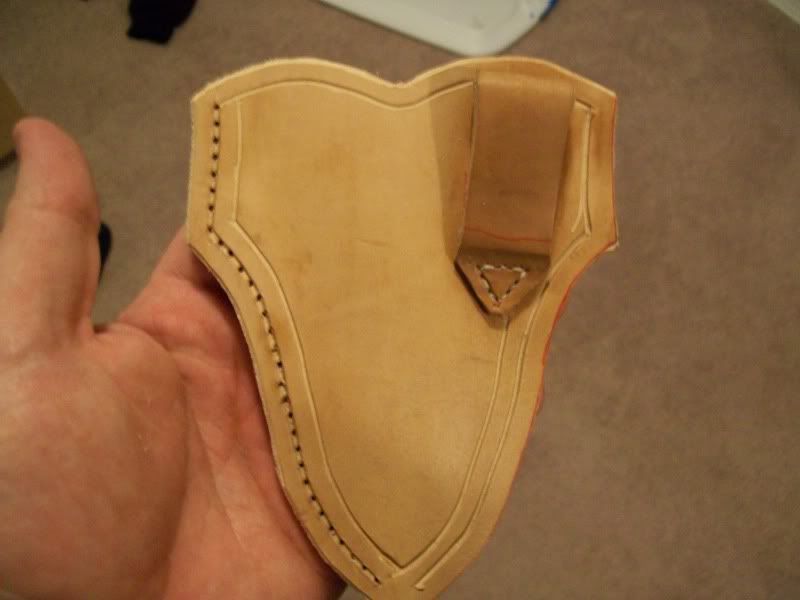

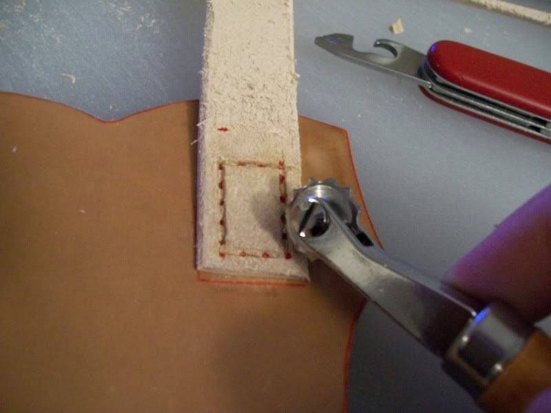

Cut the grooves and got the stitch holes established with the overstitch wheel.

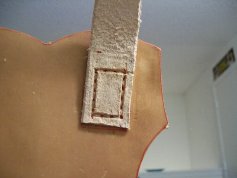

Not entirely happy with the belt loop....i had to make some room. the sheath is tiny!

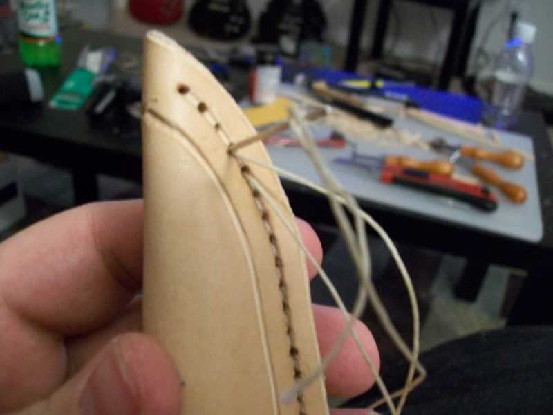

Helllloooo sore thumbs!

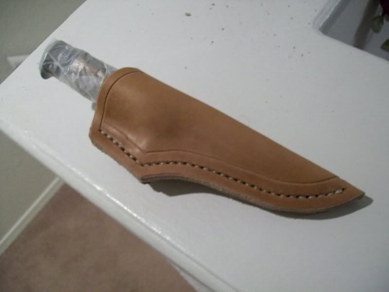

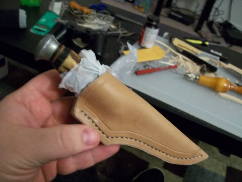

Knife wrapped in plastic and wet formed a bit to the sheath.

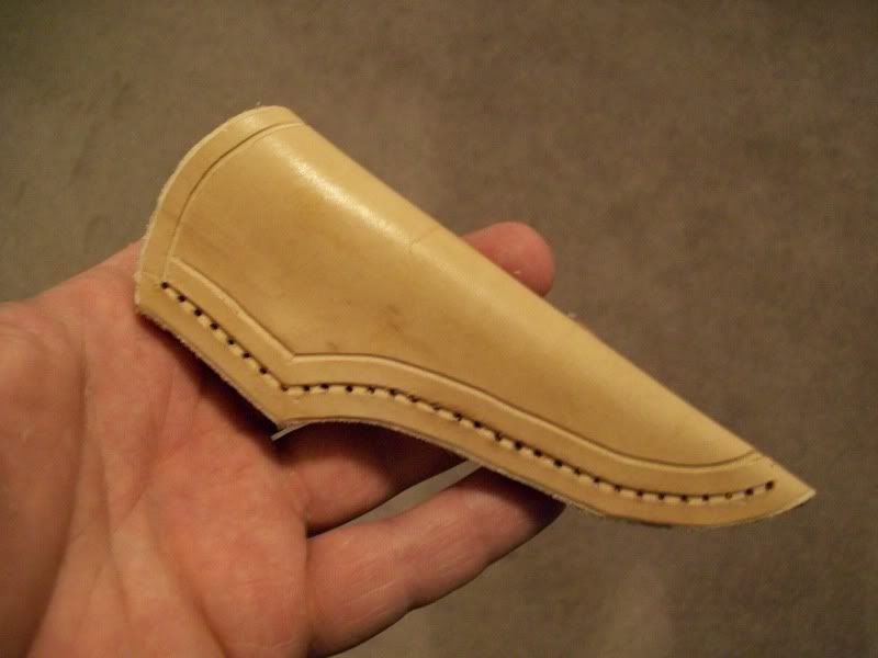

And there it is so far.... the sheath is dry now, and the knife slides in with a secure "click!" and will not shake out. I still have to clean some stuff up, put my edger to use, grind the welt area smooth with my sander, dye the thing etc etc....

Awesome pictures thanks for sharing. Forgive my ignorance but what is the star/wheel roller tool in pic #8 used for?

It's an overstitch wheel. When you cut your groove with your stitch groover, just run that little wheel into the groove and it marks where all the holes need to be and spaces them evenly. After you've stitched it up, you run the wheel over top of the stitches and it kinda flattens them out and makes the job look neater.

One tip - did you notice Chuck using a pair of needle nose pliers to pull the stubborn needles out. Do that to reduce the 'sore thumb' syndrome.
Also - use a slightly larger needle, and modify it to fit your dremel. That way you won't drill out material - it will just punch it out - like a round awl - it will make your stitches slightly stronger because of more leather.

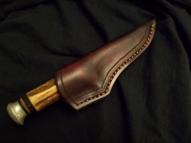

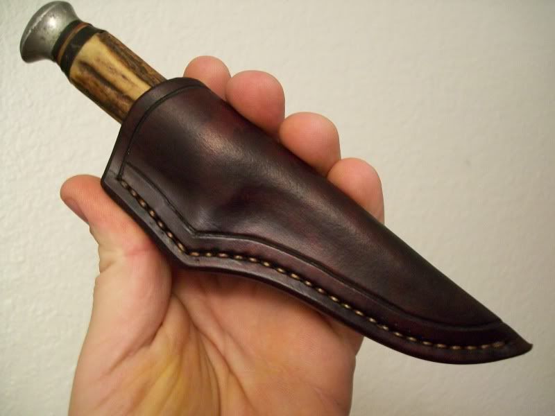

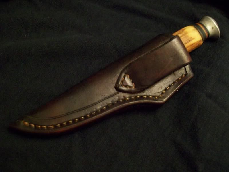

OH! here's the finished project. The dye is a bit uneven in places, but I think it has a certain visual appeal. I'm glad it came out that way.
I'm unsure how to finish it. The welt is burnished and slick, and the dye has kind of hardened the sheath and made it shiny. I don't have any Gum tragacanth or bag coat like in the video.
Enough of me babbling. Here she is!

+1 on that! Damn, it is beautiful. Not only the craftsmanship, but the lines and coloring are superb. I love the way the uneven coloring in the leather picks up the same brown tones in the antler of the knife handle.
Eric
Thanks Eric. I thought that about the handle too. The dye is uneven, but I think it looks really unique. Before I dyed it, I cleaned the leather really well with alcohol like Chuck instructs on his video, but some leather just does what it wants to do I guess.
I think the brown compliments the knife nicely. The uneven dye, and the little dings and mistakes I made sort of gives it a worn or aged look, which suits the knife too. Purely accidental.
