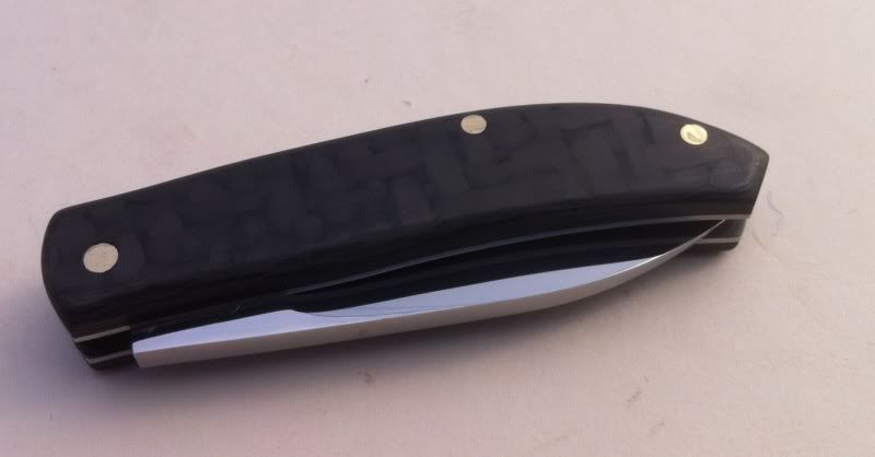

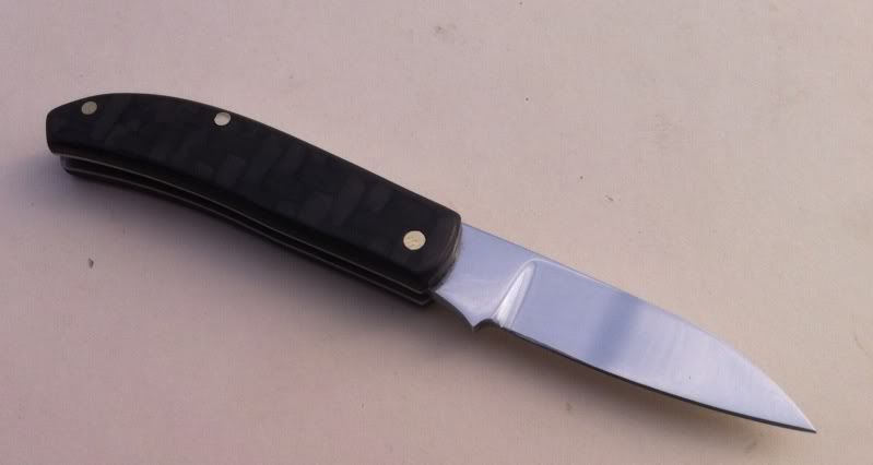

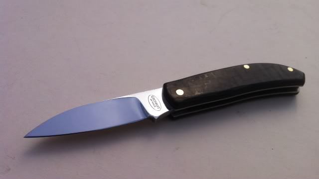

Hello all,
Firstly let me say I'm actually messing my pants taking the bold chance of posting my pathetic pictures on this outstanding forum for the worlds greats to see and most properly laugh and then rip it apart.
But I feel we all have to start some where, so if I get at least one person liking it I'll be smiling all day.
To be honest it's Marcus Lin who emailed me this morning that sort of un intentionally made me make the jump and post, if he thinks it's a nice and my first hollow grind as well is ok then what the hell!
So without any more bull..here she is:
Semi Skinner slippy
80CrV2 blade and spring
CF scales, thin liners and brass pins.
So sorry for my poor pictures.
Thank you so much for taking the time to look
Brian

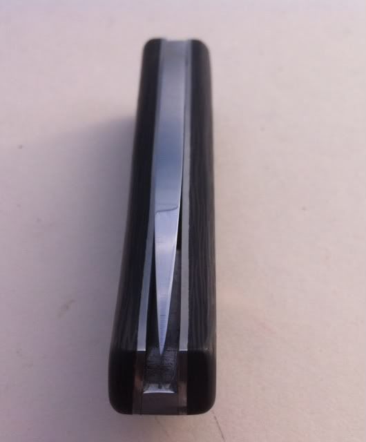

Wow. Thats actually not bad! I we want to get really critical I suppose that one could bring up the thickness of the whole knife. However, as a work knife that thing actually looks awesome!!! How is the snap on the blade? But I really like the grind and the blade shape! Maybe on the next you could round the handles a little more and make the scales a little thinner?
Just a couple observations.

Very nice first try. I like it and the blade has good lines. I will second that you could thin and round the scales (still could and re post). It could use a nail nick on the next one.

now i keep looking at the scale width how thin are you talking in your expert eye if you can help me out? 3-4mm or less? i m really not sure i done what was pleasing to my eye and look right.

I am not sure of the actual measurements; but by the pictures I might reduce each scale by a third.

It looks good. However, while I can see the value of thinning the scales, my only critique is that the blade looks too thick for it to be the kind of slicer that I expect my slip joints to be. The fashion these days seems to be for thick blades, but slip joints are slicers, first and foremost, and having the blade be that thick means that the material you're cutting will be wedged apart at least as much as it's cut. The fit looks really, really good, and although I'm more of a bone/stag guy when it comes to knife scale materials, I like the clean modern lines of your version.

Don't apologize, Brian. Making a slip joint is a pretty serious undertaking, and I'd say you pulled it off. It's really all a matter of perspective - locking folder fans might want one blade style, and most slip joint users want another. Just as an example, the blade of the sodbuster that I got from Keith Johnson is 3/32" thick, with a flat grind. It's one heck of a slicer, and that's exactly what I want. For a knife like you've made, I'd want it to disappear in my pocket, both in terms of weight and overall thickness. With thinner blade stock and covers that are a bit more rounded, you'll be there. I'll definitely be interested to see how the 1095 version turns out, because I'm a carbon steel snob and a confirmed lover of 1095.
Very nicely done Brian! Looks like a sturdy conservative single blade user that would drop nicely into my rucksack for a day afield brookie fishing in the Rockies, or maybe slicing cheese and hard salami while hanging out with friends & ale. Congrats and keep them coming!

I like the blade. As for the scales, in the last photo the thickness looks pretty good when you compare them to the thickness of the top of the blade. I wonder how it would look if you rounded the edges of the scales a bit more?
Regardless, I think it turned out great for your first slipjoint.

The blade is .135" thick. That should give you an idea of the scale thickness.:D We had a choice of three stock thicknesses for the blade, much too thick, slightly too thick and much too thin. We decided to go with slightly too thick.:)

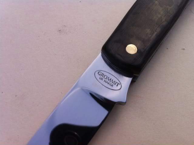

The pin holes were teemed before peening, I really took my time on peening, I can remember many a error on doing my straight razors so it was on my mind all along.
