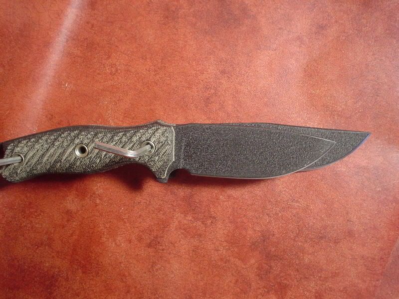

The M6 is pretty much larger than the Ratmandu in every way: the blade is longer, taller and thicker and the handle is longer, taller and thicker.

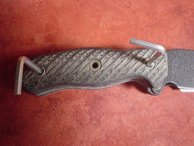

However, the Ratmandu is very similar to the HRLM. The RMD and HRLM have the same handle, same blade thickness and the belly of the blade has very similar curves - there are some minor variations of the blade shape at the spine and the blade drops a little more on the HRLM. The Ratmandu's blade is about 1.125" longer than than the HRLM's.
The thumbramps look a little different, but function very similarly in the hand. My thumb naturally falls just at the forward side of each ramp. The RMD ramp just flattens out. The HRLM has a recess forward of the first bump and has two bumps. For me, when I get around to tweeking my HRLM, fixing the choil, stripping the coating, etc., I will probably extend the recess forward just a hair. I like the recess, but my thumb needs just a tad more room for movement. The flat over the RMD's ramp works very well for me.
A notable difference aside from blade length is the choil. The RMD has a functional choil. The HRLM has a choil that is too small to use and too large to not be made useful - wasted space! :confused: :confused:
I have not yet modified the choil on my HRLM, but I will. Many others have taken a dremel or appropriately sized drum sander to theirs to make it work. I am actually O.K. with having to do this because it is a simple fix and it allows me to shape the choil how and "WHERE" I want it. I like my choils in close like on the SS4 and Bog Dog.

The following are some pics of the HRLM stacked on the RMD. Notice I pinned the handles together as the holes line up perfectly. The handles are for all intensive purposes exactly the same from the pommels up to the thumbramps and choils. Where the thumbramps are slightly different and choils are different.
