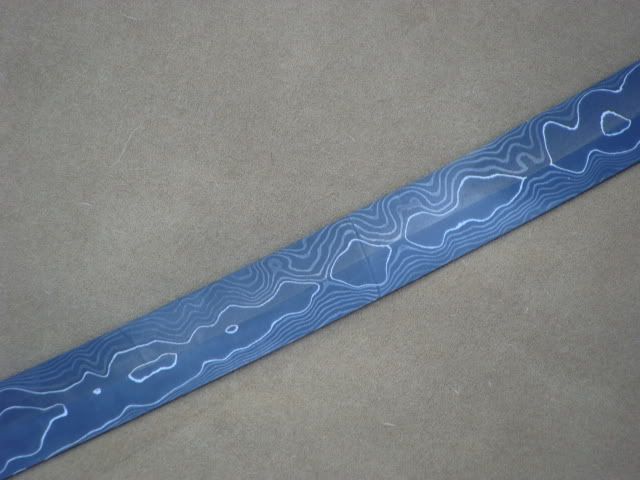

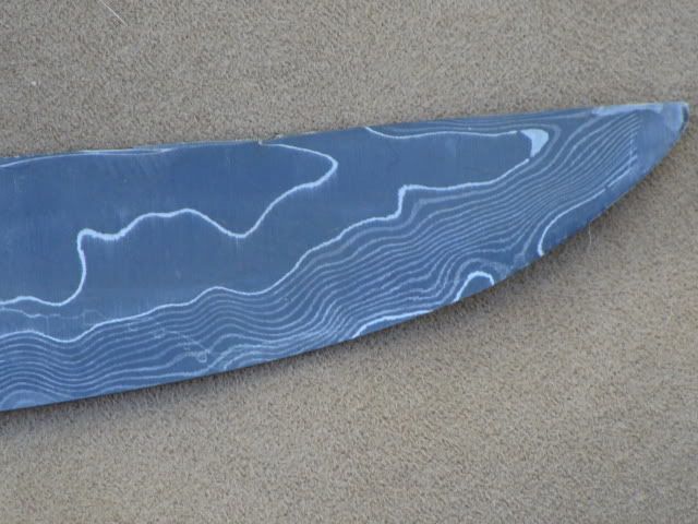

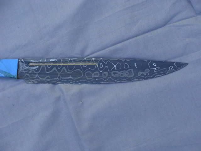

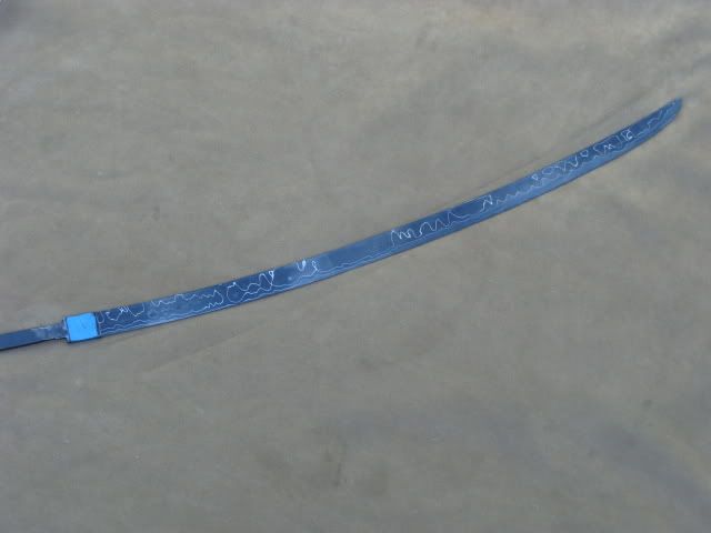

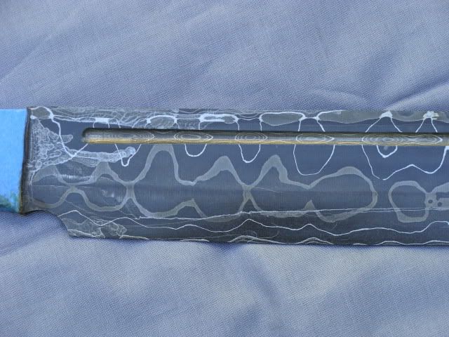

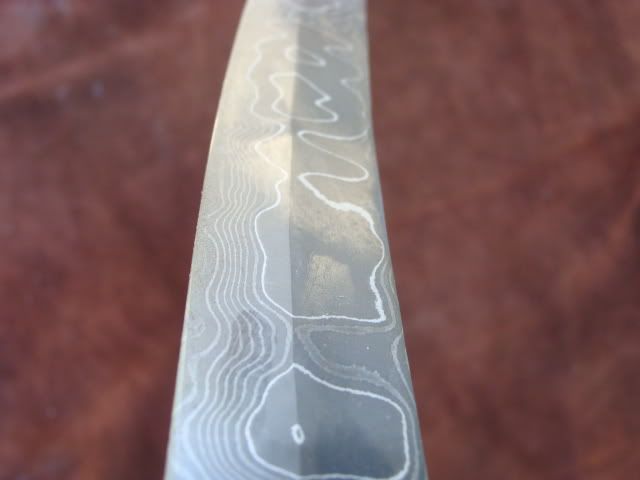

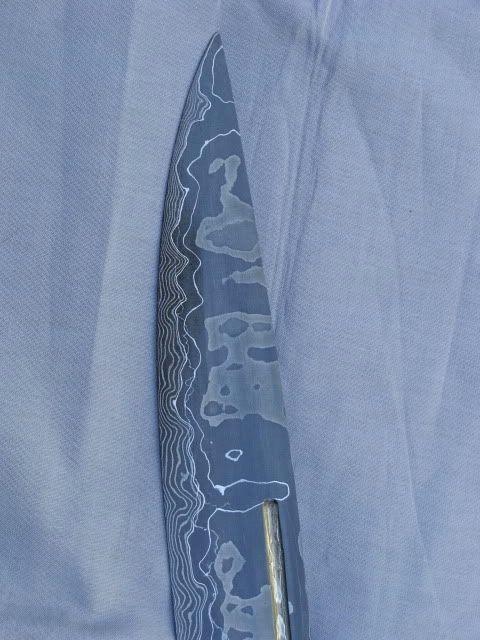

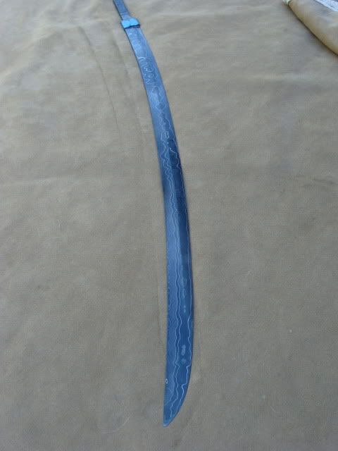

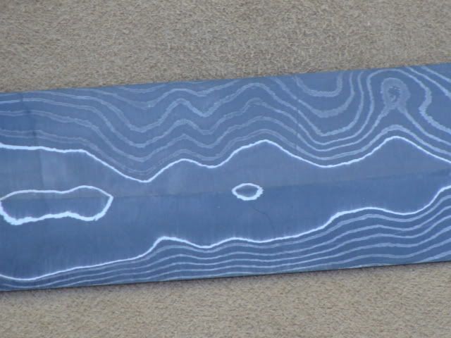

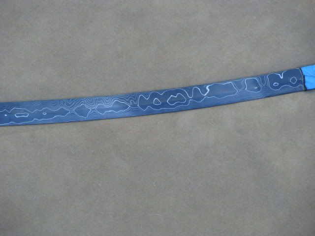

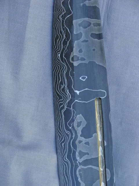

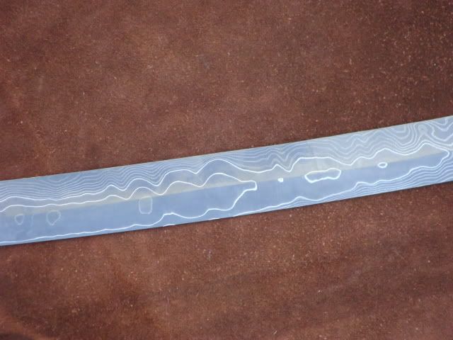

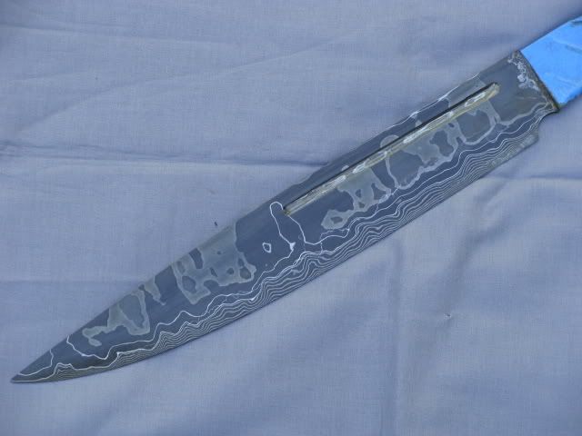

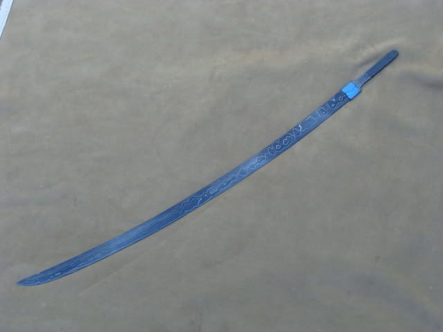

ok this is not finished but its a start i still need to learn how to make a hilt this weekend this lady is going to show me how to make a mole for it. this sword is for a civil war re enactor its 36" long 42" over all its 60 layers of 1095,L-6,15n20,1084 it took all day to pound out i used a 100lbs little giant also made a matching bowie this sword is the same as the wife uses in her reenactments 1862 ames ,the top half of the sword is hollow ground and the edge is flat ground. i'll post the bowie below also.lots of pix's.
