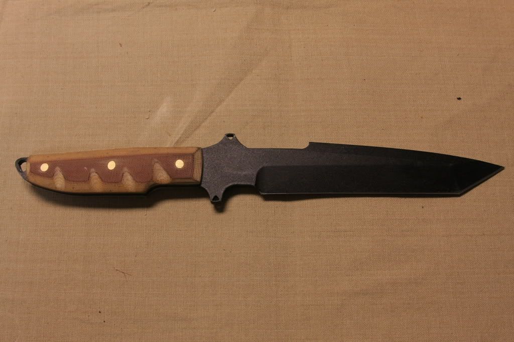

hey everybody!
have been on for a while.. calculus takes up knife time.
anyway.. this is a knife i designed in autocad (my first) and the guys at work cut it out of 1/4" 5160 on the water-jet.
specs:
14.25" oal
8.5" blade
1.5" wide
differentially hardened 5160 blade with hard etch and epoxy coating
natural canvas micarta scales
brass pins
kydex sheath with tek lok (still to be made)
it started out with green scales, but i messed them up.. so i had to use tan. i heavily etched the blade with a mixture of gun bluing and acid, after bead blasting it. but it wasnt quite dark enough. the paratrooper i am giving it to asked that it have a matte black blade. so while the paint will eventually come off in use.. it is still really dark underneath.
this is my first tactical knife, so feedback would be greatly appreciated.
thanks so much
thanks so much
~Chris
