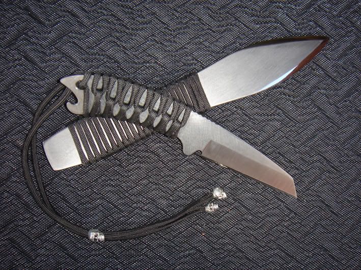

Well the pictures are not that great but you should be able to judge my work ok .1/8" Titanium 6 1/2" long wrapped in 550 paracord with a slip lanyard.

Nice and functional looking! Is that a bottle opener at the end? Sort of reminds me of Tom Krein's stuff
I like it alot. Good on you mate.
Thank You ,You are the 284th viewer and only two comments about it , I think it takes a while to get noticed here or maybe its a bit close to being a copy of another knife but it has simple lines and easy to make for a first off.
Forgive me if I am wrong, but the knife looks like a the new knife in the CRKT line up. Did you make it titanium? Cool!
The back end does look like Kreins Dogfish neck knife but that could be a result of necessity of design rather than intentional copying. I mean how many ways can you design a bottle opener? Do you sell those? I bet folks would buy those up flat out like a lizzard drinking.( Always like to use that phrase):D
Truth is I still have a full time job fixing all the metal parts on planes, I mostly hand filed the whole knife because Titanium does not like to be ground on a belt much and it kills a belt in no time at all. My brother in-law has put in a order for one but it will be for his birthday.I normally only make a knife I would like to have because most of the custom knives are out of my price range or the Australian customs would frown on the ones I would like to buy.
I have been making ,tempering,polishing my own knives ,punches,chisels since I was 18 (60 now). Maybe I will start making them for sale when I retire or get a offer I can`t refuse.:)
Richard
Whats the Rc on the titanium? I've heard it only gets into the 40's and its pretty hard to grind and form an edge.
Not sure Uncle but I will take it to work and put it in the hardness tester for you.I am off work now untill next Monday so it will be a while before I can get back to you.
You can`t see it very well in the photo but it has a double edge all done by hand ,Filed ,220 grit paper ,400 grit paper ,800 grit paper,800 with oil then stropped .
Not done a lot of testing on it to see how long the edge lasts .;)

When you work on aircraft every thing you use must be traceable right back to the manufacturer,there were two pieces of 1/8 Titanium 12" X 15" that some one forgot to put the info on and was going in the bin ,I took it home and decided to make somthing out of it,no other reason,I have cut some 550 cord and shaved soft pine with it and it still shaves ok.
