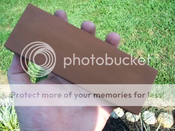

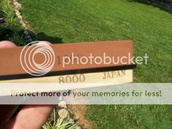

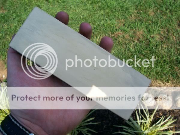

Just got my first water stones in the mail the other day. I was not sure what kind to get, so I got the 1200-8000 grit combination. I have been freehand sharpening with various grits of hard arkansas and india stones since I was a little boy, and those have always gotten me the hair popping edge that I desired.
I had only recently learned about Japanese waterstones and decided to finally pick one up. I am super impressed with how fast they cut, and how smooth they feel, and the extremely high polish the 8000 grit stone leaves on my edges.
I do have to say that they are very different than what I'm used to. These things are messy! I have a slight problem... even though my edges are brighter than the highest polish I could ever get with a fine Arkansas and a strop, they don't seem to be sharper. Maybe I need to practice alot more.
If there are any tips or techniques you guys can offer, I'd really appreciate it.

I think from your photo that you have a KING brand waterstone. I have a slightly courser one.
It is a good stone.
