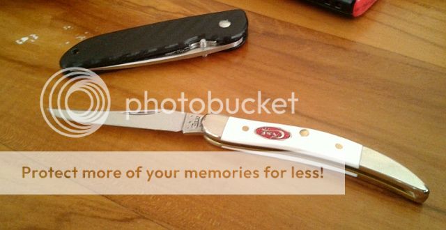

Finally I own Case's knife, a Sparxx Tiny Toothpick.
Beautiful knife, but it comes with few questions in my mind.

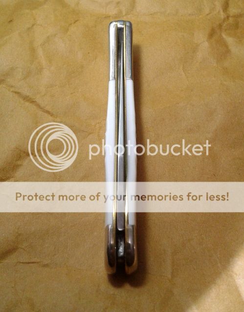

- When closed, the blade's tip is not center aligned. Is it normal? No blade play though.
- The blade comes with micro burrs on its edge, not stropped? I can feel it when I touch it with my finger.
I don't know if it's normal or not, just wondering :)
Case's tend to come with a pretty rough factory edge, Is it a stainless model? I have heard that Case's trusharp stainless tends to burr easily. Case's tend to be a bit off center, my swayback had a centered pen with off center main. My peanut had both blades slightly off center towards their nail nicks and my Chestnut bone Sodbuster was dead center. With Case it seems to be the luck of the draw, but with over the dozen GEC's I've had have all been centered. Of course, that brings a much higher price point though.
Both the off center closed blade and rough edge are pretty normal. I got a peanut that had a horrible edge - it cleaned up very nicely with a bit of work. It is possible to center the blade, but unless you know what you are doing it is not recommended. You can weaken the blade or loosen the pivot - or both.
Best bet is put your own edge on it and don't let the off center bother you!
Beautiful knife, by the way.
Eric
Very cool! Those sparxx scales look really cool. I was looking at getting one for my son's 15th birthday at tractor supply. Thanks for sharing the picture.
Off center is pretty common for most production slip joint type knives. To me, it's not a big deal as long as it doesn't rub. I do prefer centering though. As far as the edge, it sounds like the wire formed on one side and needs to be stropped off. I usually drag the blade through some wood and it breaks off that curled over edge leaving a rather sharp edge.
The off-center blade is normal, but you can find Case knives with centered blades. Just luck of the draw. Like Woodrow, it doesn't bother me unless it's rubbing another blade or the liners.

My limited experience with Case is similar to yours and others posting here. I’ve got four single-blade Case knives that I’ve picked up this year, three slipjoints and a Copperlock. Two of the slipjoints have perfect blade centering when closed, but the other two have blades that nearly contact the liner when closed.
