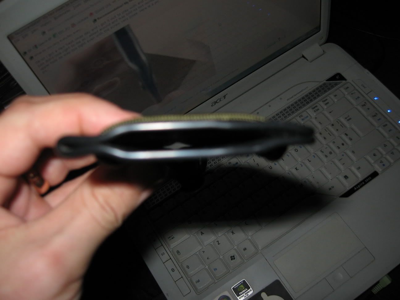

Ok so i got a new hest xmas day and i got it out to play with and it just fell out of the sheath and almost stuck in my foot lol. I looked at the sheath and it just didnt look right to me so i asked around and was told its not normal. I cant use the lower hole with the screw because it wont get tight but if i use the upper hole its way too tight even with the screw very loose. Here is a pic. Im not sure what to do. Send it back just for a sheath or idk.. Ps junk phone pic.

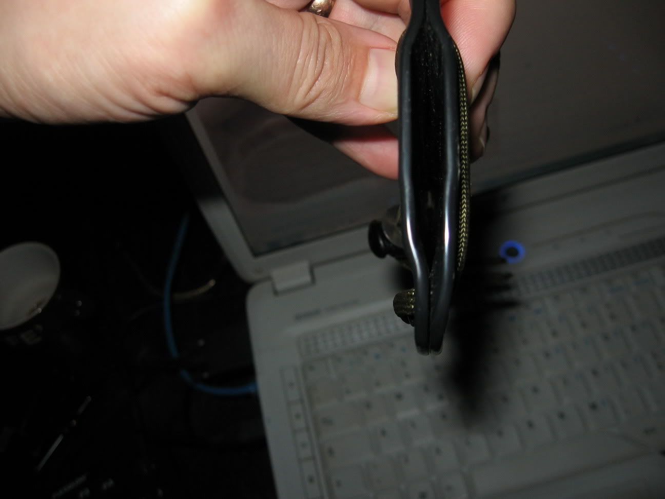

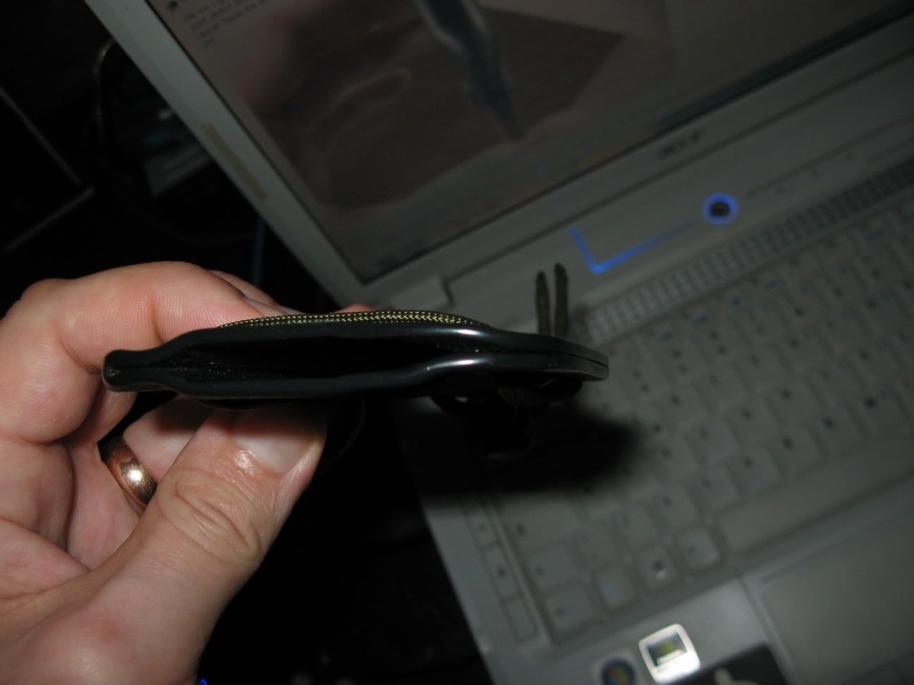

my HEST sheath also doesn't feel very tight with the screw in the default position, and the same, if i move the screw up, the retention is way to good
anyway, I can live with this, and as I've read in a similar thread, a rubber washer can be put between the sheath and the screw, at the first hole, to adjust the high retention

I agree jacktrades. I'm thinking all that's wrong is it needs the screw in the top hole without be tightened down too hard.
I got your HEST knife back. I agree, the sheath was loose, but all it needed was the one top sheath screw moved to the top hole of the sheath (the screw located on the "edge" side of the sheath). You must have been trying to move both top sheath screws, thus making it way too tight. I am going to be sending your knife back tomorrow via USPS Priority.
