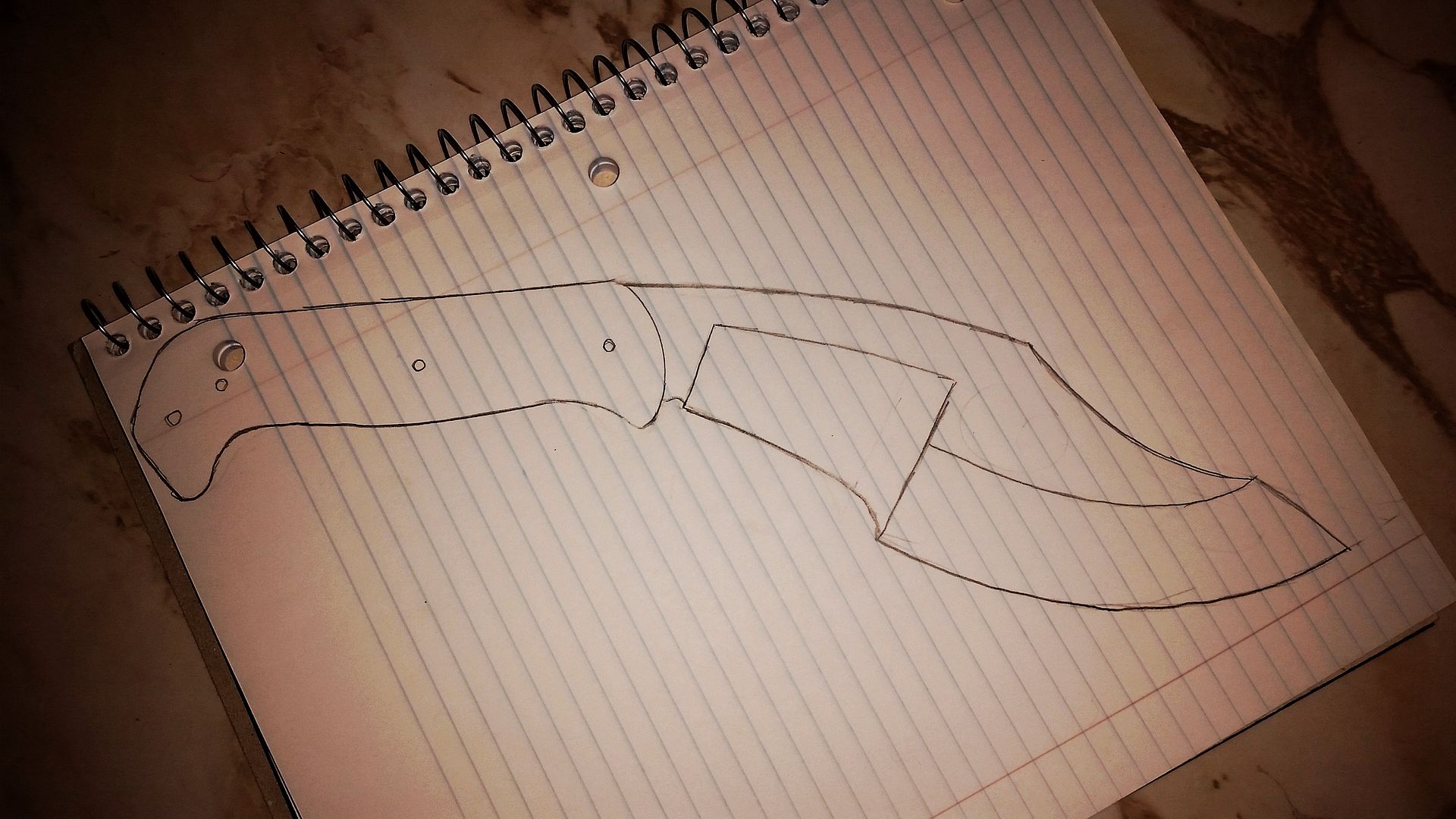

My idea for a Becker handled tracker-
I love my Beckers, I love foremost the handle shape. It really doesnt get any better. I also love the WSK, or tracker style knife. But I dont like the way the typical WSK/tracker knife is designed. I dont find that they work particularly well at chopping, and I want that in a one knife to rule all option.
So this is my idea. I modified the inner grip of the becker handle to allow my gloved hand just a bit more room. I canted the chopping section to allow more chopping power. I also like the batonning area on the Habilis Bushtool so I incorporated that as well. Im excited to get started on it but not sure where to get a slab of 1084/1095/5160 that size. I want it to be 3/16-1/4 of an inch thick.

It looks pretty good. I sat down, and designed my own version of the WSK. It doesn't even look like a tracker anymore. Todd Hunt will be making mine in the next few weeks. He's taking care of finding the steel. I know it has to be made to order, because it's an unorthodox design.
I think that design really only shines properly, out at the larger blade sizes. I do kinda like what you have there though. Think what that would b elike with say 10 inches of overall blade length.

Aldo at NJ Steel Baron will have it-I'd go for 1084 since 1095 can be a fussier to ht-your local sprin place would probably hook you up with a 5/16ish end cut of 5160. If you have basic forging access it'd be easy to forge the curve into a piece about the right width.

Thats a cool knife, but it still looks like it has very little sweet spot for chopping. Thats where I am trying to make this one shine, Only a 7 inch blade length but I think it will chop very well.

Yeah I bet it would be a monster at that length. Buuuut I want it more compact so I am trying to pack a punch in a shorter length.
More punch in a shorter blade=go wider in the chopping section and grind a full convex, spine to edge-it adds weight and momentum without adding thickness, and a wide convex ground blade bites deep.
Might require either forging or a wider piece of stock.
So do you mean taller blade from edge to spine in the chopping area? I went 2.5 inches tall where I think the sweet spot for chopping is going to be.

Yes, that's what I meant. It adds weight and decreases the cross section a bit.
Honestly, what you've done is a really good improvement on the Tracker's chopping ability. That's something I know an awful lot about. I say go with what you have. I think if you added more height to the chopping belly you will lose the profile you're going for. I can see it going too much towards a habilus bushtool. Also, the grind you have drawn for the working blade ( in front of the hilt) would be awesome as an original hollow grind if you go with 1/4" stock. If you go 3/16" I would use a flat grind. Just a thought. I'm digging what you've got here.
