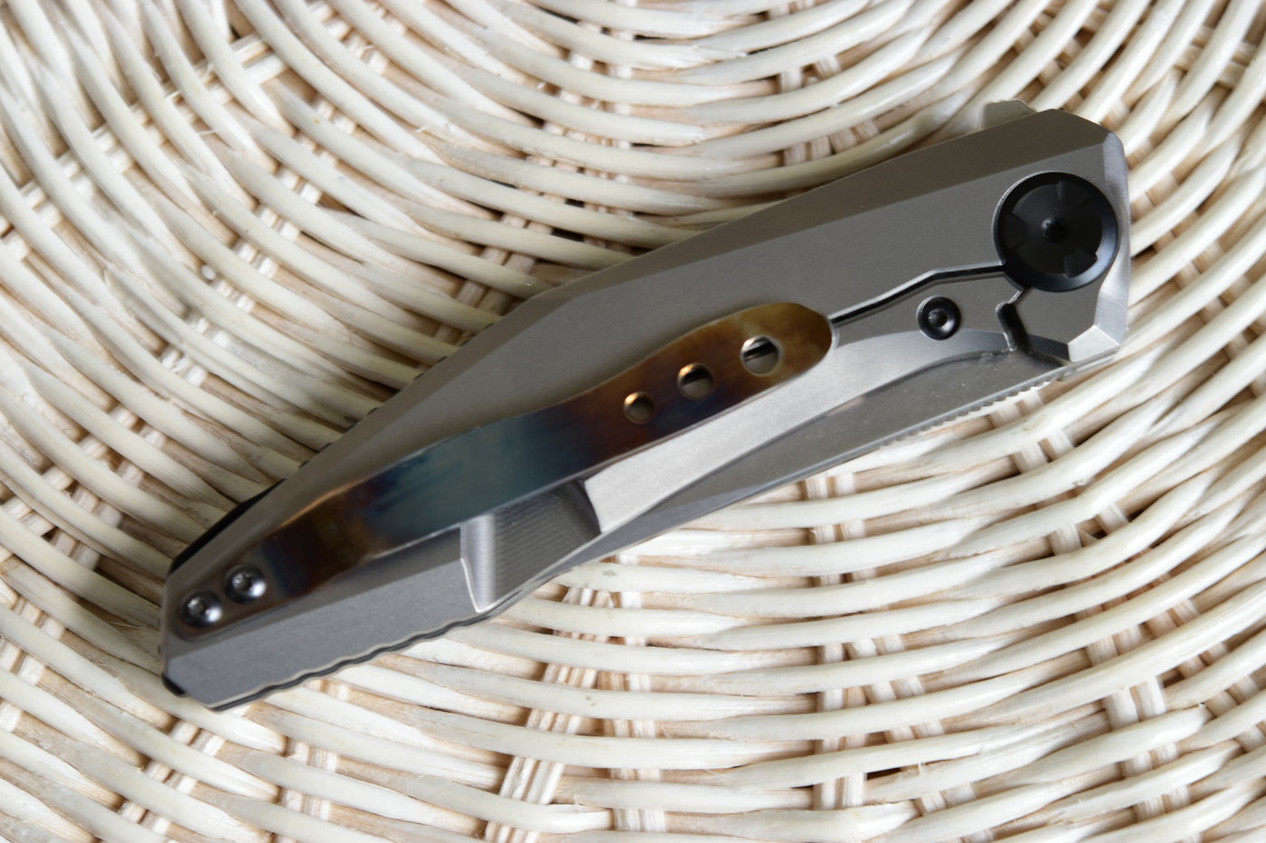

I have found with frame locks that when I grab the knife to open, after removing from my pocket, that my finger falls on the frame lock. This extra pressure makes it very diffucult to flip open. I have to make sure that I am not touching the frame lock and due to a large hand makes it uncomfortable. If the mfg. would make the clip rest 1/2 on the frame and the other 1/2 over the lock any pressure applied to the clip does not put pressure on the frame lock.
What I usually have to do is make my own clip that sits only 1/2 on the frame. I hope this photo explains it better. Do many others run into this issue?

I have found this to be especially so with my ZT0470 in the picture. Had to make the clip longer then the one that came on the knife.
