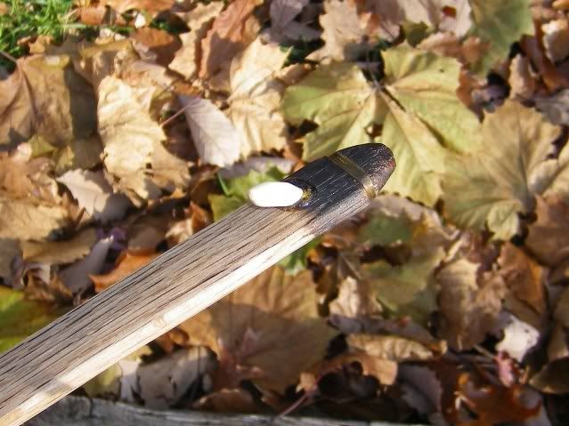

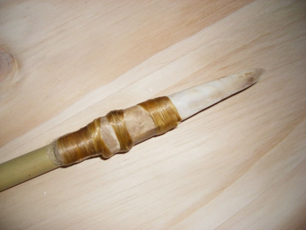

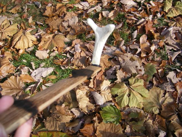

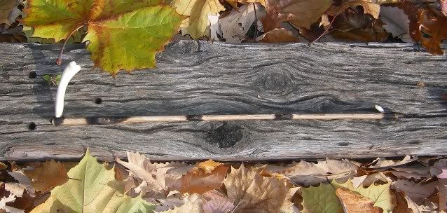

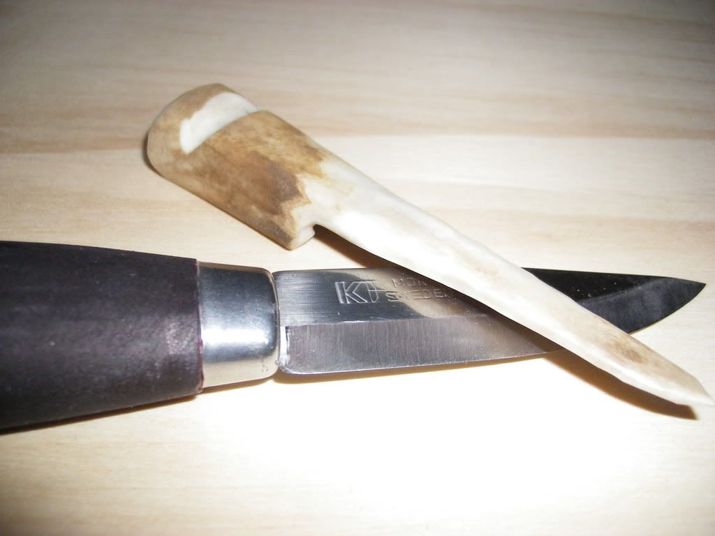

Here is an Atlatl that I finished today. It has a red oak spine and the rest and pin are antler.
Here is the first throw with the new Atlatl. The dart is a 6 foot ash shaft with bleached turkey fletching tied with artificial sinew.
[youtube]mrJrHl-Ag5s[/youtube]
Overall, I'm happy with this one. I will make the next one about 1/8in thinner but with a triangle cross section for a little more flex.
