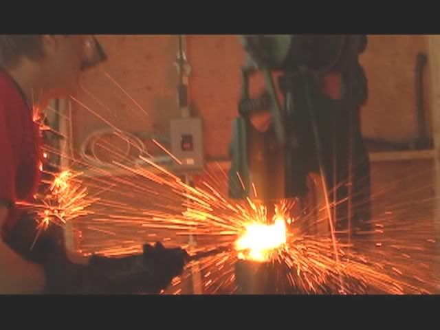

I start with a stack of steel.

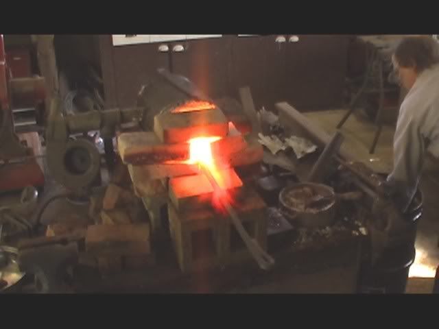

I heat the stack, flux it then put it back in the forge.
When the steel is at welding temperature I quickly pull it out of the forge and weld the stack together.
This is the welded bar before I drew it out cut it into 4 pieces, ground the scale off then restacked it.
