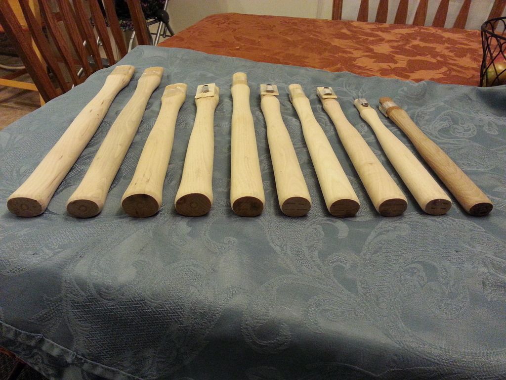

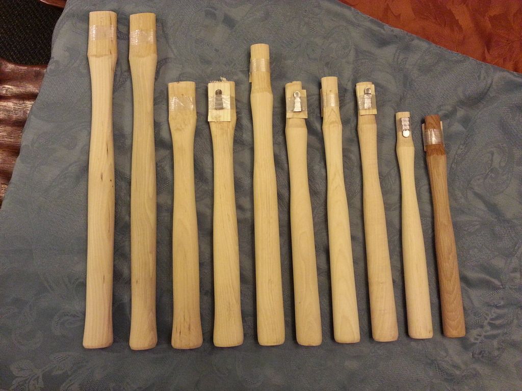

I ordered 10 various hatchet and hammer handles (blacksmith and machinist) in different sizes. The order totaled $48 including varnish removal and shipping. I opted not to ask for hand selection as I didn't want to add $2 to handles that ranged from $2-3.25 each. In a couple cases I ordered two of the same handle but one AA and one B grade to see what the quality difference would be. This is what arrived.

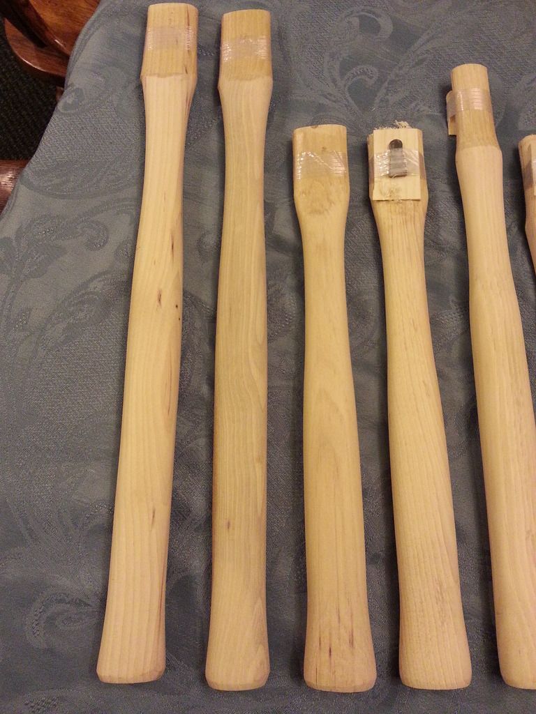

As has been my past experience, all of the hammer handles that I have ordered from them have been very nice and well formed. I have had issues with axe handles but never these shorter straight ones. The two pair on the left are the duplicates, and in each pair the one on the left is the "B" handle. Also the right most handle is for an 8oz ballpein head. I ordered the "B" handle for this and it looks great. I think it may be oak or pure hickory heartwood but for a small light head this should be no problem at all. I think that they are much better than expected and more than serviceable. If anyone was wondering, this is what I found. If I were hanging a working axe on a 28-36" curved handle, I would ask for hand selection and get the AA handle, but for straight 12-18" handles I think that these are absolutely fine options.
