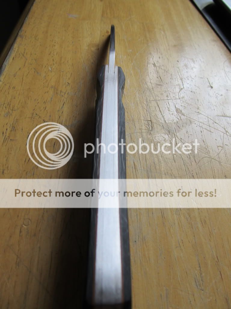

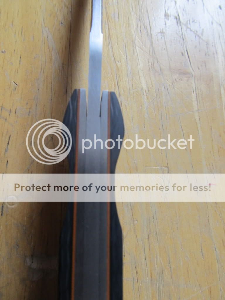

this is the most recent in a series of slipjoints ive been making. im trying to bring a modern twist on slipjoints.
8 5/8 inch OAL
3.5 inch cpm154 blade hrc 60
.060ti liners mill relieved
carbon fiber scales with orange g10 liners
New pics. i have redone some things and am still tweaking the whole. but its looking better allready.

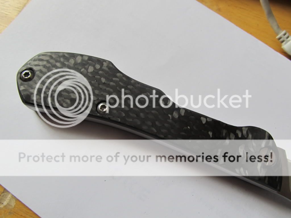

You asked for it, remember that, please.
ANY "decent" slipjoint is defined by superlative fit and finish.
On this particular piece, the fit and finish are lacking.

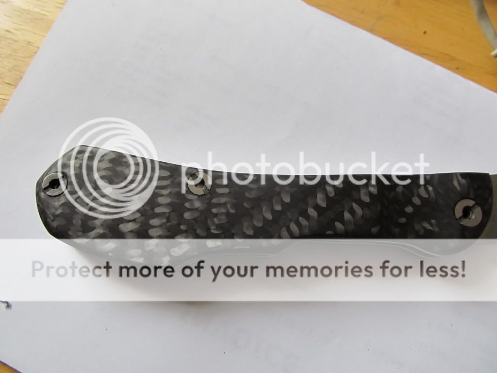

1. As far as I can tell from the pics, the rear screw sits proud, and the middle screw sits far too deep, and the pivot is really unattractive, and finished roughly. I use Brownell's VERY expensive screw slot-cutting files and they are completely worth the price, imo. Using a Dremel cutter is not the way to go.
2. That belt satin finish is uneven and far too coarse.

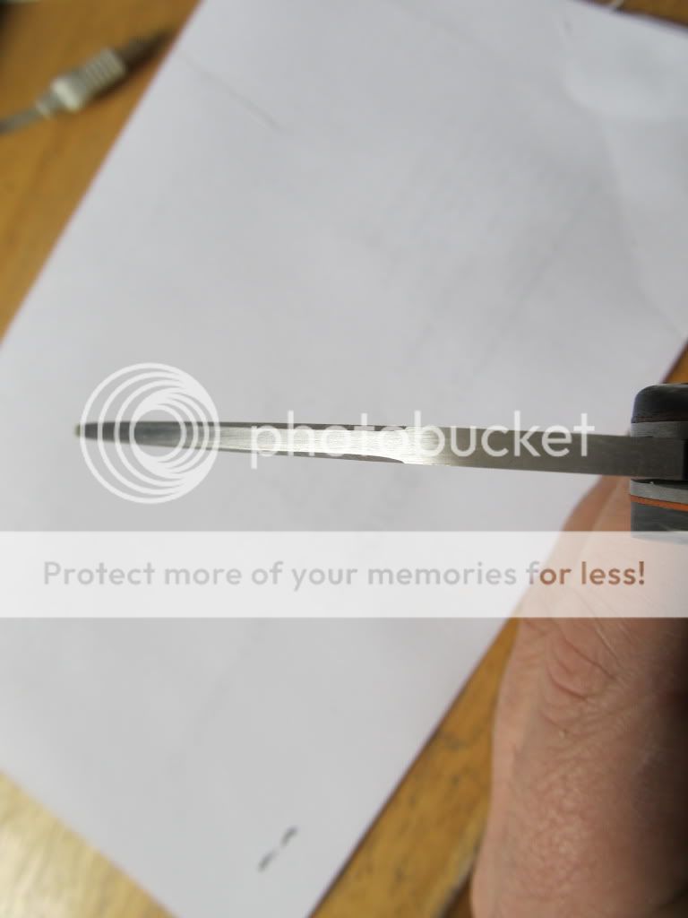

3. The secondary bevel on your blade is uneven....yes I do know how hard that is to do, BTW, and I wouldn't put my name on a wharncliffe blade that wasn't "right".
4. The fit on your last picture by the joint of spine to blade is slightly "gappy" and also finished far too roughly.
On the Plus side, the shape is interesting, and you have got good centering from side-to-side as far as I can tell.

i appreciete it much. its only my 3rd slipjoint ever. the slot in the pivot is factory, its a chainring bolt i didnt make any of the cuts. the rear screw is proud because of a design flaw. i tapered the scales twords the back. it seems i couldnt have the handle profile i wanted and keep the recessed screws. and i think i will sand the contour again on your suggestion, to get it to a more polished sheen. the spring is flush and gapless however. i attibute the look to the pics.
one thing i will say about the definition of a "decent" slipjoint. i have owned several 400-500$ slipjoints by sought after makers and none of them had the tightness , lack of blade play, and solid lockup of this knife. but there finish and sheen was definitely keener than mine.

Peter,I know you are proud as a new papa and it's hard when some one says "OMG that's the ugliest kid I've ever seen":D Iknow because last weekend Gayle Bradley went over one of mine,and by the time he was through I was ready to throw it in the trash.but he told me how to fix those problems and also the amount of improvement I had made in the last year.
So have a thick skin and let it make you better,you are off to a good start for #3.
I like your style and design and use of modern components,but agree with STeven,fit and finish needs work,The swedges are uneven and not centered,your secondary bevel is uneven,and the plunge cuts are ground over.
I don't care for the rough belt finish on the blade and back,looks unfinished.I also use some chainring bolts,but take the time to file out the slits and heads to remove all the little machine marks.

on a more pertinent note, i reground the blade and fixed the secondary bevel. its now straight and true. i took the contour to 220 grit the original 120 was a bit rough. i sanded down the hardware to 600 grit to remove the factory lines. and i reprofiled the handles to get the hardware at roughly the same depths throughout the knife. and stan, i reground the swedge to be symetrical. ill post pics in the morning.

That is much improved.Looks like your back spring is thicker than your blade causing the gap and that junction.Measure both and see if you need to thin the spring some.
Also on the next one when you mill relive the liners don't come all the way off on the nose.Leave about .070 there. It will help close up alot of that gap.
