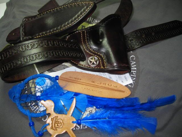

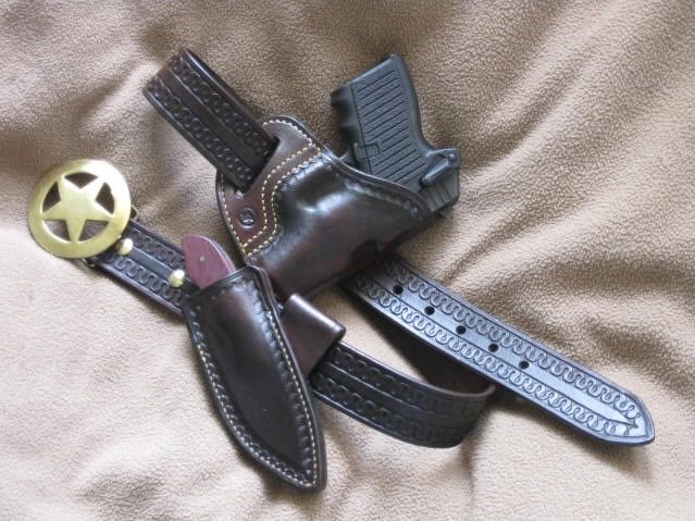

Here's something I made for myself...I'm entering it in a leather craft show this week-end.....
looks very nice,it has a very classy look to it.it should do well this weekend.good luck.
Nice work. I particularly like the holster. Don't know how you managed to get that stamping line around the trigger guard so perfect.
It may be the long way.....but that's how I do it....I wet mold the leather to the gun...and when it's dry enough I scribe the stitch lines around the guard and everywhere else I'll be stitching.....then wet again and lay the holster out flat to stamp......wet it again just enough to fold in half...let dry, then glue and stitch.....then wet it again, to insert gun which is wrapped in plastic baggie...set it out to dry...away from the dog.
