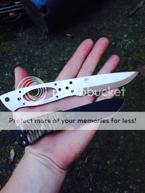

Well, my lust for pointy metal things finally got the best of me (again) and I decided to buy an Enzo Trapper blade. I know this blade is fairly popular among the woodsy peeps out there and figured for the price, and the size, why not? I bought it from Thompson's blades for about 57 bucks. It arrived super quick and sharp! I'm not very schooled in the metallurgical arts, so I can't really justify my choice in steel (12c27) other than they were out of D2 and other forum members had commented that 12c27 seemed to be a good steel. It is a full scandi grind. I have some liners (red g10, of course) gluing to some brown canvas micarta slabs right now but here are the initial pictures of the blade. I have it next to my BK11 for scale... And to show where my loyalties lie. I'll post more as the build progresses! As always, thanks for the community atmosphere here on BF!:)

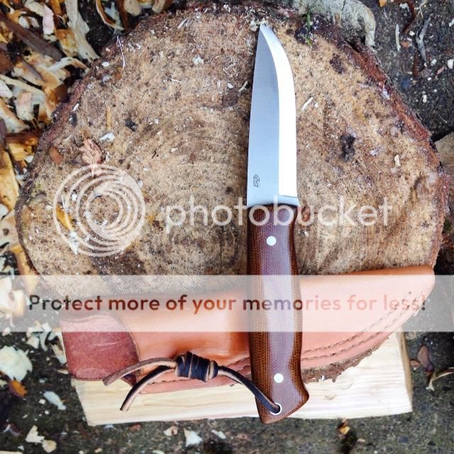

OK everyone, the time has come for the reveal! I present you: Ruby
Sanded brown canvas micarta to 400. Then wet sanded (with oil) to 700 and then buffed with a rag. I did the sheath as well, which is natural-colored calf skin (un-dyed) with a coating of neatsfoot and some Huberd's.

I can't tell you how impressed I have been with the quality of this blade! The grind is flawless, the finish is beautiful, and the spine is square. For the 50-odd bucks I paid for it, I'm blown away. Thanks for looking and, as always, comments and pointers are appreciated!
looks great, well done. the only thing id do is dye the leather to match the micarta
That looks very good. Could you show the sheath from behind? I want to see how you made the belt loop.
I am a trapper junky ( have 6 of them !). What you have made sir is absolutely beautiful !!!!!!
Thank you so much zman9mm! I really appreciate that! And sogflash: I will take some pics today and post them. If you want, I can email you a pdf of the pattern I made so you can make your own- no reason to reinvent the wheel here! And that goes for anyone that wants the pattern- it's up for grabs!
