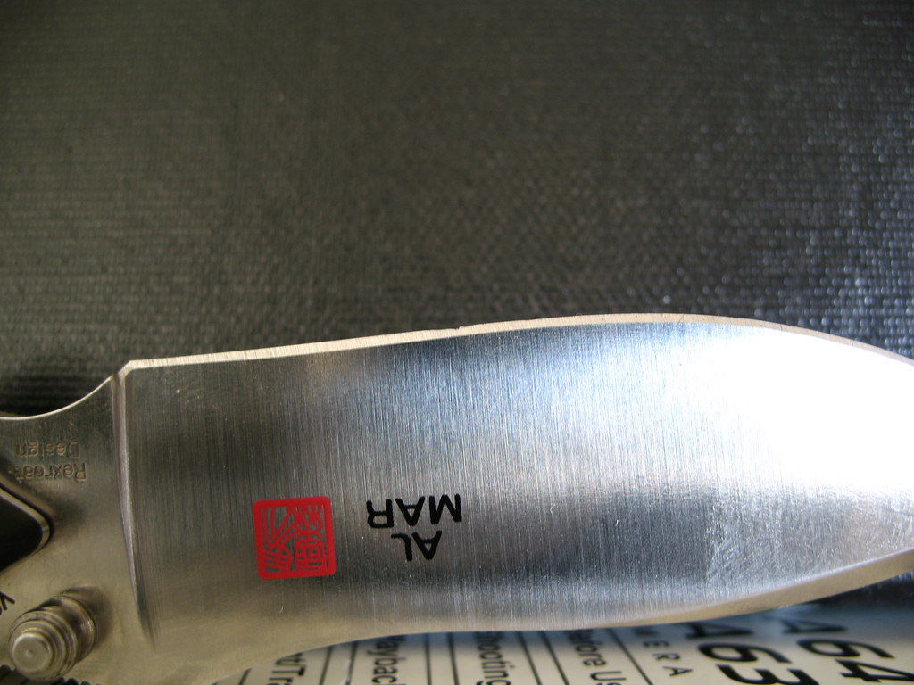

I just bought a brand new Al Mar Nomad folder. I love the knife, but yesterday when I decided to test its sharpness by cutting through a newspaper sports section (about 10-15 pages of newspaper), I there was a very noticeable nick in the blade afterwards, which is big enough to catch my fingernail as I run it along the blade. I was surprised that some newspaper could do this to a quality blade in VG-10 steel and was wondering if I should exchange or return the knife (I'm new to knives so don't know if this sort of thing is normal). Even though it arrived very sharp (took off my arm hairs like they weren't even attached to my arm), I'd expect the edge to be able to handle a stack of paper without any visible damage, especially after the first 2-3 cuts. I'm planning on using this knife to cut a lot of cardboard and carpet, so I'm wondering whether it'll hold up.
It would be difficult to get the nick to show up in a photo, but it's easy to see under a light with the naked eye, and it seems to me like if I tried to fix it by re-sharpening I would have to change the shape of the blade (if I wanted to keep the same bevel angle and degree of sharpness). If I was always having to repair nicks it seems like the blade would deteriorate pretty fast. But again, I'm a newby so maybe I'm overreacting to something totally normal.
So should I return the knife? Is it normal for a job like cutting through a section of newspaper to cause nicks? Would another type of steel, say S30V, have better edge retention than the VG-10? Thanks for any advice!

Another possibility: Most new knives are sharpened on powered belts. Even after power stropping or polishing there can remain small almost invisible micro chips and cracks on a blade edge that were created as a result of the grinding and sharpening process. It has been my albeit limited experience that these sharpening imperfections will show up very soon after a new knife's first few uses. Cardboard and to a lesser extent paper (particularly RECYCLED paper products) have a high level of foreign material within their structure which can be quite abrasive. The fibrous structure of the material being cut can grab onto the edge of a micro chip or tiny crack and absent the full supporting structure of surrounding steel, rip out a small section of the cutting edge. It is annoying and frustrating. The solution is a careful resharpening below the depth of the chip or at least polishing the chip edges to prevent cut material from getting a grip. It is possible the steel's integrity at the very cutting edge has been compromised by friction generated heat or mechanical stresses during machine sharpening. Hand sharpening will expose the hardened steel below as it then becomes the new edge and solve this condition. Just one old dude's suggestion. OldDude1
Thanks for all the helpful replies. I've been reading up on sharpening and am planning on buying a system (either Sharpmaker or Edgepro) soon. I read about burrs and wire edges and thought this might have been my problem, but I wasn't able to detect one by the methods suggested in what I was reading (running finger along edge, etc.). Also, the nick seemed maybe a bit too big to be caused by that. Anyway, it took some work figuring out how to use the manual focus on my camera, but I was able to get some decent images of the nick on the blade. They could be a bit sharper, but here goes:
The nick is visible, just over 1/3 of the way up the blade. Does that look acceptable, or like something that could be caused by a wire edge? If so I'll just keep the knife and wait until I get my sharpener. Otherwise I'll return (or rather exchange for another Nomad). Still have a few days to decide.

Now that I got the pictures up, maybe I could get some more concrete feedback about the nick. My main worry is that it might be big enough that it would require me to slightly bu noticeably change the shape and profile of the blade if I fix it by sharpening. I really like the breadth of this blade, so I wouldn't want it to become noticeably narrower when I fix the edge. So please take a look at the pics I (belatedly) uploaded, and let me know if you think I'd have to take too much off the edge to fix this nick by sharpening.

Greetings jblane: That chip is not, in and of itself, a reason for a complete edge reprofile. It may however be indicative of the integrity of other sections of the factory edge. A quick fix would be to "round out" and polish the chip's entire surface using the edges of a fine or ultra-fine hone ceramic Sharpmaker rod. Using 1500 grit or higher wet/dry sand paper wrapped around a suitably sized nail, bent paper clip or ball point pen refill will also work. This will remove the jagged edges of the chip and make it unlikely to snag or stress and break further. Unfortunately, besides making it smoother, it will also likely make it larger. If the edge was "weak" in that one area it may also be weak in other locations along the factory applied edge. This usually causes me to worry and wait for the next chip to appear. Resharpening the edge, as opposed to reprofiling the edge grind is not a laborious process. This also removes the concern of making the chipped area larger. Resharpening the ENTIRE cutting edge is the way I would go in this situation. It only requires removing steel a small fraction of a millimeter deep along the very edge. It is of course your knife and your decision. OldDude1
For myself this wouldn't be a big deal and I would sharpen it out and use it. You could completely take the nick out or you could just touch it up and it will slowly go away over the next few sharpenings.
But seeing as you are new to knives and don't have any sharpening equipment then you might want to send it back if it bothers you. But there is nothing to say the next one won't be similar. However, if you plan on getting more knives and want to have sharp knives then getting some type of sharpening equipment is a good idea and you can take care of it yourself.
Will the store take it back? Will you have to pay shipping both ways or just one? It's up to you if spending the money to send it back is worth it although that is not a terrible chip and you will probably have to fix similar edge damage eventually.
Like others have said that's not a chip, cutting paper will also not cause that not even is the blade was made of aluminum. My guess is that the edge came into contact with something and you did not notice, you would be surprised how much this happens.
Don't worry about changing the factory bevel its something you should do anyways. Factory bevels are made quick, fast, and in a hurry, you would be very lucky if they were the same angle per side or even the same angle on one side. Resharpen and enjoy the knife.
