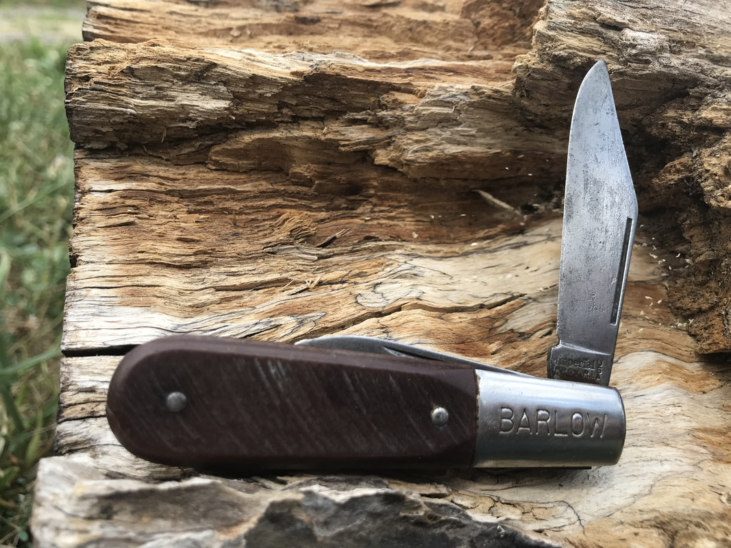

New to me. I couldn’t resist so I bid on and won this Barlow at a reasonable price.
I am thinking on what to do with it. It’s got decent snap and no wobble. A crack in the show side panel. And that one panel is a touch loose, but overall I think it’s a pretty clean example. It does have some pitting and has been polished sometime way back I’d guess.
I’m thinking I’ll clean it up and play with it while I ponder. I’m thinking rehandle it and convert it to pinned construction. Probably make brass liners for it. I’m thinking why not learn to silver solder and make bolsters too? But I do have a couple antlers from a buck I killed. Might do fine with sodbuster style panels. I bought it expecting to have some fun. Whoohooo.
I have read a bunch of old threads on them and see it’s a 56-88 year range from the vertical USA in the tang stamp.
For now I’ll just clean it best I can without disassembly and play with it while I ponder.
Just thought I’d share.
The show side cover is easy to tighten up ---> If you have a flat micro screwdriver.
If you look, the covers (including bolster) is held on by a folded over tab at each end. You can tighten the cover by flattening the tab(s) back down so they are tight. 😁👍
I had to tighten a cover on mine, too.

Thanks. I know, I seen several videos and pics where people were modding them. That’s where I got the idea to mod it. But I ain’t tightened it up because it’ll make it harder to get apart when I do.
If the panel wasn’t cracked at the end I’d probably not do anything to it. Might not anyways. I’m starting to build a relationship.
