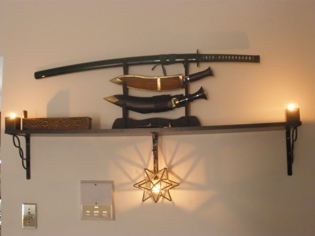

My new Khuk and his buddy
Sep 3, 2008
64
Well, I just opened up the package from Yangdu today, and she sent me the 16.5 inch 22 ounce true villager Knife by Vim Bhadur Kami with white metal fittings, Satisal handle and the wooden sheath that I ordered on the 3/19 DOTD. What really caught my eye was how the blade is coated with some sort of black material, I REALLY liked that. Included in the package was a small NEPAL pin and a postcard featuring Mt. Everest.
I took the blade out, cleaned it and started removing the SMALL amount of rust that was in a few spots on the blade. This design has a totally different construction than that of my 16.5in CAK, this one has less belly and is balanced totally differently. I personally think that the CAK feels and swings better in my hand, but this Villager feels great, especially with the Satisal handle, it feels strange when I am used to a horn handle.
These villagers are not built to last like the CAK is, but damn, this blade is going to last me for a good long while at least! It also is a work of art as well as function and deserves a place on the wall, right next to my other Khuk.

lol at cheap saya. I mean a functional blade doesn't need fancy fittings but still.
If that sword at the top was a real nihonto you probably would have sprung for better ones.
What type is it? What do you use it for?
Its a cheap sword that I got for $60 at a pawn shop, It has a handmade blade, its worth about $200 retail, its pretty well balanced..its not some sort of great blade, but I used it to practice martial arts and it worked pretty well as a good live blade to train with.
