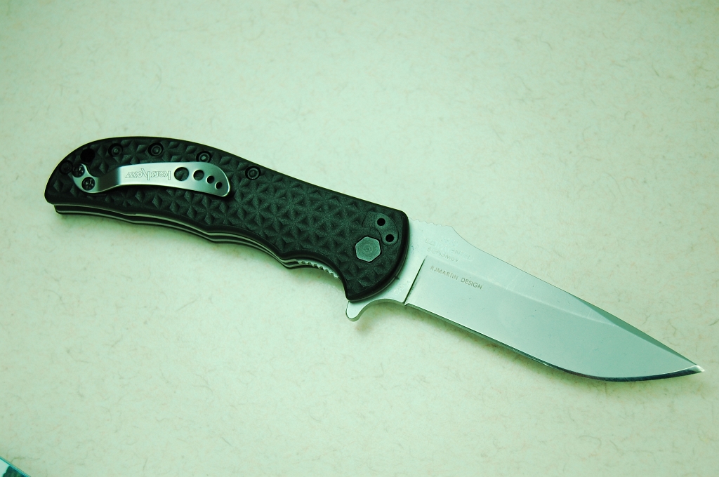

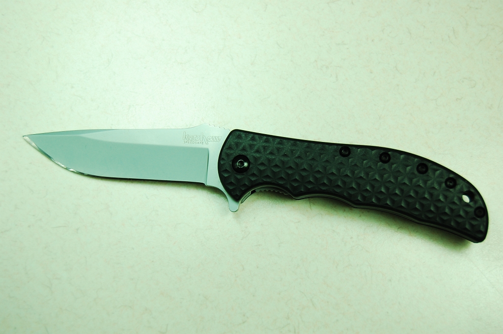

The first thing I noticed was that the blade was way off center. I couldn't see where it had rubbed against the liner, but I grabbed a very thin piece of paper and slid it between the blade and liner. It slid through, but I could tell it was a little tight.
Its not a crisis, but this one is a little closer than I like, and I don't want to adjust the pivot, because it opens and closes perfectly imho.
So, tomorrow I'm going to take it back and exchange it for another one. I'm sure they don't all have this issue...
Anyway, I really like this knife. As I mentioned, the handle couldn't fit my hands any better if I had someone make it for me. It opens quickly, the blade has zero movement in any direction, when opened, and the lockup is at about 50%. The scale texturing has enough grip to be able to get a good hold on the knife, but not so aggressive that it will be hard on pockets, like other knives I have had. The pocket clip is tight, but not to tight. No need to do any tweaking on this one.
I paid a little more for it buying it at a brick and mortar store , but thats to be expected. Still, for $26.00, this knife is a bargain in my eyes.
So, heres a few pictures I took of it today.
Mine was exactly like your knife. I fixed it by loosening the pivot and handle screws, holding the blade centered while I tightened the pivot and then tightened the handle screws. It is now centered.

Ya, I know it would probably fix it, but I'm going to go back to the store, and look at some other first. If the others are similar, I'll loosen it up and try to get it a little further from the liner.
Granted it is not an expensive knife, but I have a few others that are in the same price range, and they don't have this issue.
Its not a deal breaker, or a dig at Kershaw, just an observation. As I mentioned, I really like the knife.

Yes, this works 9/10 times. Mike, I suspect that you can realign the blade in a couple minutes with no problem. As Daniel stated, loosen everything up, maybe wedge a piece of paper in the side of the liner where the blade is leaning. Tighten the pivot all the way, remove the paper, proceed to tighten the handle screws. You can then back off the pivot a bit to restore the smooth action.

Thanks Rev. I've never had a knife that needed realignment, and this one is so smooth, I hated to give it a try. We have to go back to the store that I bought it, for some fishin supplies, so I'll check a few of the others while I'm there, and see if this one was just an oddball. If it is the norm for this model, I'll do a little tuning tonight when we get home. I'm having a hard time keeping my son away from this one though, so while we are there, I may pick one up for him too.

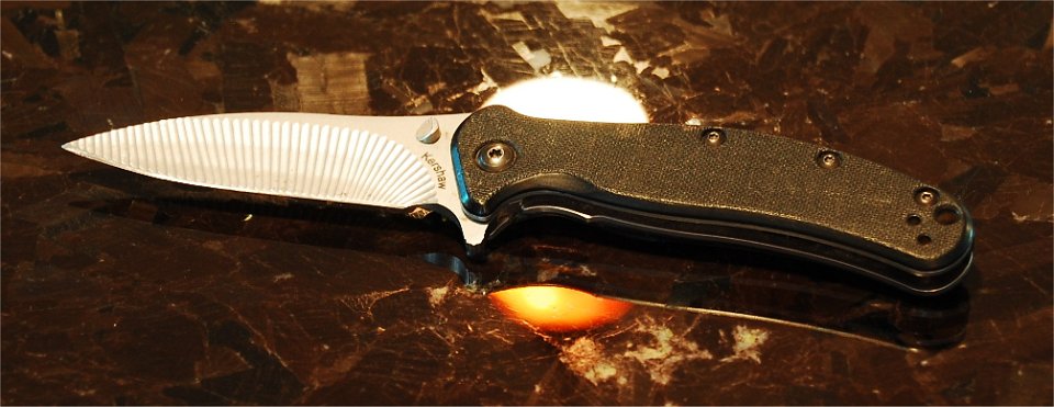

I gifted a Zing to a friend of mine a few years ago, and he occasionally brings it back by to have the edge touched up. Here is a pic of the well-used knife from yesterday -

Thanks for the pictures mqqn. I admit I'm not well versed in Kershaws, but I always thought the Zing was only made in orange.
