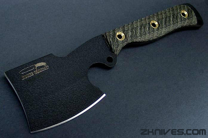

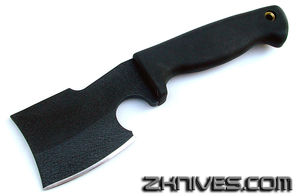

It bears a strong resemblance to the Busse Paul's Hatchet...
and the Swamp Rat Paul's Ratchet...
I own both and I like them, so expect yours is similarly a good design, and it looks like you made it well.
Yes it does bear a resemblance to those hatchets, with the exception being mine is an inch longer at the front and almost an inch longer handle too. Also mine has the chisel, is stainless steel, is bead blasted, has 3 bolts, not rivets holding the handle on, and although it can't be seen, this one has a skeletonized tang which helps put more weight up front. Also, the one pictured here is the last one I'm making with permanently attached handles. The newer models will have removable scales and a more streamlined handle.
