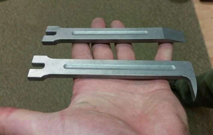

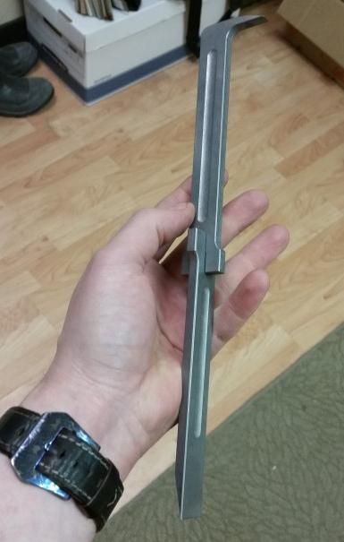

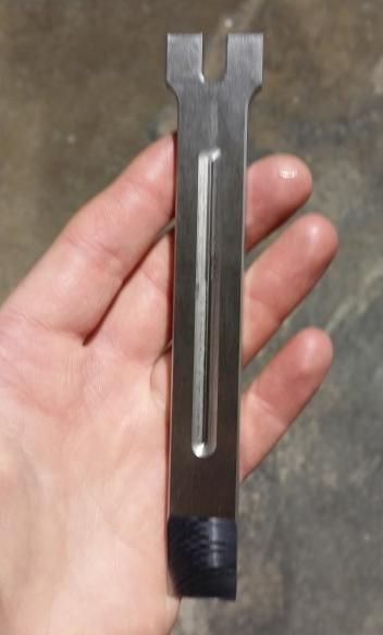

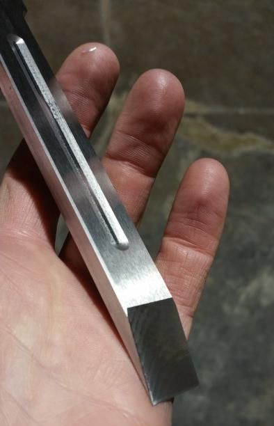

So here is the prototype of my latest tool and the object of my soon to launch Kickstarter project, the "Mega Pry"! This is a modular tool made of two tools that can be used independently but join together for bigger jobs. One has a normal pry tip and the other has a 90 degree offset tip which enhances leverage by four times (verified by independent structural engineer) and can be used in situations where working space is an issue. Both are 6" x 1/4" (handle sections are 3/4" wide) made of 440c stainless steel treated to HRc54. I chose this material and hardness to give the tools a balanced blend of strength, toughness and corrosion resistance.
The U shaped notch at one end of each tool is 1/2" deep so that when joined the tool is 11", nearly doubling its length. The CNC machined ball grooves reduce weight while simultaneously increasing the tool's structural strength. I designed this tool with active duty military and fire rescue professionals in mind however I am sure everyone will enjoy the power, convenience and versatility of this tool. I will take many more photos and some video once they come back from heat treat and before the project launches. Any questions or comments are welcome, let me know what you think and thanks for looking!
If your "independent structural engineer" told you this, you need a different structural engineer. :(
But the design overall is interesting and ingenious. I think more people would be interested if it was scaled down a bit for EDC and maybe even made of lighter material such as Ti. Right now it's a bit large for pocket carry.
I went to justanswer.com and paid $30 to talk to a structural engineer about this aspect of the tool. What leads you to believe that I shouldn't have spent my money?
Removing material cannot make the piece stronger only lighter or have a negligible effect on strength. But otherwise the coupling idea is great to give extra leverage while reducing overall length.
If you are talking about the ball groove, it does indeed make it stronger. Its similar to an I beam, the geometric shape is stronger than if no material was removed there, I love science! Yeah, I like the simple joint, no moving parts, quick connect/disconnect.
You may love science, but that is flat out wrong. Removing material from a solid bar always makes it weaker. An I-beam is a strong shape compared to other geometry with the same cross-sectional area, but that is not what you are saying.
Another way to think about this: you have slightly increased the strength-to-weight ratio of your tool by adding the grooves, but the solid bar, although heavier, is still stronger.

By removing the material you are changing the way stress is distributed on the bar in it's entirety. I think I understand your meaning of strength to weight ratio. But it still should be able to withstand more overall force. Maybe not necessarily to an amazing degree but every little bit is an improvement.

After milling it is NOT able to withstand more force. But weight reduction is bigger than strength reduction, so strength/weight ratio is better.
When it comes to tests - this tool has SO MUCH material and milling is so small, that it will be very hard to test difference in durability.

No. If this were the case, literally everything you see would have a groove cut into it; it uses less material and it is stronger! You can't get something for nothing.

I do have a degree in Mechanical Engineering. So probably do some of the others here who have tried to tell you the truth. We don't like to brag about it. A student learns this in the first or second year. You are misapplying a scientific concept, that is all.
