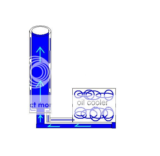

The oil cooler is good for multiple blade quenching. Use a thermostatic switch ( PID works great) to turn the pump on and off as needed to maintain temperature. In the average forge shop, an oil cooler isn't needed.

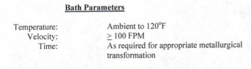

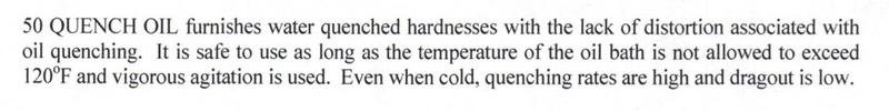

This is Parks 50. I let the agitator and chiller run during my entire quenching session, which is usually 10 to 50 items. "Stirring" wasn't cutting it. Note that Heatbath recommends an agitation speed of 100 feet per minute or more:

How about something like this? Two concentric cylinders, the cool oil is pumped in from the bottom and overflows into the outer cylinder to be cooled and pumped.
