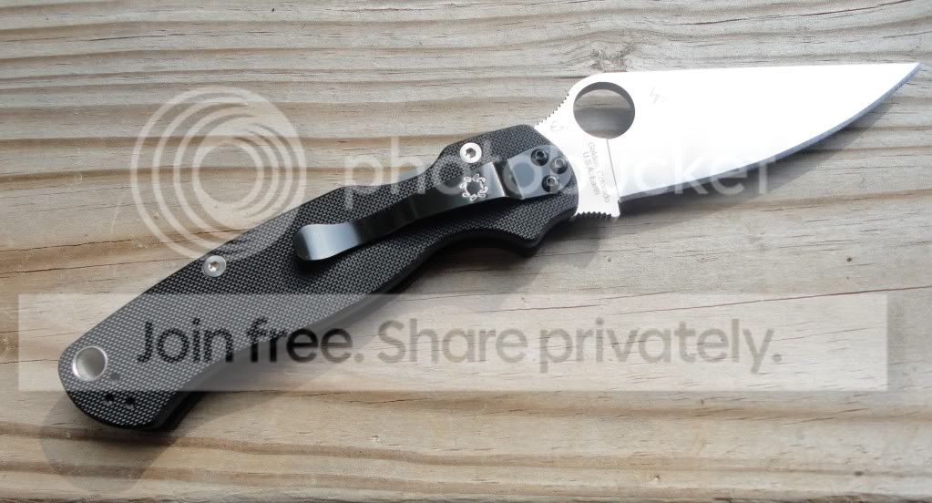

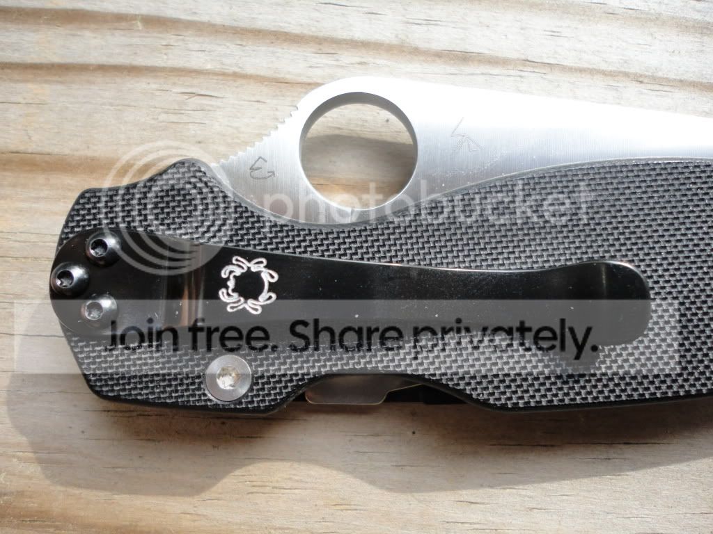

I didn't like the bright shiny clip that came on my Para 2 so I called Spyderco and ordered a black one. I was kinda bored this afternoon so I decided to color fill the Spyderco Logo. What do you think?
that looks really good!
but seriously, stop showing off your para 2s, its just not fair!
That clip looks cool, nice job. Years ago, I used to build car and jet models and I would use a Rapido liner for the small details. That might work for this kind of thing.
That looks real nice,what did you use to outline your spyder?
Testor's model car paint (flat aluminum). You paint all over and around the logo. After the paint is mostly dry, dip a piece of t-shirt material in paint thinner and ring it out,
then wrap the t-shirt around a credit card and rub it up and down the clip. Any paint that is in the recessed logo will stay and the
rest of the paint will come off.
