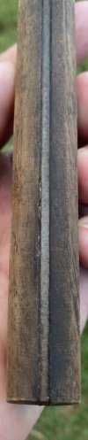

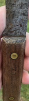

For fun, I thought I'd post up a bait and fillet knife I have been using on saltwater fish. It does not get any care at all, other than sharpening.
Used, washed in hot soapy water, hung wet on a magnetic strip.
It is made of a soft 1095 and has inexpensive cutlery rivets holding on unfinished wood scales. I suspect the scales will fall of way before the knife corrodes into oblivion.
