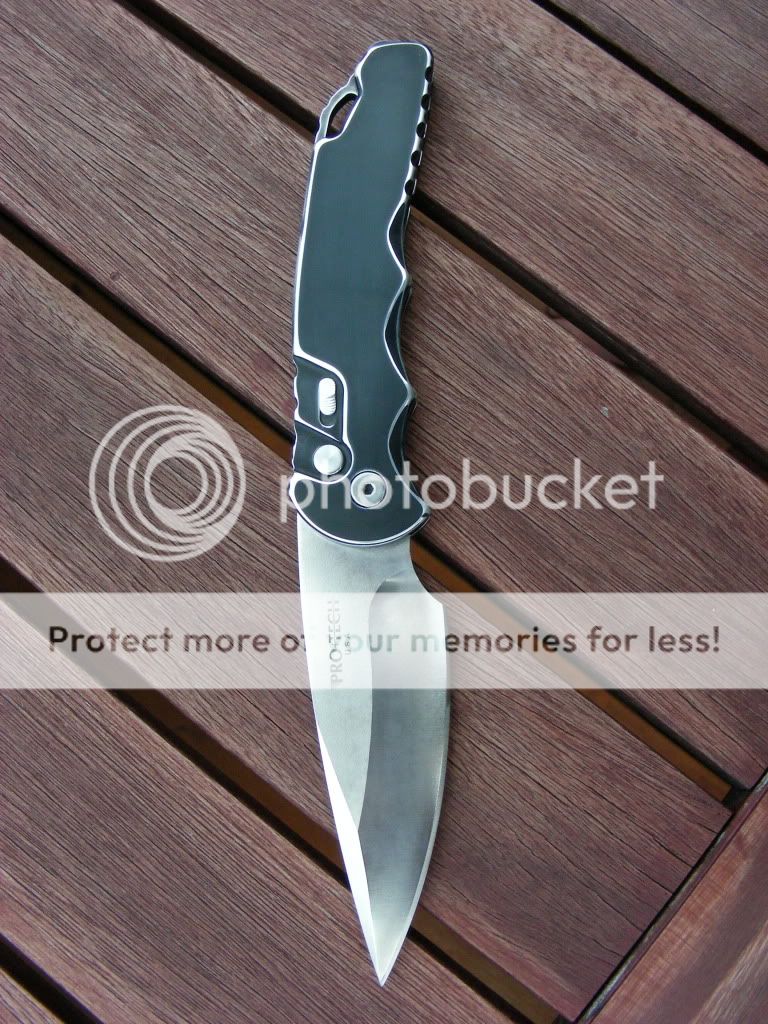

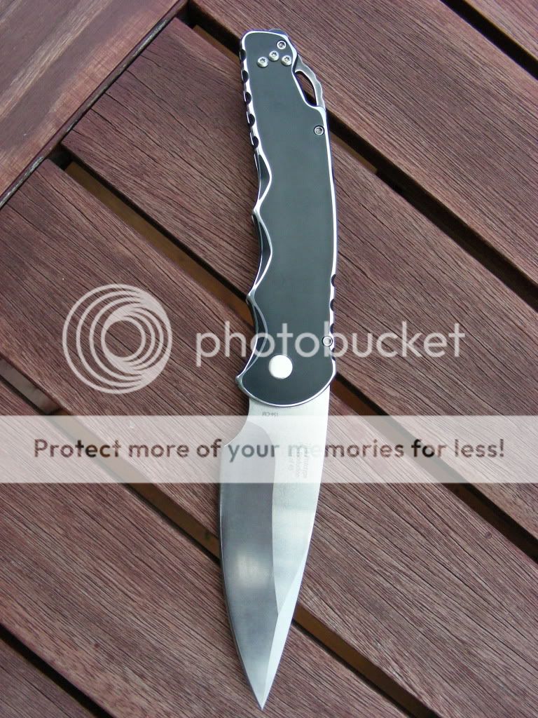

So this is where I took things into my own hands. After a couple of beers (!), I decide to get some fine sand paper (320 and 600 grit), my Dremel with a cotton wheel and polishing compound, and I start taking the knife apart. First thing, I dismantle the safety and sand down the the safety button. I suspect a lot of people are going to do this – that little button is uncomfortably rough. The result is now perfect- I can still feel the ridges but they no longer catch on my thumb tip. This button is very soft aluminum so it takes very little work to smooth down. But dismantle it to get better access.
Then I go to work on the stainless steel insert. I round the edges (especially around the glass breaker) and smooth out the ridges on its back. On my proto, this part was finished black like the production knives, not like the Blade Show prototypes on which the part is bead blasted. Of course after sanding and some polishing, it is no longer black. But I definitely prefer it now. So I also did the black pocket clip, not because it was rough, but just so it would match the stainless steel insert. Again, a nice result.
Encouraged by these results, I attack the handles themselves. This is a point of no return and a tough thing to do on a potentially collectible knife since whatever you do will remove the anodizing and leave ugly bare spots. But the sharp edges around the trigger were really bugging me, like a little piece of skin hanging from the roof of your mouth after burning it on hot pizza. So to hell with it. I start with the edges around the button. Next thing I know, I've softened all the edges all the way around the handles. Now the handles are really nice to grip, but I've removed a lot of anodizing. At this point I'm thinking that I can just get the handles re-anodized locally (although I have yet to figure out how to remove the steel pivot and stop pin that are heat-pressed into the handles before re-anodizing).
So having taken care of the edges, I now turn my attention to the gritty surface. I start to wet-sand the entire surface of the handles thinking that I'll remove the anodizing like I did on the edges. I'm glad I started this way rather than with oven cleaner to eat the anodizing off because it turns out that the handles can be made really smooth without removing much of the anodizing and without baring the metal at all. The result after using the 320 grit is really nice and smooth and glossy with no scratches. I went to 600 and then to cotton polishing afterwards, but this added very little and is not really necessary. The color is now a glossy dark grey instead of black.
I reassembled everything, disabling the safety in the process. It is now locked in the open position. I didn't like the notchy action and I firmly believe that the way ProTech recesses or flush-mounts their triggers is sufficiently safe, not requiring a secondary safety. Opinions will differ, of course. I also left off the pocket clip since I will use the supplied ballistic nylon pouch instead. The knife is just too heavy to pocket. The pouch is a perfect fit and of good quality.

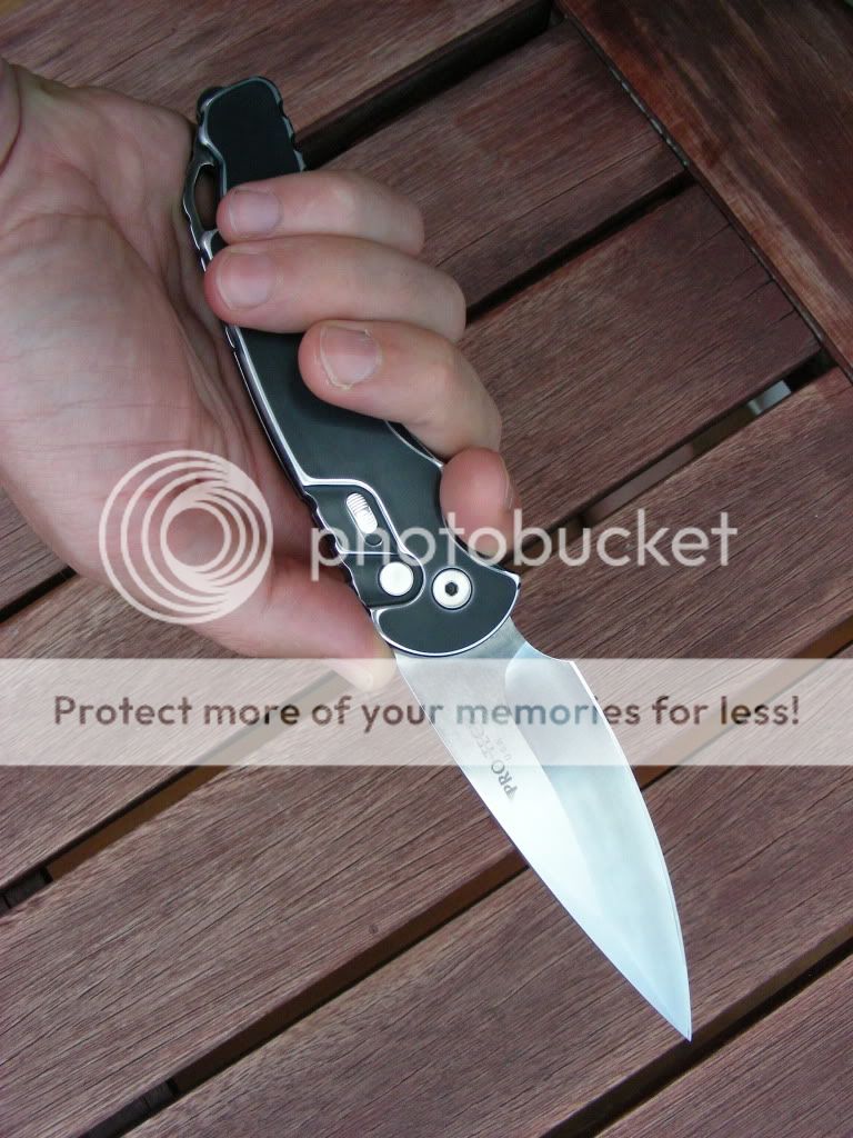

Finished product: a fondle-me super-smooth knife with a shiny bare aluminum outline that actually looks surprisingly good. In fact, I've abandoned my plans to re-anodize the handles (although an OD green finish would be awesome). You guys tell me what you think of the look. It may no longer be collectible, but it now feels great and I won't have any thoughts about babying it.

Well , realistically how much of a collectors item would it have ever been ?
I had a few first production runs that I was hesitant to mod , or clean to my liking , after some encouragement here on BF I went and did it and now I love the knives even more :D
All that said ,I think it looks great. You made the knife your own , your very own custom Protech that you personalized , now the knife is a part of you.
