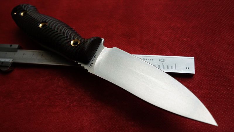

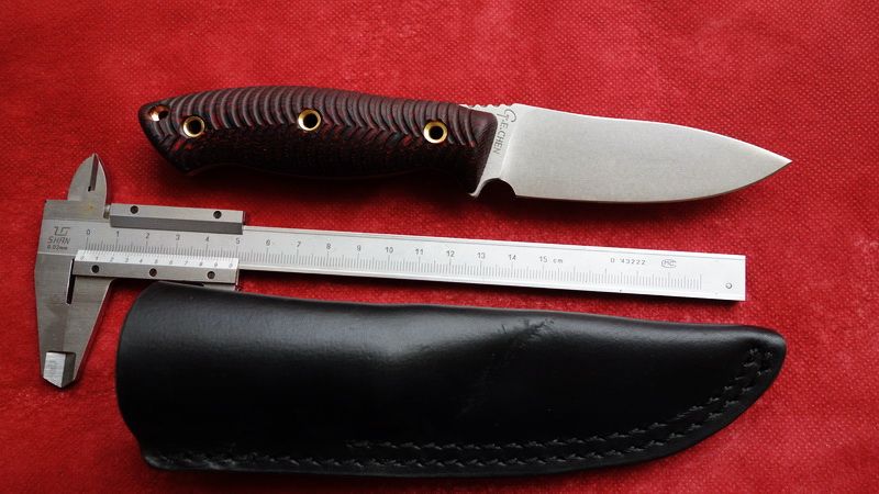

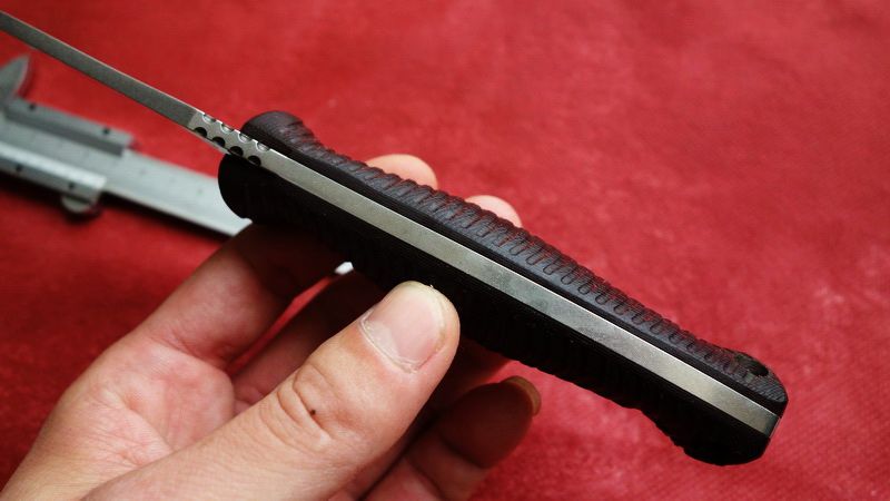

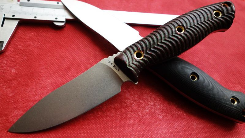

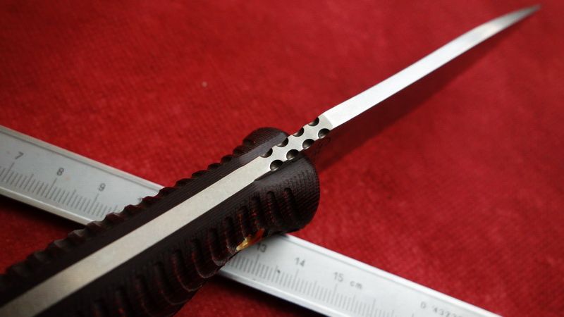

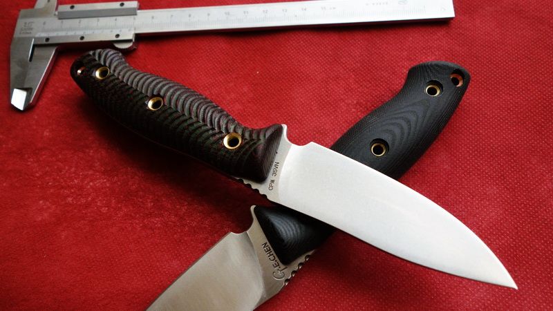

Hello friends,This is Chen
I'm very glad to show you my second knife.
I named it 本, same pronounciation as Ben.It means the root of a tree/Source/Duty.I think Duty is more fit for it as english name.
I must confess I'm a Scagel and Loveless fan.Maybe you can find something.

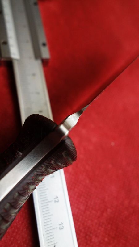

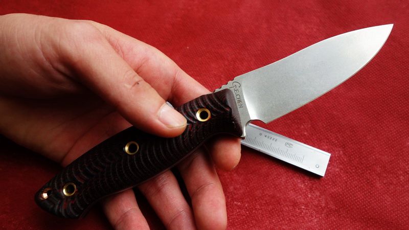

Specifications for the actual ones:
Overall Length: 21cm Total(8.25")
Blade Length: 9.2cm(3.65")
Blade Width: 29mm(1.15")
Blade Steel: CPM S35VN

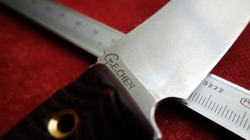

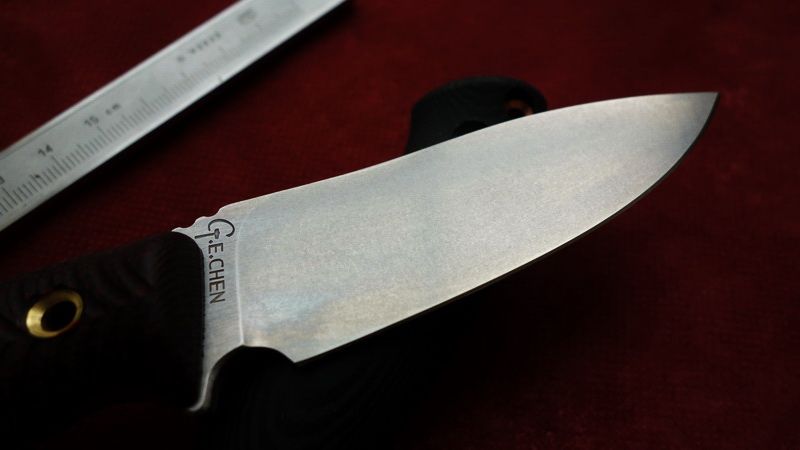

Blade Finish: Full Flat Grind, StoneWashed (Black Micarta one is satined,the dark red one is stonewashed,production making will be stonewashed)
Blade Heattreat: Vacuum HeatTreated with 2 times tempering, 58-59HRC as expected

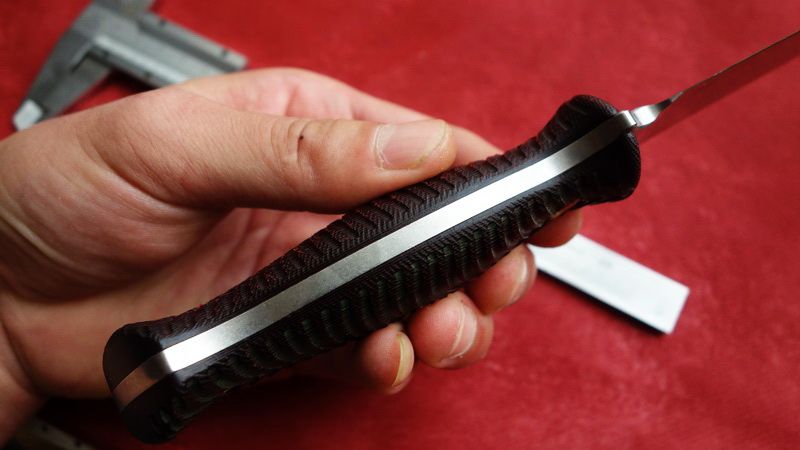

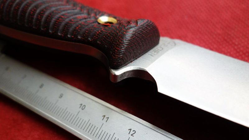

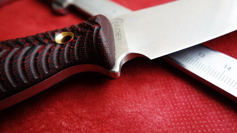

Handle Material: 3D CNCed Black/Dark red Canvas Micarta(No grooves will be added anymore,I don't think it's good)

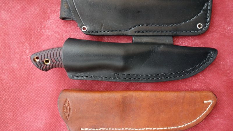

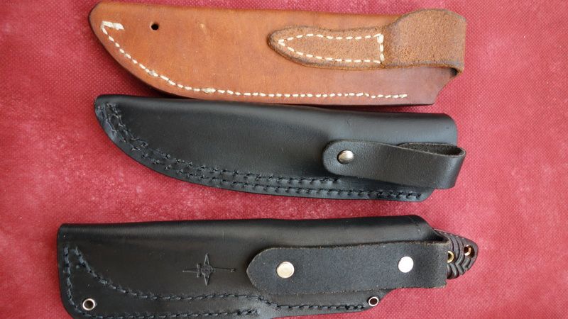

Leather Sheathed
Some pics:

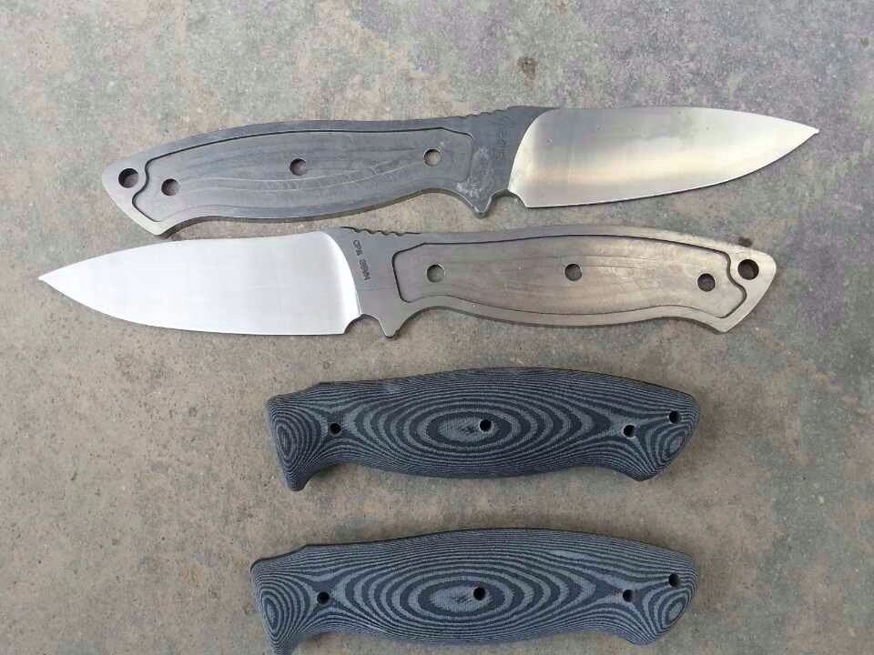

Handle was lightened as:
Thanks for looking.
