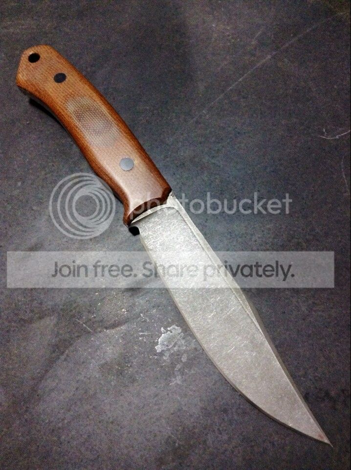

Hi everyone,I'm new into the knife making game,Before I can make a knife I always lurk in the forums and see and learn,Lucky I have a small shop myself on April 22 ,2014,and make knife until that time.This one is my second knife ,I use what I learn from other knife maker's WIP,and try my best to make this one.Here you go:

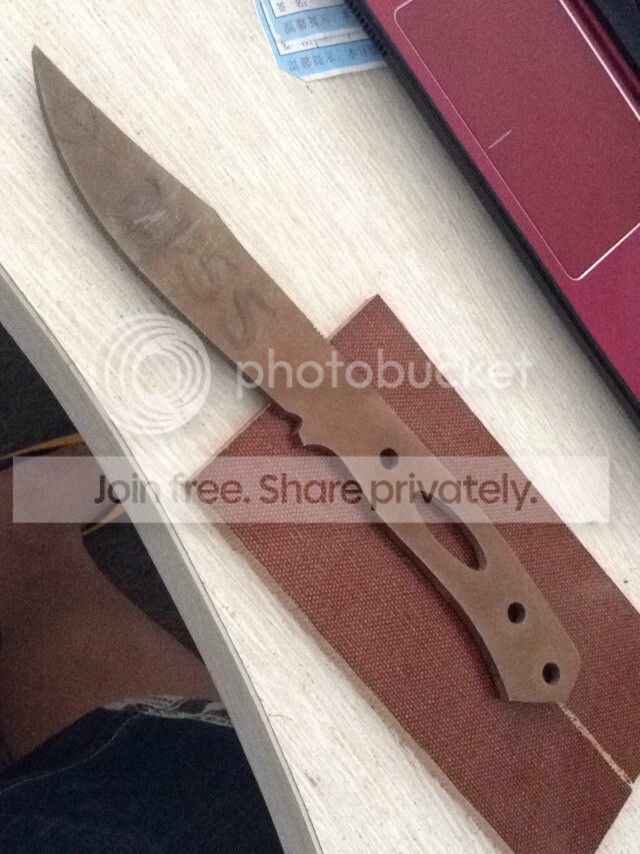

1.I got a M390 stainless from Peter HT and micarta,You can see the knife is wire cutting
2.Grinding the oxide layer off,

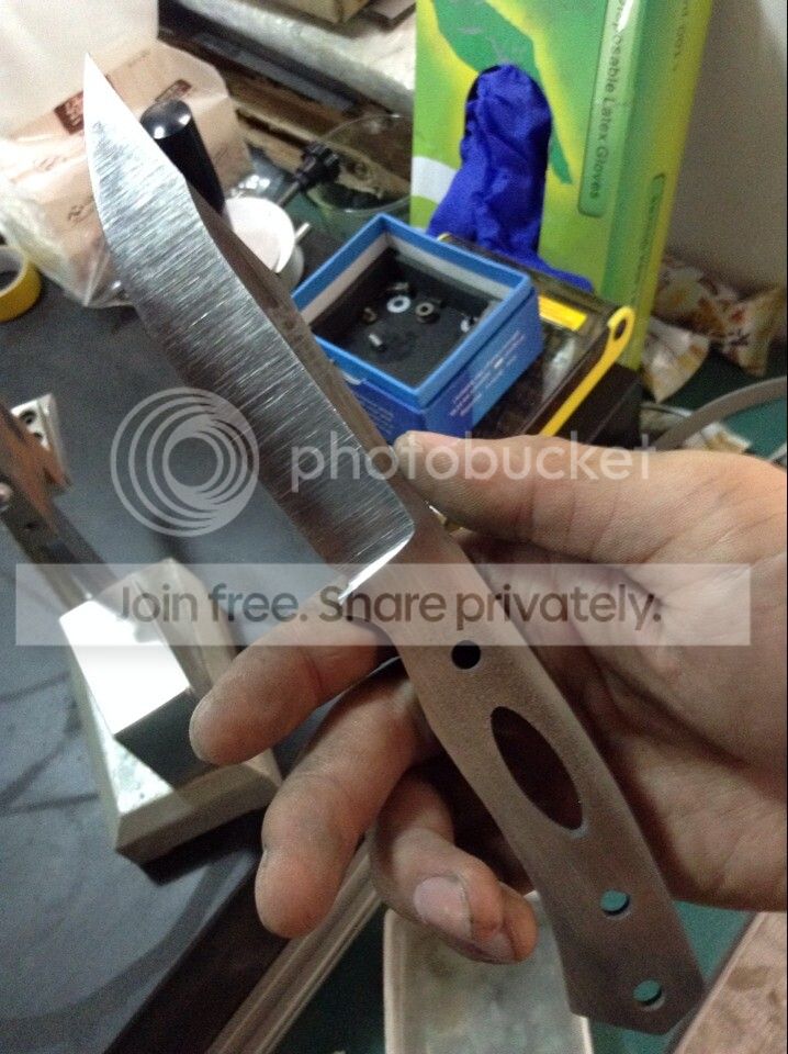

3.then begin the grinding ,I use a Jig when it is in rough grinding,

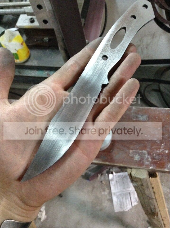

4.Then hand ground the bevel and add swedge,I use the ceramic belt ,as the M390 is so wear-resisting.

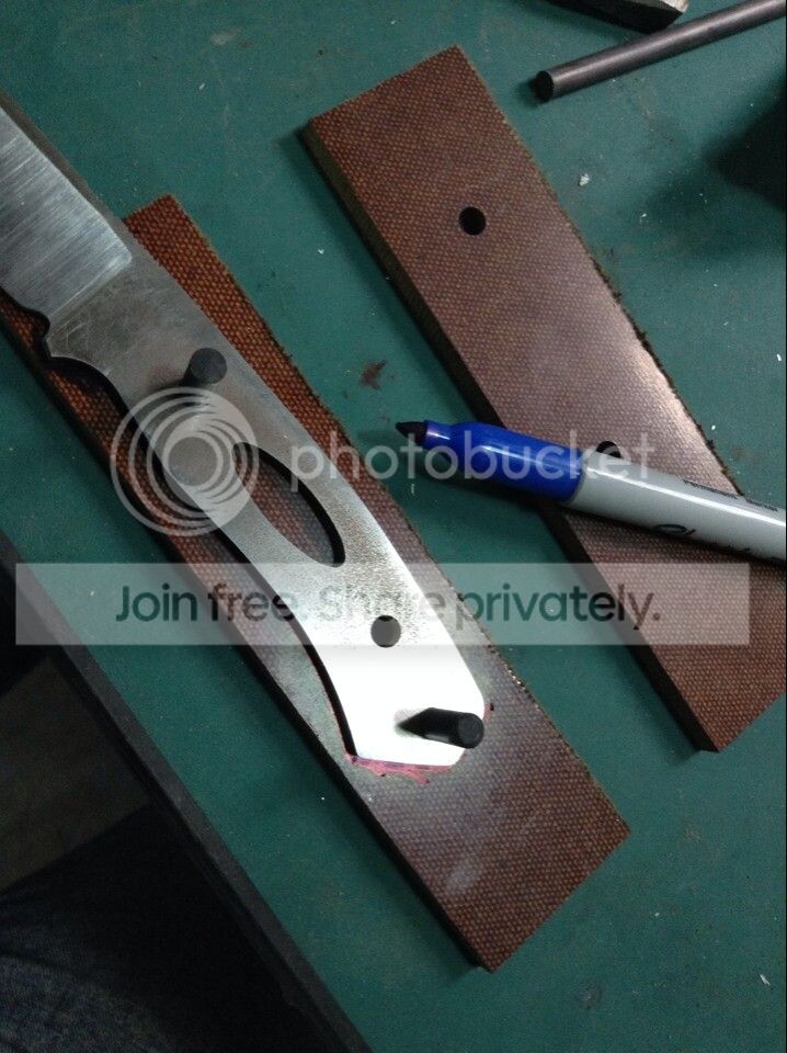

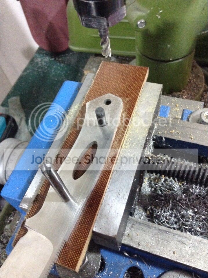

5.I use the 6MM endmill to drill the pin holes,it seems more tight than just did by drill bts.
6 Draw the llines and get it cut by a hand saw

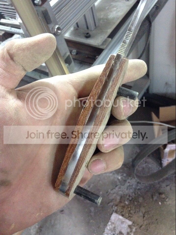

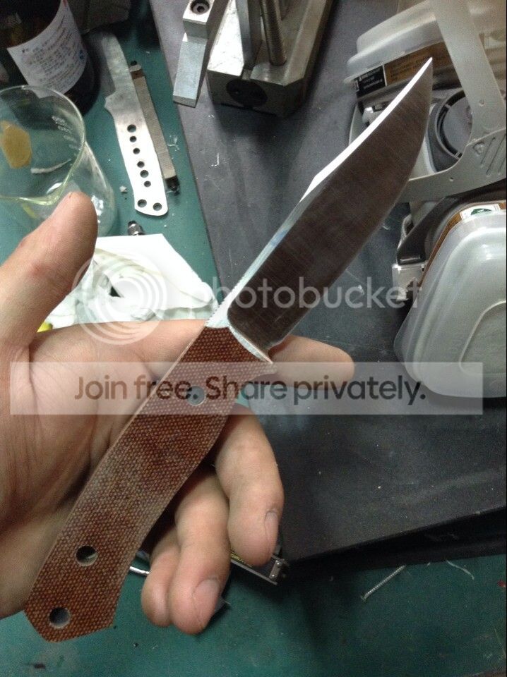

7 rough assemble and ready for take the shape out.

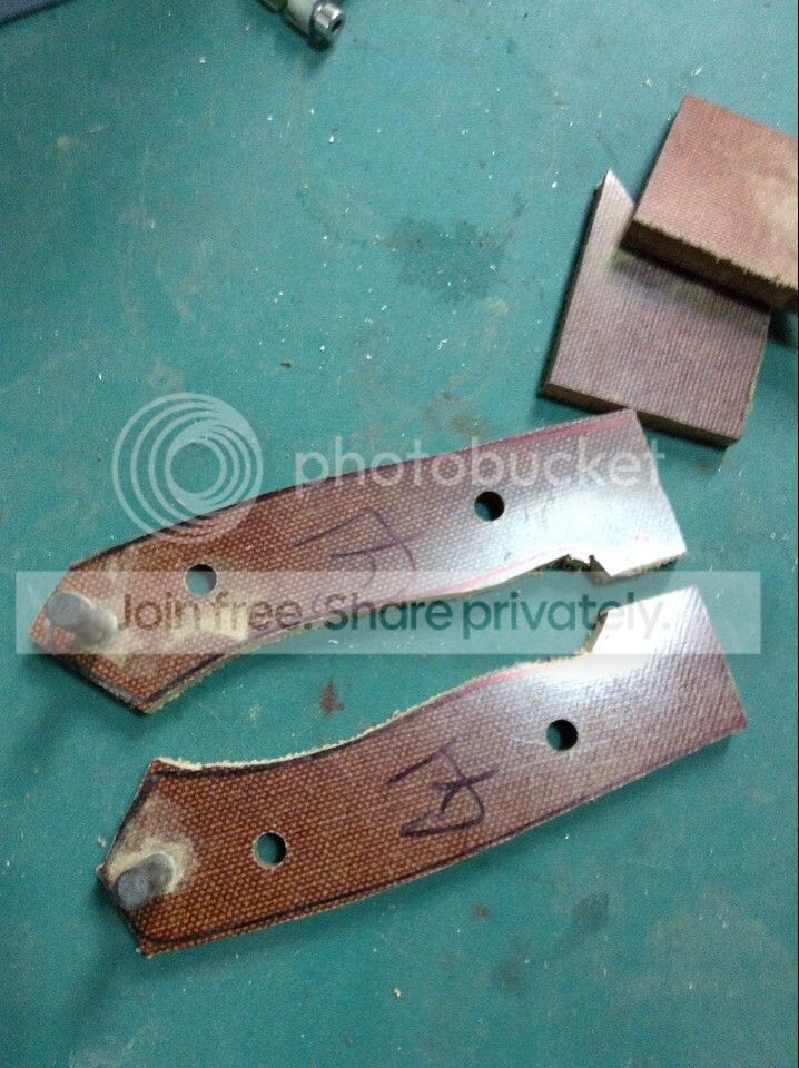

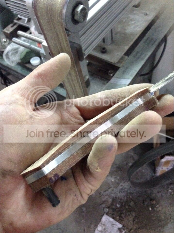

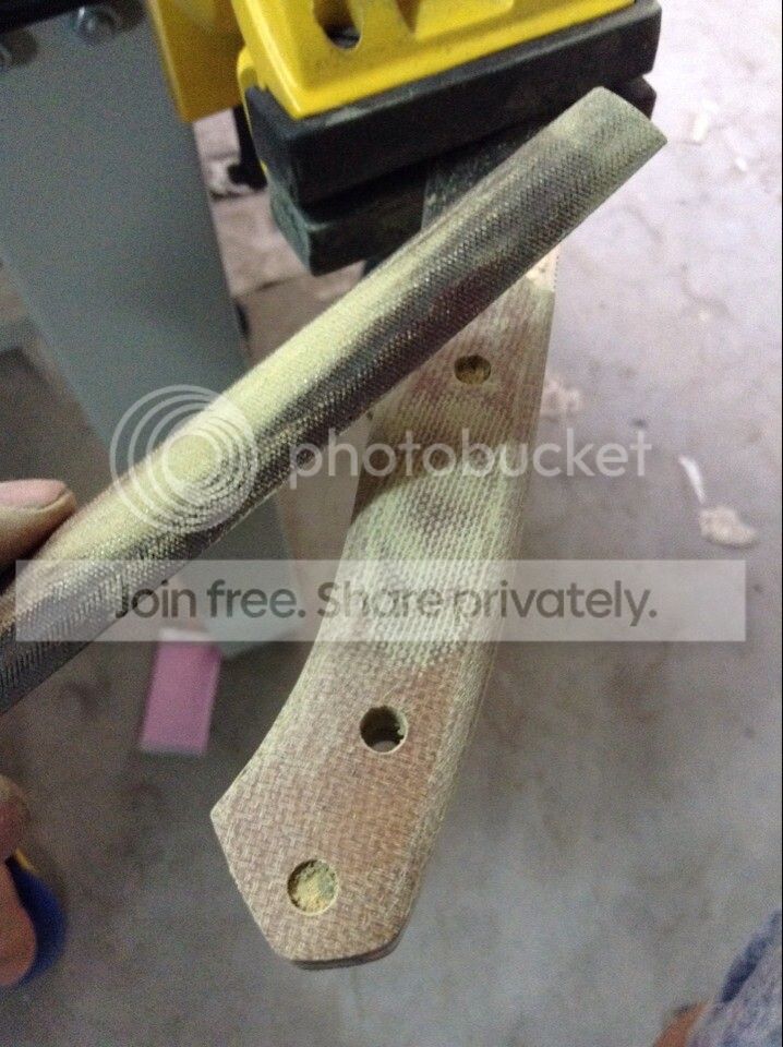

8. grind the handle
9.Then use file and sand paper to make the handle smooth,Sorry I only take little pics .

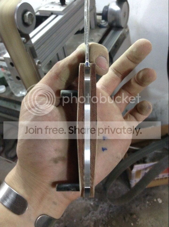

10. Handles are almost done, I sand it to 2000Grit

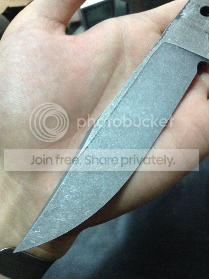

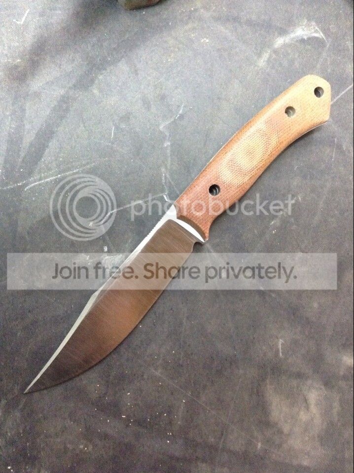

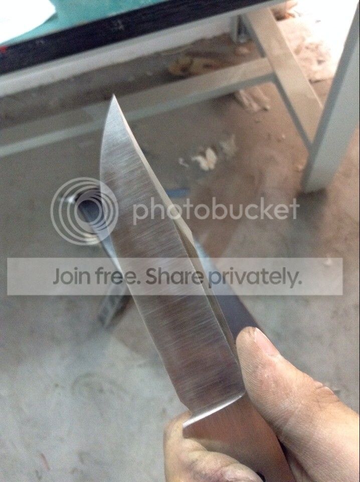

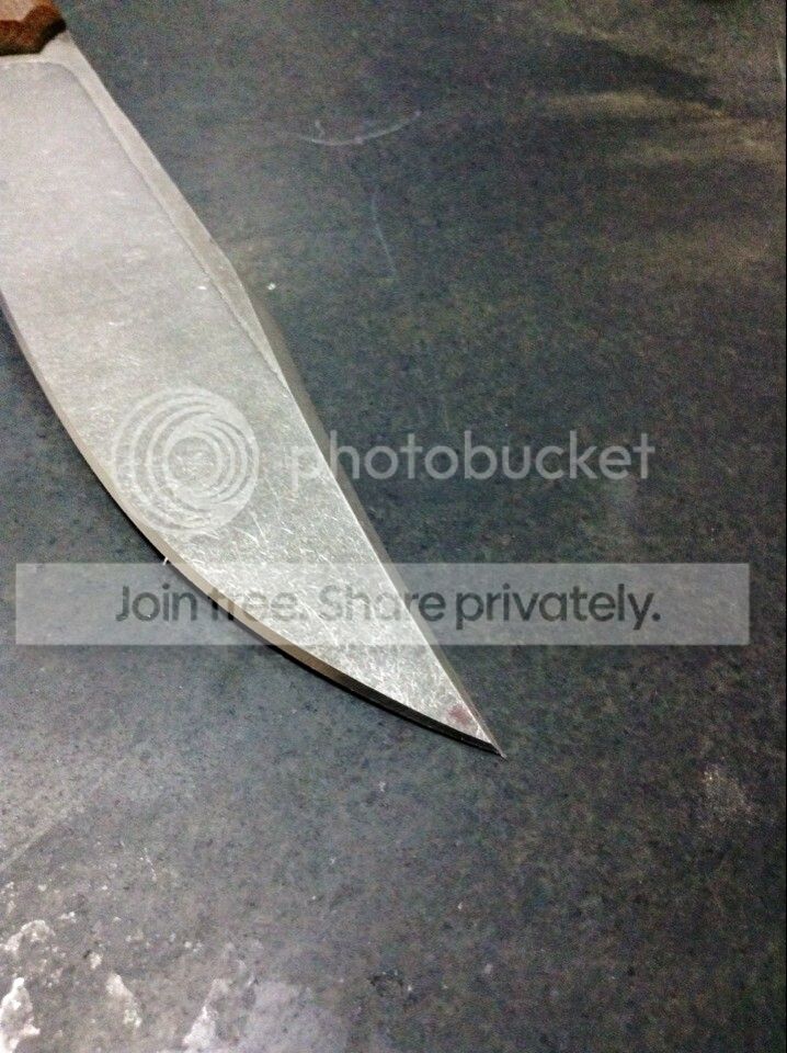

11.I use the ferric choride strong solution to etch the stainless balde ,and I put the blade into a bottle which hold some stones and shake it to make the "stone washing"

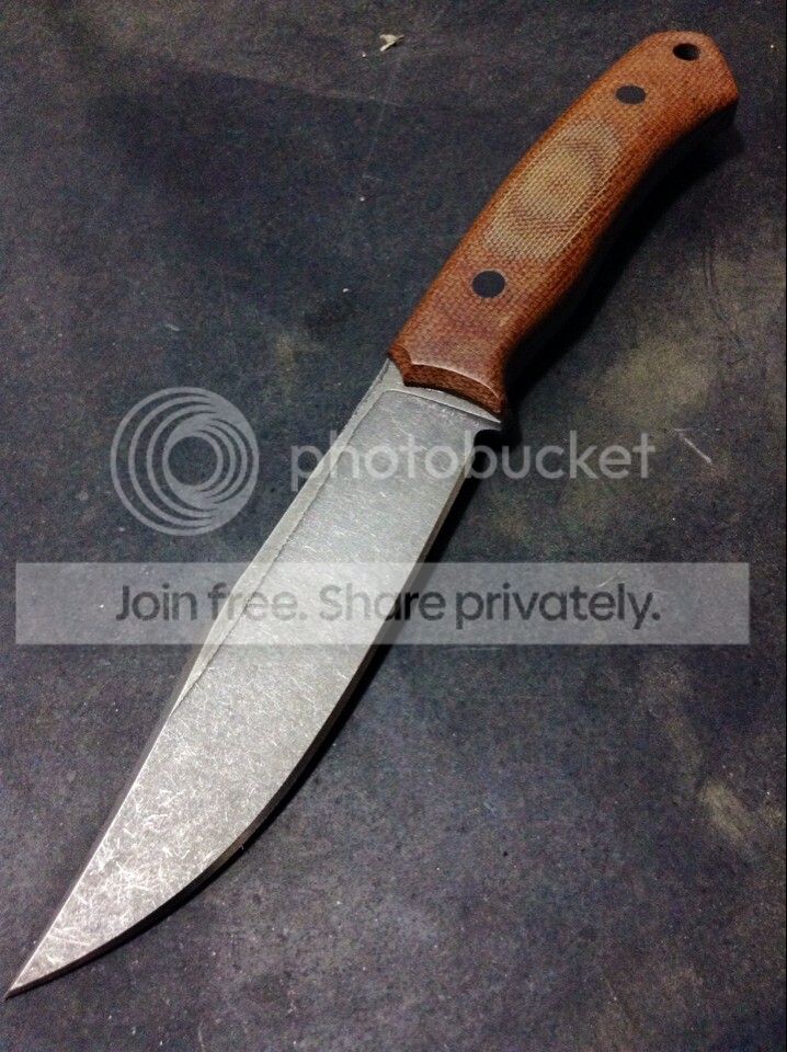

12.Last I epoxy the handles and put the finally sharp edge
