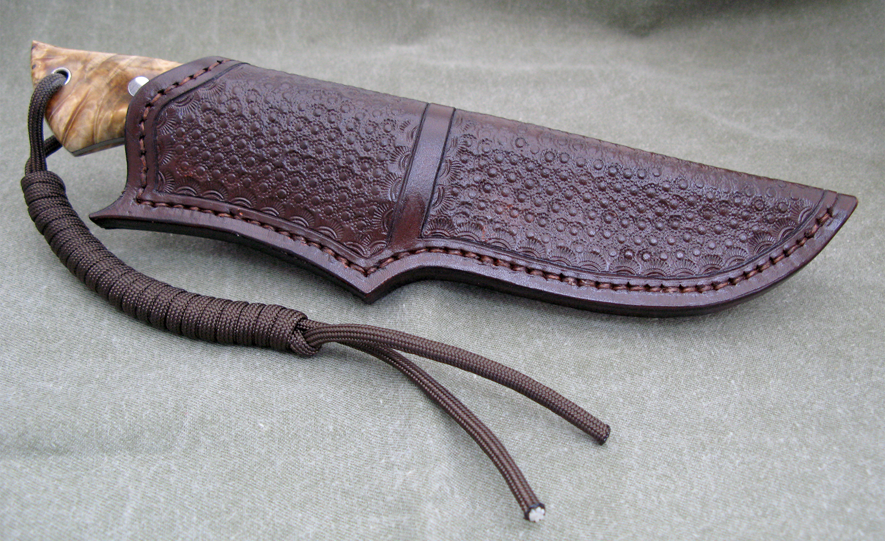

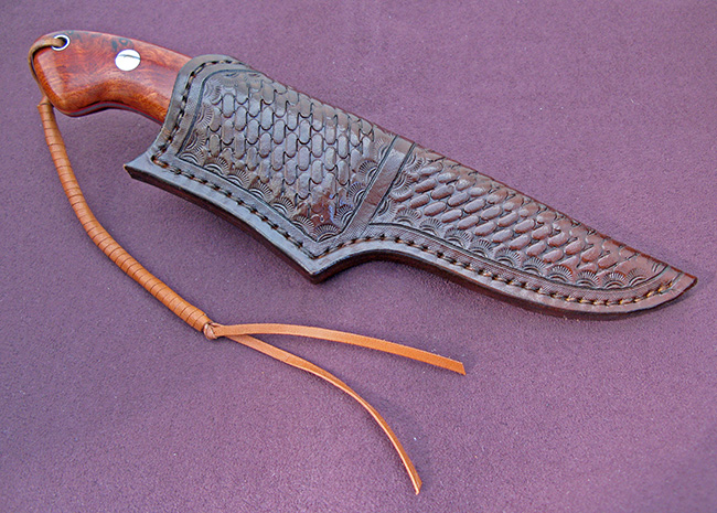

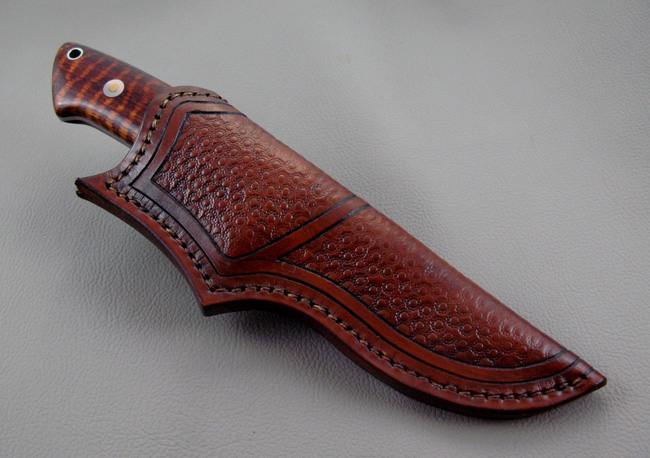

I tend to post regularly on the "Knife Maker Shoptalk" forum, as this is where my roots are: a mechanical engineer who makes hunting knives as a hobby/business.
Yet, I've been tinkering in the leather working arena for at least 7 years. I fit each of my knives with a custom sheath. As time goes on, I think my work has reached a level to which I'd like to show a few photos. I've still got a long ways to go to match the quality of some of the work shown here.
Constructive comments are highly welcome.
But here goes:

I really like your work. I mentioned when you posted the top pics over in the makers gallery that I really liked your unusual use of that meander, carlos border or running w stamp whatever you want to call it. Same goes for your flower center stamping on some of the other sheaths. I really like your creative use of these stamps. I think you might want to round that top corner some on some of those sheaths. I find it very visually appealing however its been my experience that any sharp corner like that will wear and also turn up in time. Your second snakewood handled knife down in your pics that sheath looks like its starting to do that. I had to change one of my patterns some years back for the same reason. That sharp corner will just do funny things over time. But like I said it sure looks cool. Maybe try not to bleed your stamping so close into your border stamping. Occasionally it seems a little muddled. If you border stamp first you can always go over it again after you've done your center stamping to clean up any bleed over. Lot of guys will do their center stamping first and then border stamp to prevent that bleed over. Doesn't really work for me though. Couple spots where your edger could of been sharper. I recognise it from alas not having my edgers sharp enough at times. I about touch em up every time I use em.

Woah good eye on the meander stamp. I was trying to figure out which stamp made the pattern, figured it was a custom oval or something along those lines. I love when you look at creative stamping and it dawns on you that it was done with a mundane tool.
As for the corner turning up, Dave made a similar comment about one of my designs. The sheath hasn't had any problems yet (I keep in contact with certain customers just for this type of thing), but I have no doubt that it's good advice. I've eliminated such corners as much as possible. ;)

Thanks for the great feedback. I've started to recognize the potential pitfall of the sharp corner on these sheaths recently but haven't really gone beyond that. I'm glad that you brought it up, as I'll see what I can do to maintain the basic shape of the sheathes, yet, substantially round that corner to prevent feathering in the future.
I usually bevel my border, then stamp my centers, and then come back and use a border tool at the perimeter. I often run a bit of my center stamping (lightly) into the area where I know the border stamp will end up over-stamping the center pattern. It sounds like it may be better to stop my center stamping just shy of where the border stamp will make impressions to prevent any muddled details?
