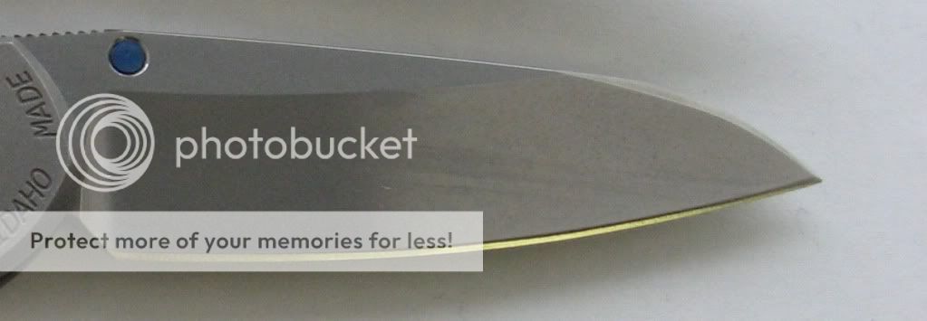

I've been using my small Insingo for pretty much everything over the last two months. The only knife that kicked the Insingo out of my pocket was a Mnandi. The main reason it took a back seat was that it was becoming a PITA to get sharp using my Sharpmaker. Started with the brown stones and could never really get a decent edge back. I used a perm marker and discovered that the angle was significantly greater than 20 degrees per side. That pretty much meant the Sharpmaker was not even touching the actual edge. I confirmed that by increasing the angle and doing some free hand sharpening that improved the edge.
Since, to me, the small Insingo is my ultimate EDC so it justified the time spent to break out my Edge Pro and re-profile. I did the same thing with my Mnandi which is now a dream to slice with as well as resharpen. For the Insingo I set it at ~18 degrees per side and re-profiled down to a semi-polished edge at 600 grit. That allows me to use my Sharpmaker at 40 degrees (inclusive) for micro-bevel touch-ups. I will add that the Insingo blade shape makes it very easy to sharpen on the Edge Pro. It did take about 20mins of work using a 220 grit stone to reprofile the initial edge.
Kind of hard to get pictures of the edge but here's one at least:
