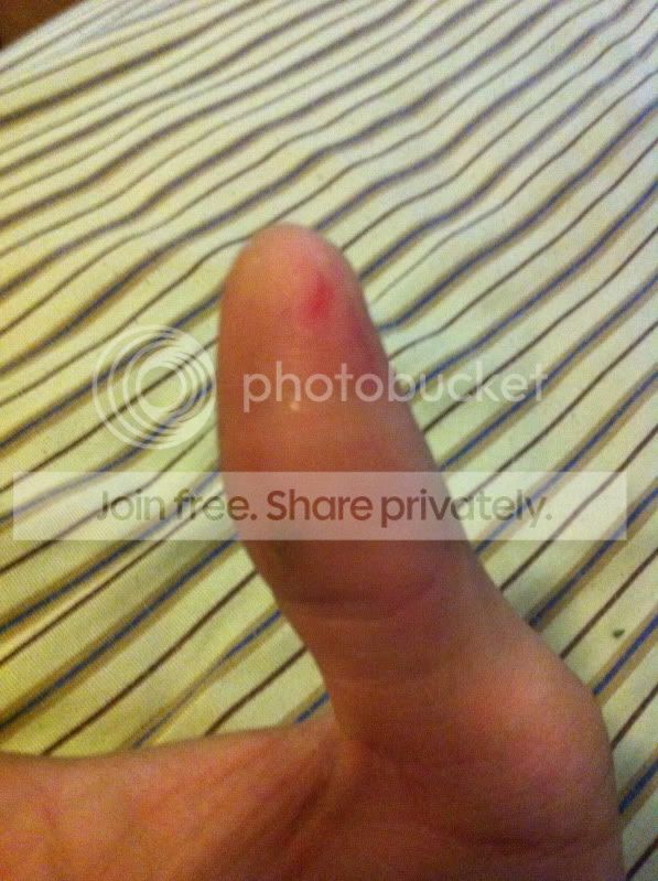

Wanted to ask for some advice regarding my grip of the knife.
It took me about 2 days of use before I realized that the spine was cutting my thumb:
Since I'm cutting corn with the knife and the corn is a bit old, it's roughly like cutting wood. There's a small patch of non-slip material on the back of the handle for the thumb, but I find that I can't exert enough force to cut through the stalk unless my thumb is further up on the spine. I was wondering if there's a proper grip for power cuts, as I usually don't need to use that much force for cutting things. If not, I was considering taking the spine to a belt sander and rounding it off.
