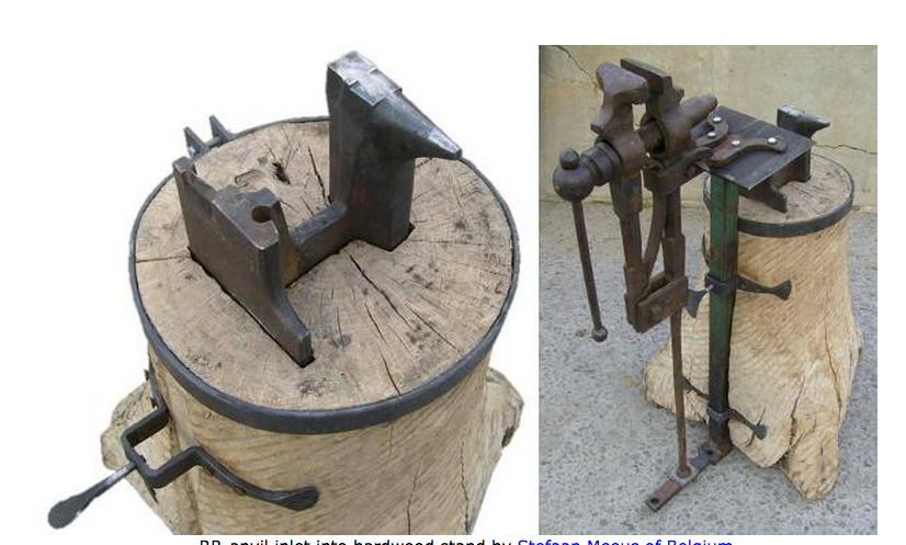

The center mass will always have a sweet spot. Most manufactured anvils will actually have harder edges due to the edges being the further away from center mass... that's why dressing an anvil correctly is always a good idea, the edges are less likely to spall and chip.
Railroad tracks are awesome little post anvils...
This is probably one of the most ingenious little RR track anvils I've ever seen.
