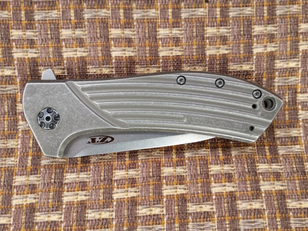

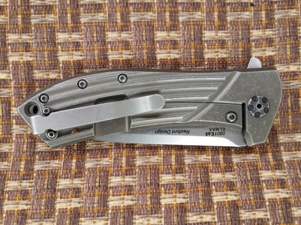

First time I ever tried this. I darkened it with Oxi-clean then stonewashed it in the dryer. I think it turned out pretty good.
Here it is after darkening.
And after stonewashing.

I soaked it twice because I wanted it darker, but I don't think the second time helped much. The first time I soaked it over 2 hour and kept adding hot water and oxi-clean. The second time was about 2 hours, but like I said I don't think the second time helped much. I kinda followed this.
