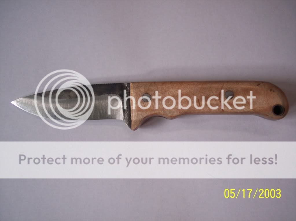

I recently went to a knife makers shop to observe him while we worked on a knife design of mine. He taught me a lot- he is actually the owner of the Rkknives.weebly.com. Here is the knife we made- made the handle myself with a piece of 1 inch tiger maple and cut t in half. The mirror Finnish was accomplished by applying 5-7 coats of "The Original Super Glue" and sanded t for an hour with some 600 grit sandpaper.

OH, AND ANY CONSTRUCTIVE CRITICISM OR THOUGHTS WOULD BE MUCH APPRECIATED
