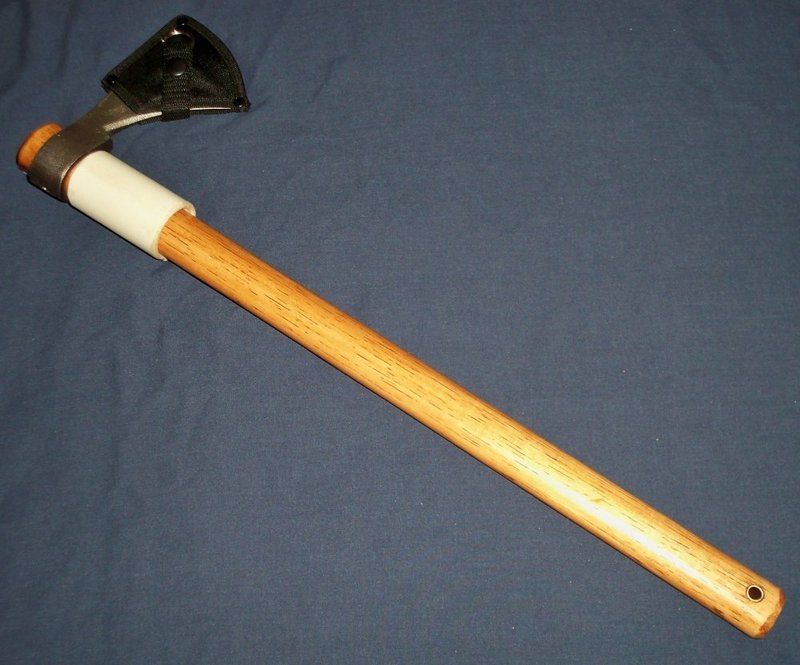

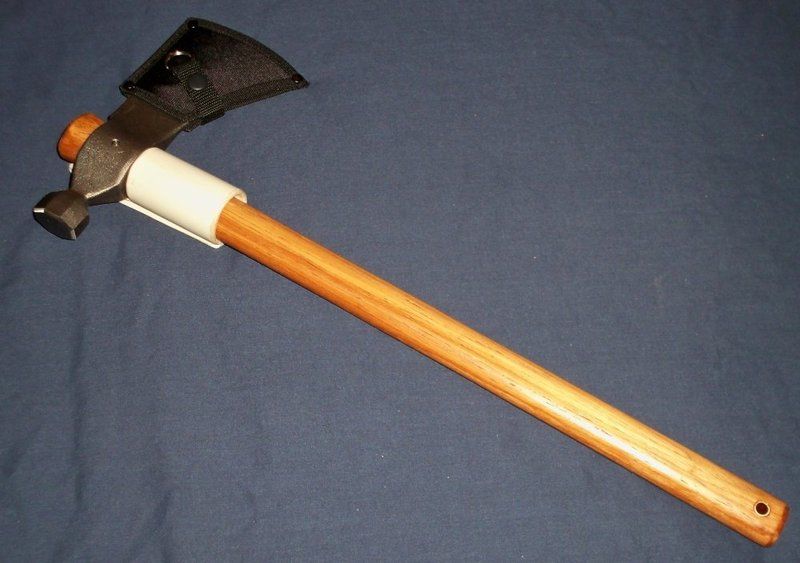

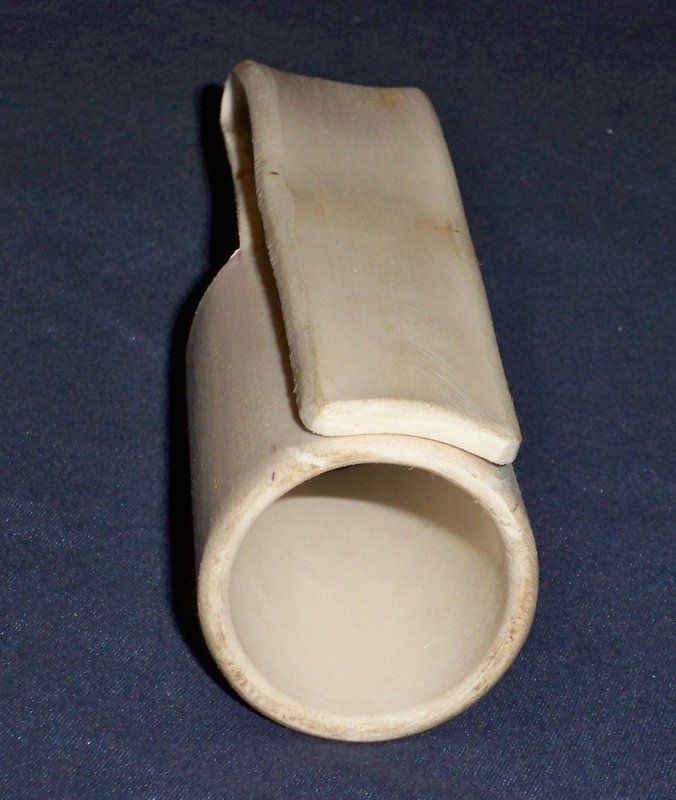

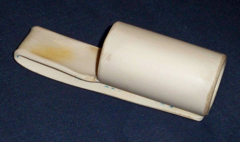

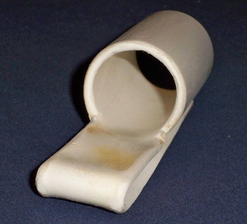

I've been looking for a belt mounted tomahawk holder, but the assortment has been disappointing. What hasn't been disappointing has been expensive. So out of frustration and boredom I built my own.

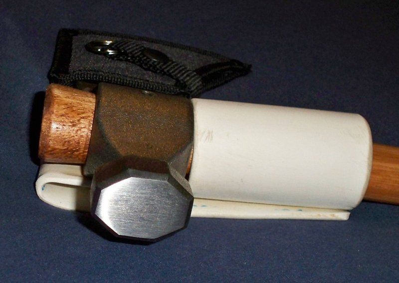

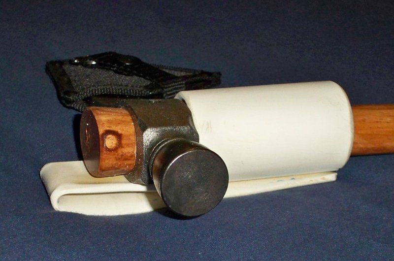

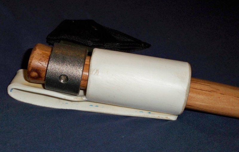

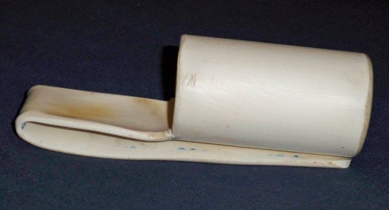

It's ugly because it's a prototype, and I didn't expect it to actually turn out successful. Surprisingly it did. It's easy enough to slide onto the belt without sliding right back off because of the angle of the bend.
The edges have also been beveled so there's no hard scraping of the handle when it's slid in or out.

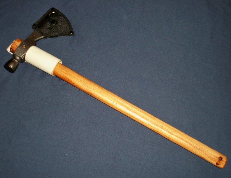

It also works well with each of my Cold Steel hawks, holding them in place by simple friction.
The only downside is it being rigid. If you have to bend over, it sticks out straight and can get in the way. And with the handle being at full length, it gets really awkward.

IS that PVC you used?
Yeah. 1 1/4" schedule 40.
