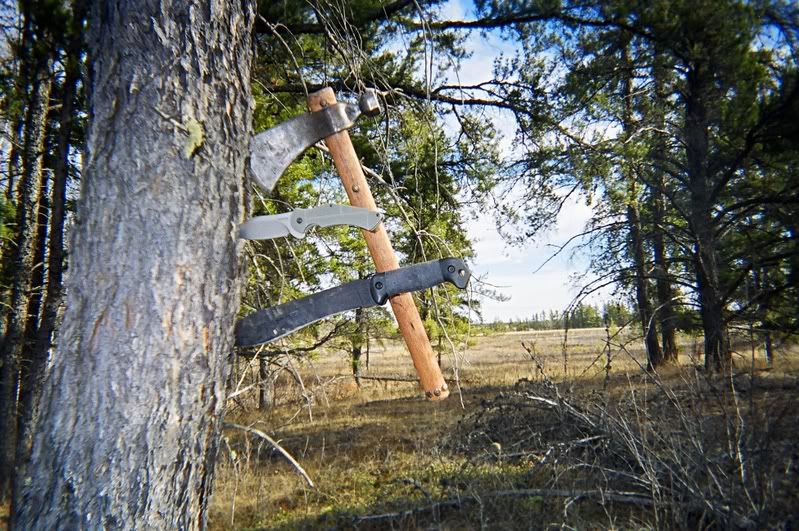

Nope buddy, just some hockey tape so that the grip was less slippery. I love the Brute as much or more than the hawk.:D My hawk isn't really fancied up because it's more of a "user" than anything to show. I did stain the shaft/drill and pound in decorative tacks (more to stop it from slipping through the hand). Istripped and cold blued the head twice. Now I just sharpen and oil the head now and then. I thought about grinding the hammer head down to a spike to look more original, but, as I said, it's more for work than show. Who knows what the future may bring though eh?;).......Funny, but I just finnished resharpening the Brute and hawk about an hour ago.:)
great action pics of the hawk and knives Upnorth.
