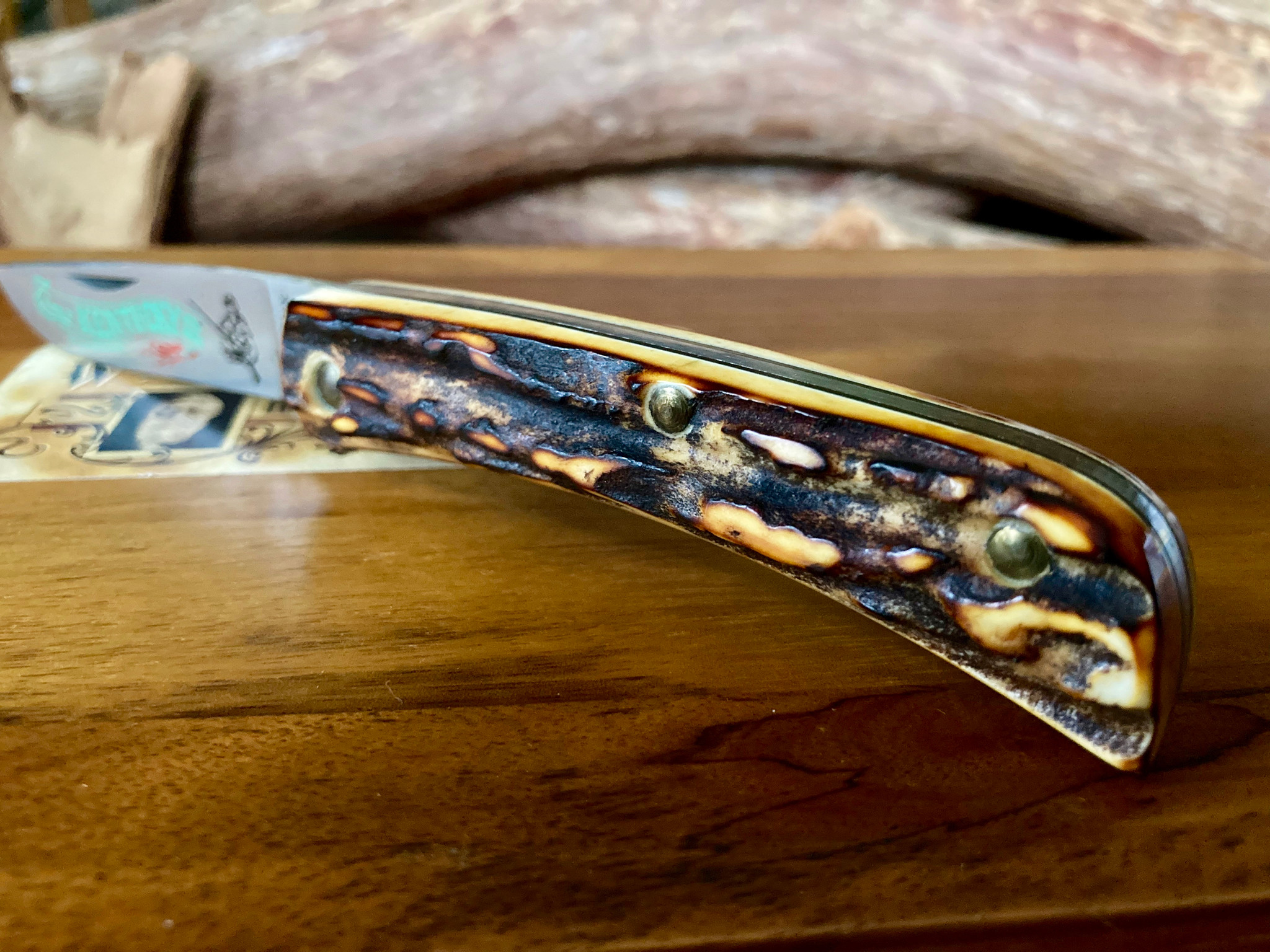

I have a Rough Ryder like that. Ray Cover used a black spacer on his knives as well but none of these are stag.

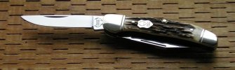

The Boker in this ad shows what I'm talking about.
Those appear to be Small Gaps between the Stag and the Bolsters . IMO If you do not like it in Photos , you will not like it in hand . Remember they try to pick a nice knife for photos . You also most likely will not get the knife they show in the photo .
