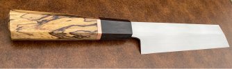

Small Damascus cleaver 3.75” cutting-edge 8”OAL with cheap denim-carta from Etsy. I tried to do a standard etch then copper the nickel(didn’t work at all), eventually I hit the entire blade with a medium scotchbrite belt to remove all the oxides but left the topography which I kind of dig. Might have to revisit that technique later.
My first Wa handle, first chisel, & first urasuki.
Ebony/Copper/Spalted Pecan & 52100
IIRC handle is 5.75” blade is 7.5”
