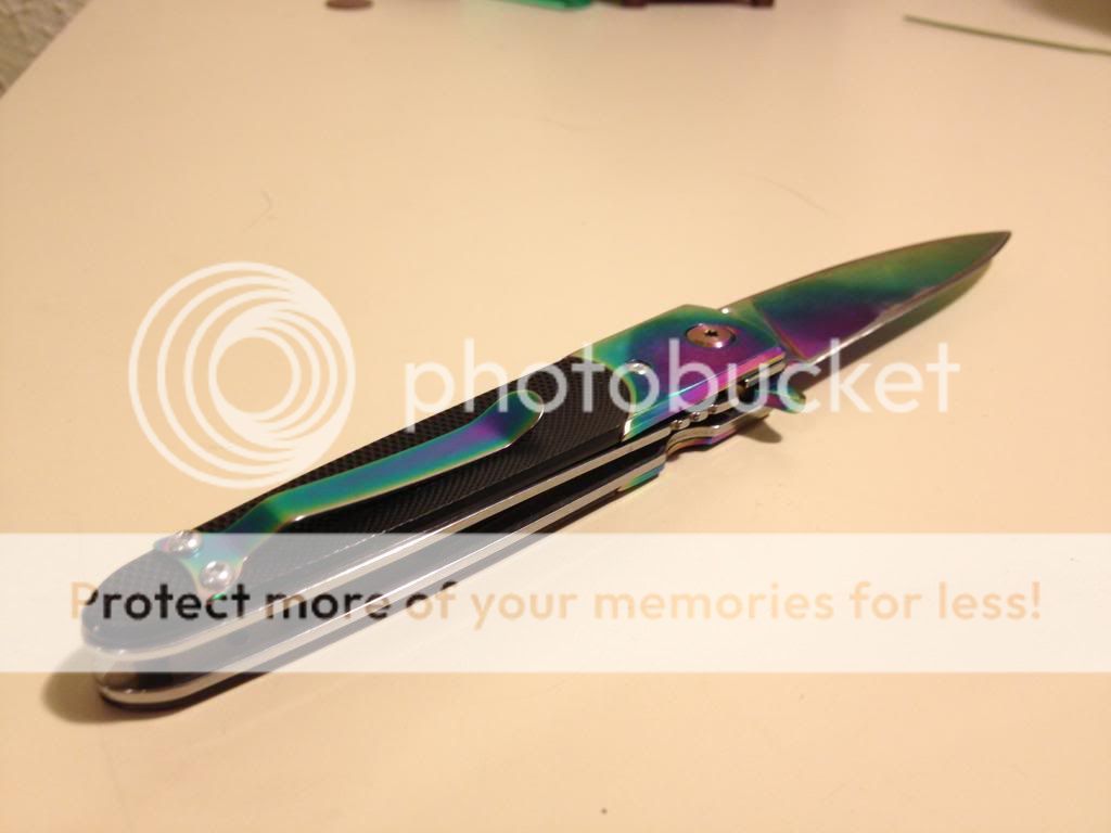

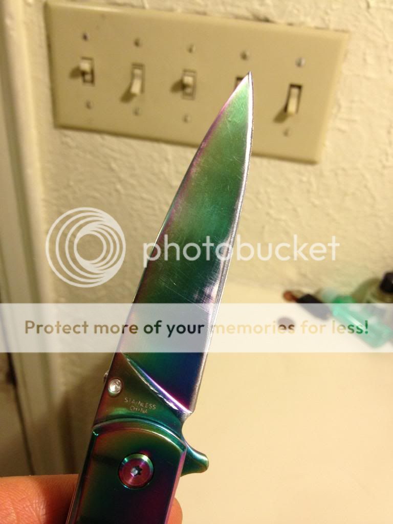

You can see in the pictures, some of the finish was buffed off of this mystery no-name blade of mine. I'm wondering if I can just take a torch to it and touch up the finish or what?

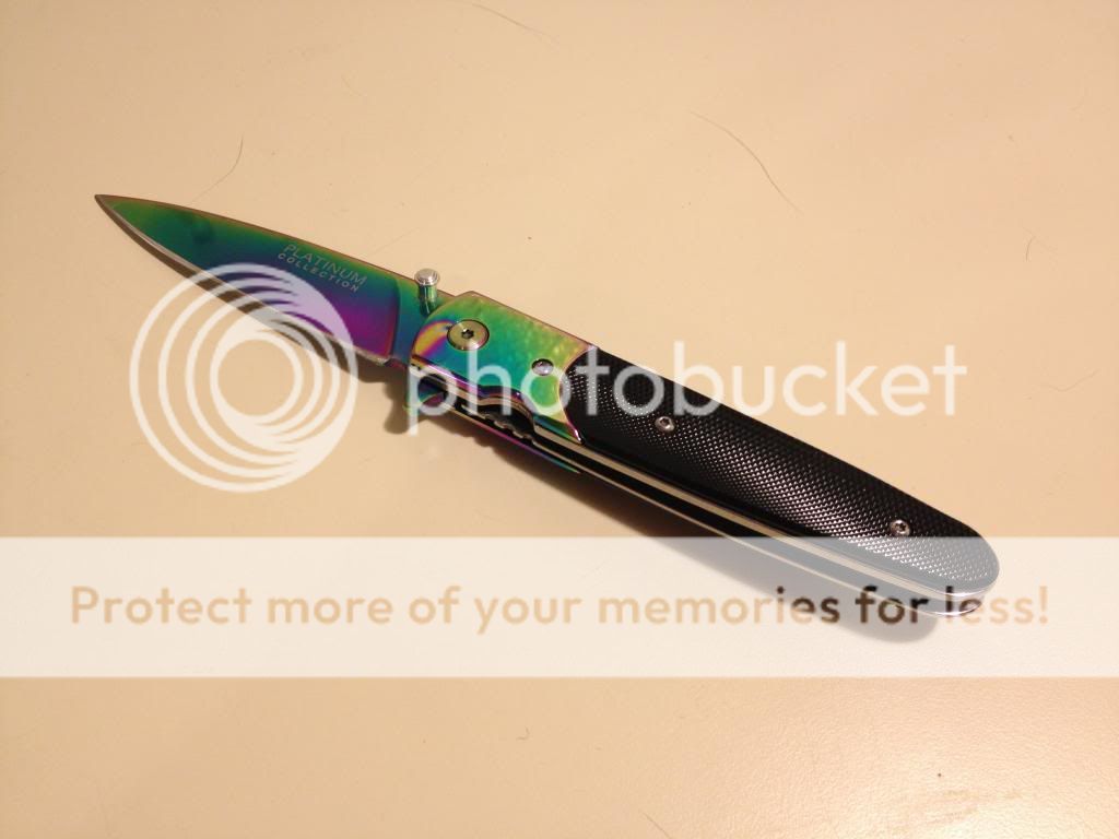

My dad picked this up for me at a flea market. It's a no-name knife as far as I can tell (just says "Platinum Collection" on the blade), but it's actually pretty well built! Sure, it has some cheap plastic on the handle and an annoyingly high-rise pocket clip, but it's also a zippy assisted opener with zero blade play and a strong liner lockup. Plus, it has a cool heat-treated mirror finish on the scales, pocket clip and blade itself. Anywho, if this knife looks familiar to any of you, go ahead and tell me about it. But like I said, I'm pretty sure it's just a well-built budget no-name knife. I mostly just want to fix the damaged finish.
If you value the knife at all, do not use a torch on the blade. As for the finish, I am afraid that you must live with it.

A torch to the blade will only let you know that it destroys the hardness from the heat treatment and no longer hold a edge. If the finish bothers you you might just want to sand it off. Finish with a scotch brite pad. I would guess new, the knife was under $15.
I think that's a titanium-nitrite finish, so a chemical based coating not heat. Kershaw has a few in the same coloration might take a look at theirs.
Haha you guys I don't hate this thing that much, I was honestly just wondering about the finish. I know this thing isn't nice but like I said its surprisingly solid, just cheap materials. But yeah it does look kind of Leek-ish.

Not to sound like a "knife snob" but I wouldn't waste any time on a knife marked "STAINLESS CHINA".
I don't have anything against stainless steel, and I don't have anything against knives made in China, but that particular type of marking is the sign of a VERY cheap knife (cheap as in junk). It's exactly the type of knife one might expect to find at a flea market, or on the counter in a gas station. Though I haven't handled it or inspected it, I'm willing to wager a lot that it isn't a quality knife (lock reliability, blade steel, heat-treat).
