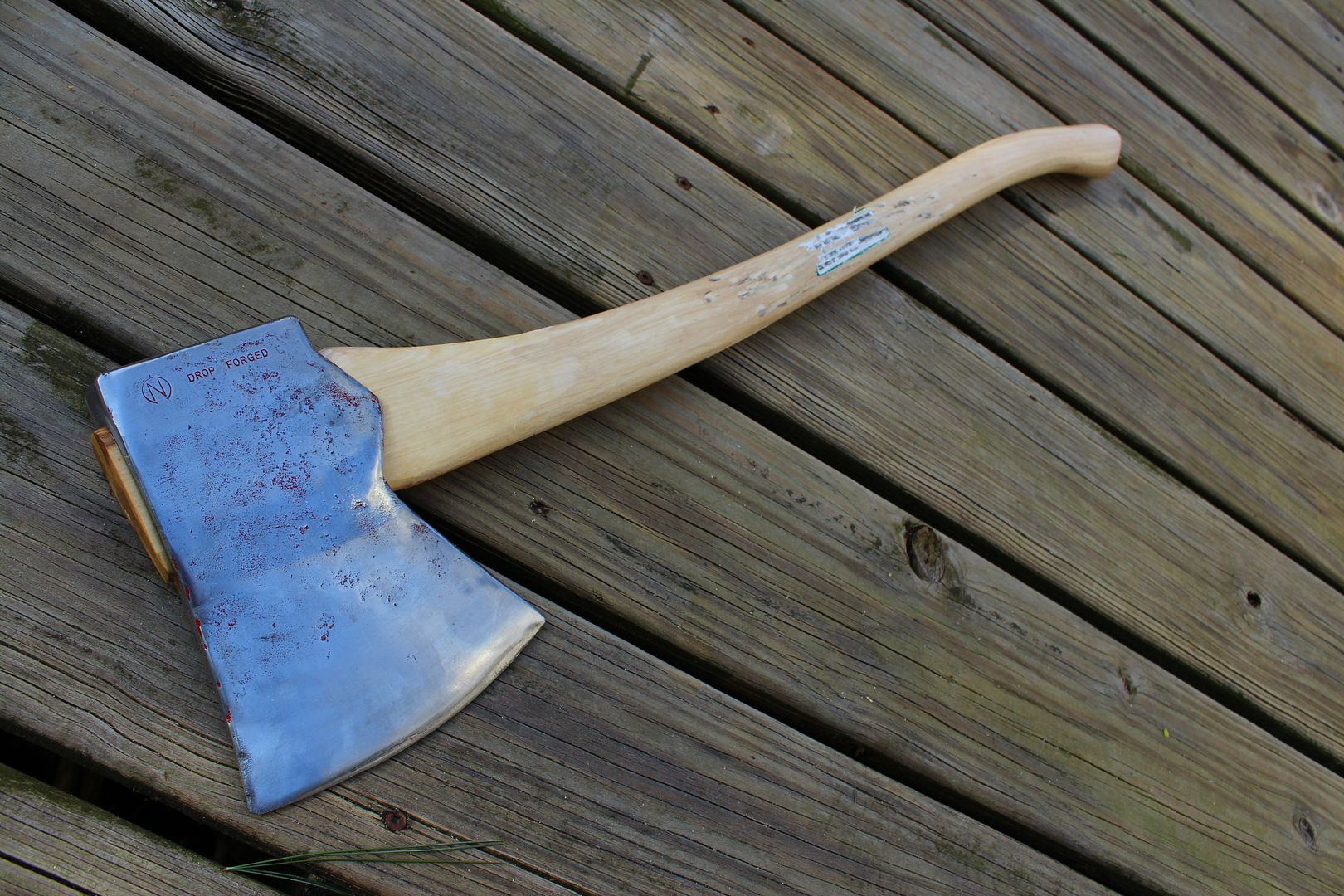

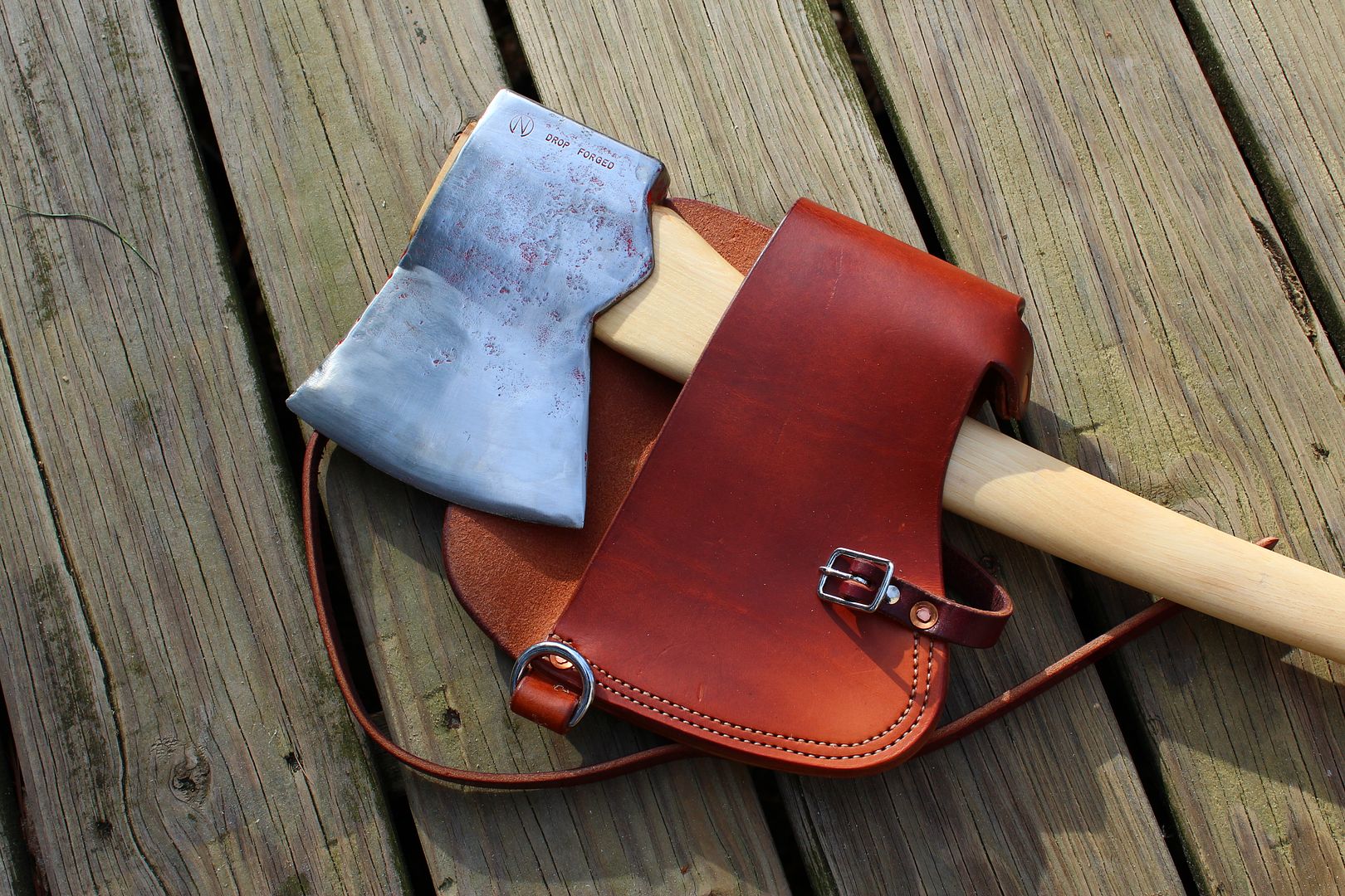

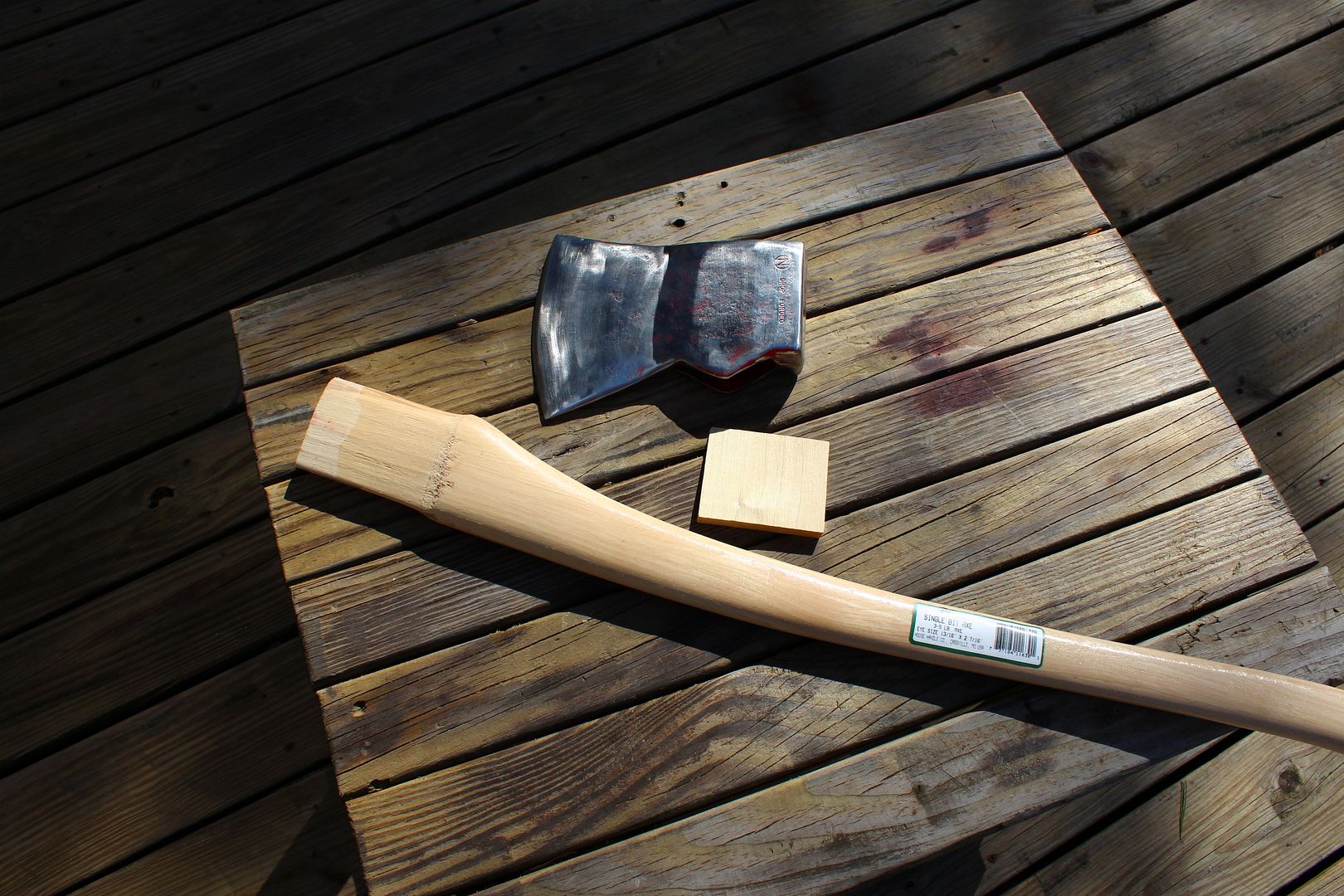

Okay, here is the score. Some Jersey head I bothered to do no research on, and a househandle. 30".
Starting work on the neck,

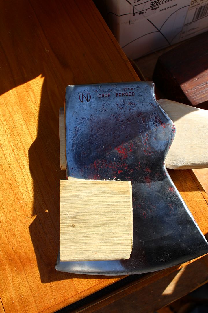

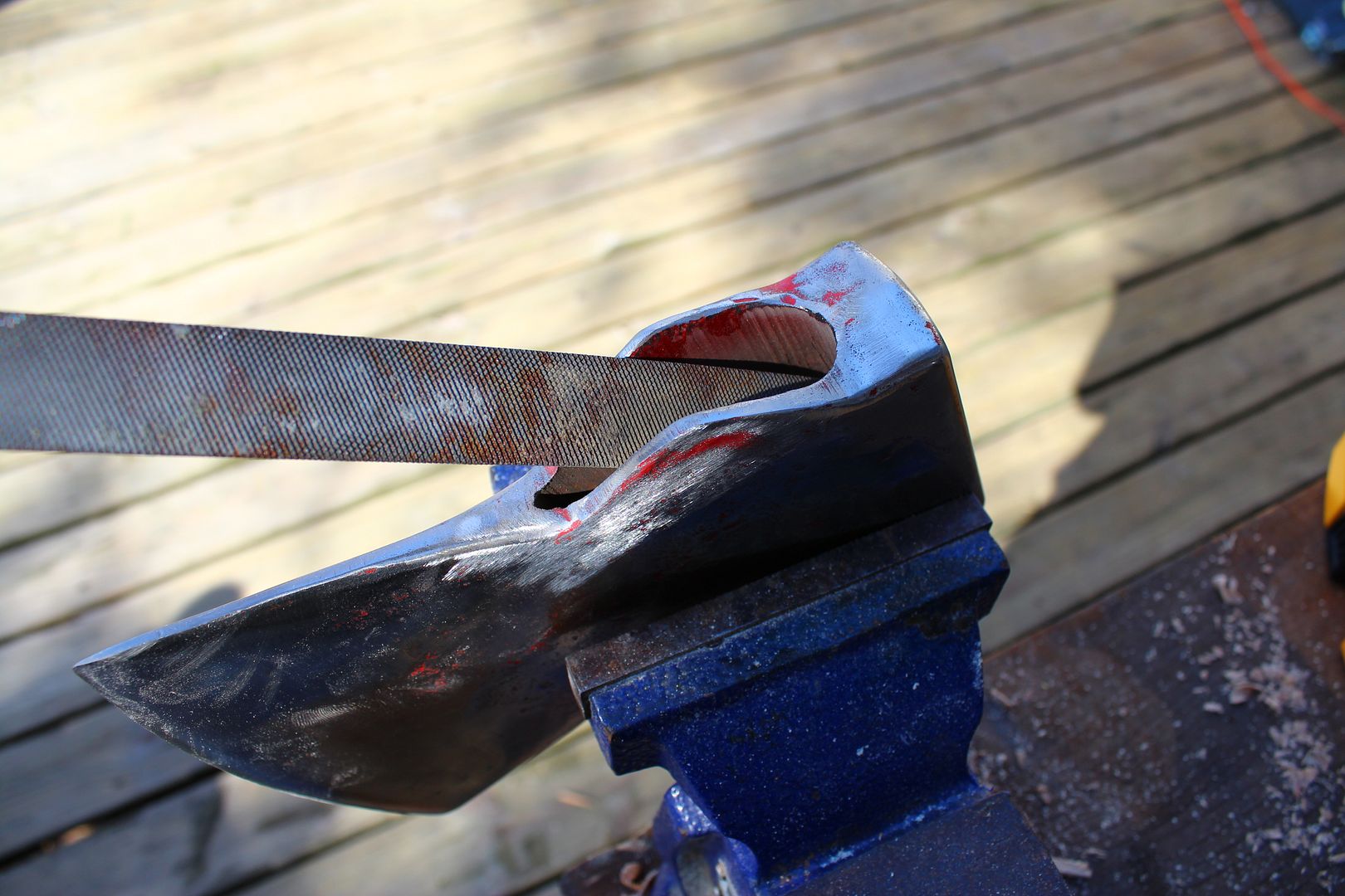

A little trick using the 6" to get the sides flat for the lugs, works a charm,
I take the bite off the steel here with a file, this lets me tap hard and not shave the neck down,

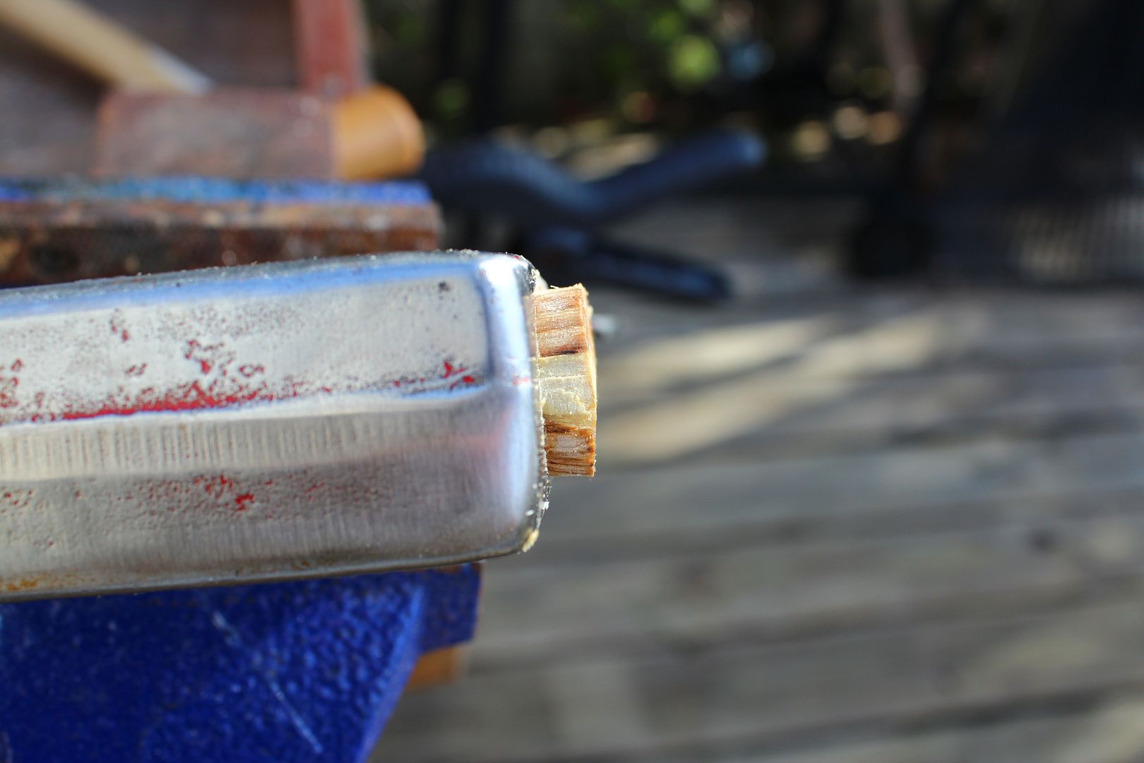

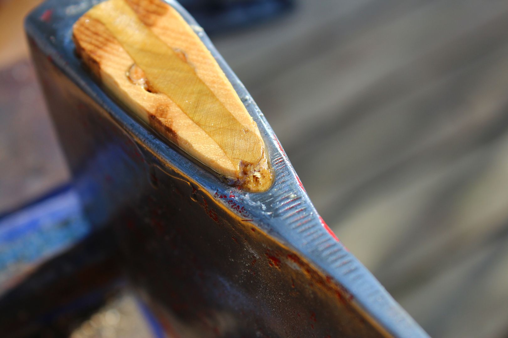

I sawed down the cut to get a perfect depth for the wedge, here is where it should be,

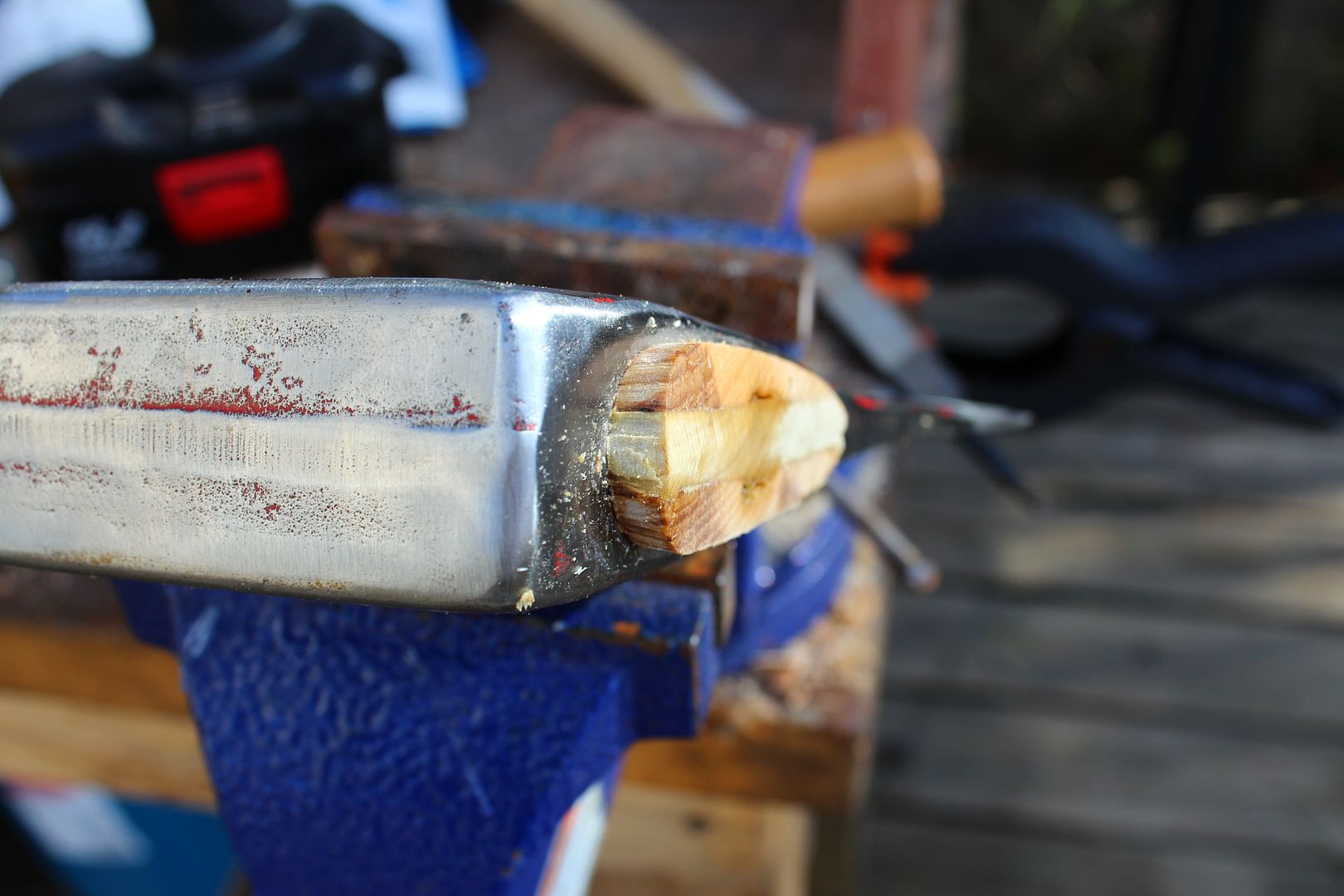

I can't take pics of myself driving the wedge home, so this is the result. It bottomed out perfect, and went in real tight! Oil seems to be the trick for me. Alignment was perfect ;)
The only problem with this one, is the very tip of the wedge broke off right at the end of driving it home. So the wedge went in real tight, and the grain couldn't take it. Minor cosmetic, nothing I am going to loose sleep over,

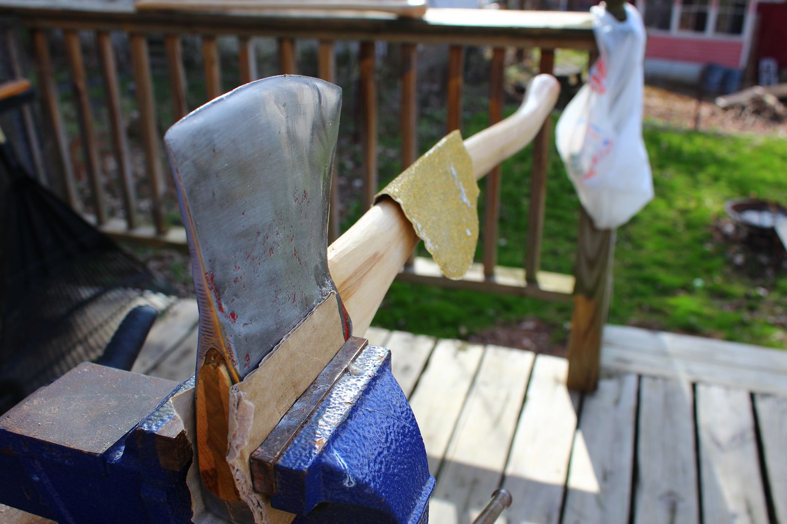

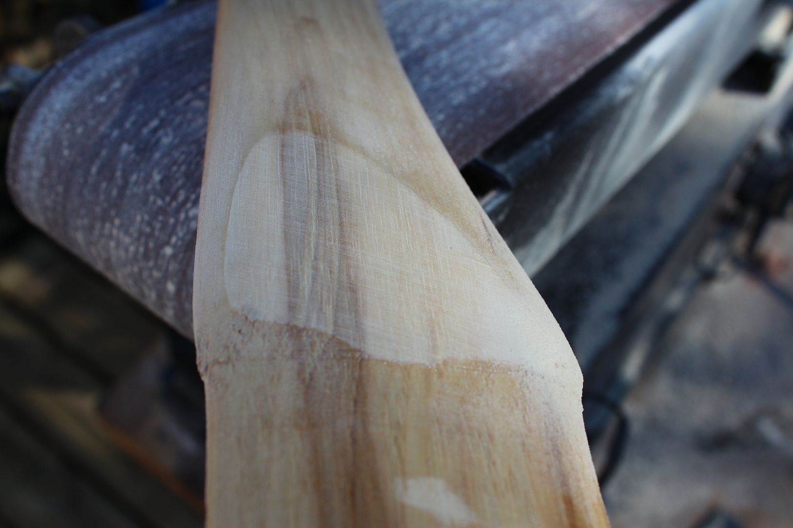

Before getting to work on sanding,

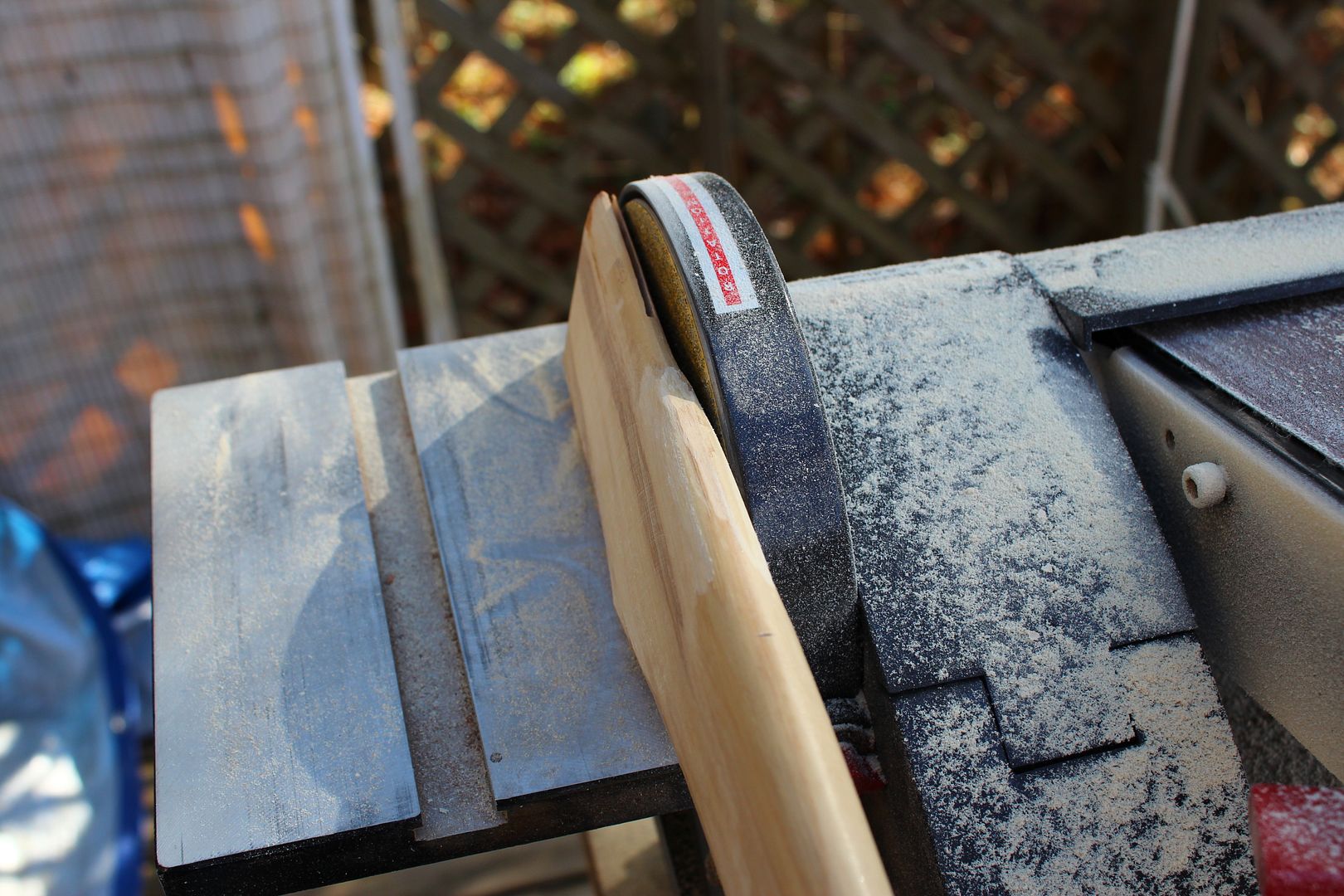

Starting with the 40 grit, to even it all up,

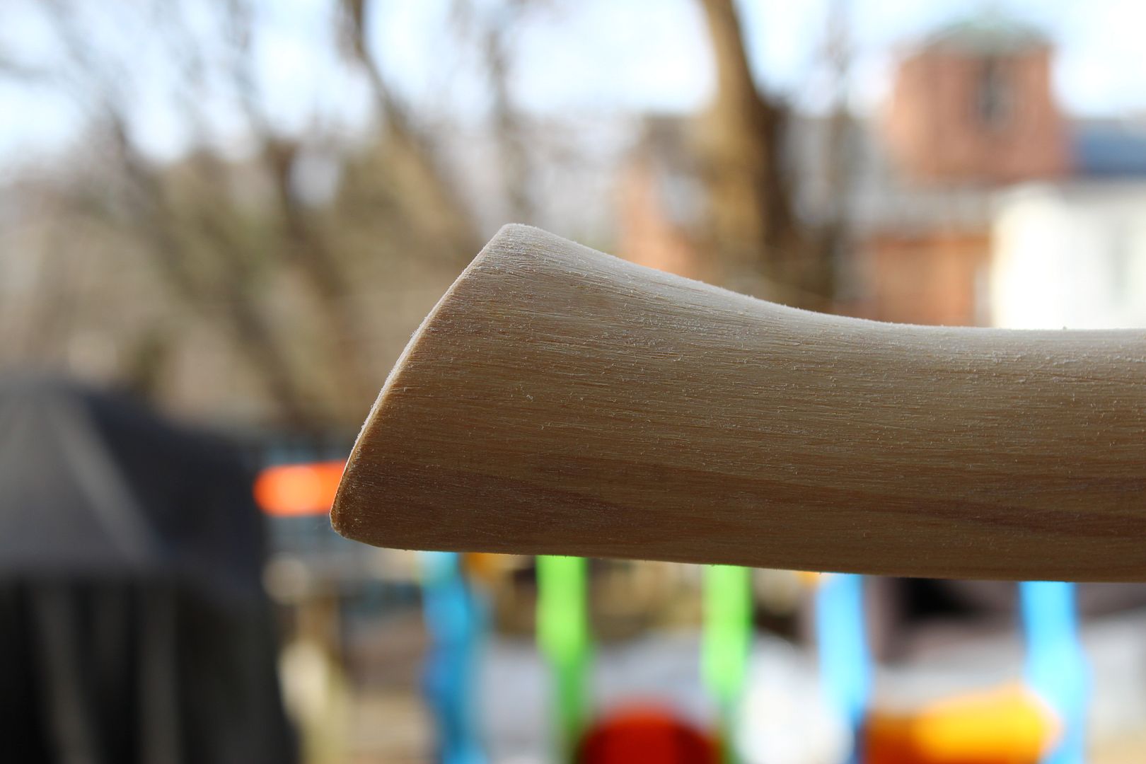

I also shaped up the foot, it was all over the place,

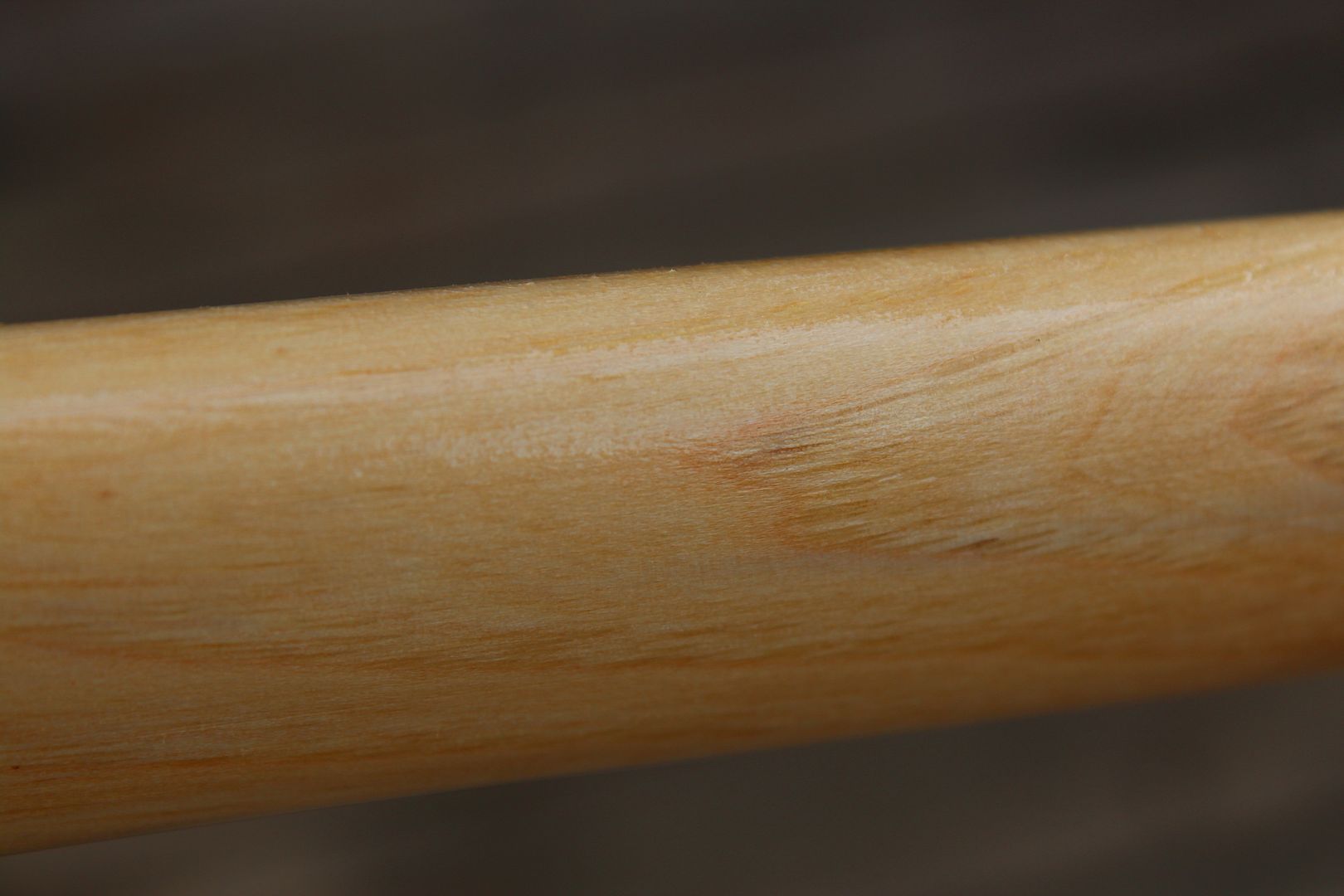

After the 80 grit,

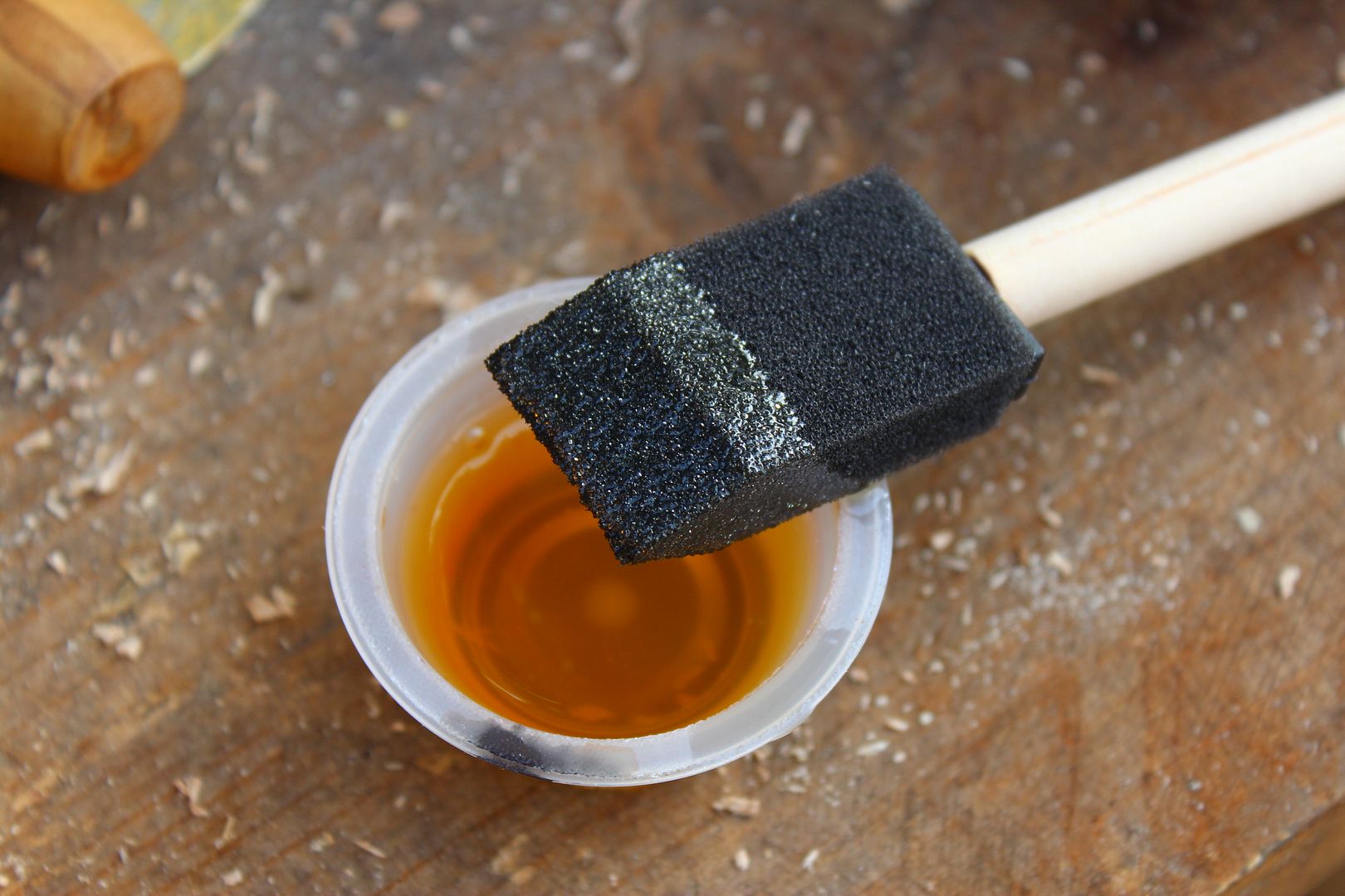

I finish at 80, then get the dust off, go for the oil. I put it on thick, let it set 15, then wiped the excess,

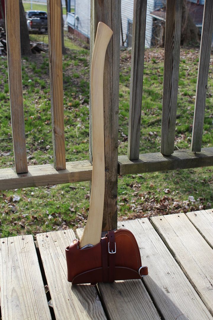

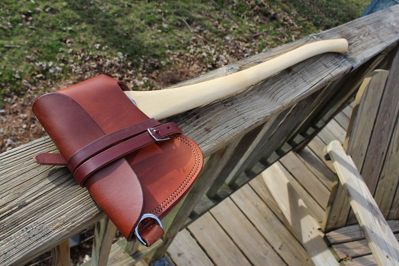

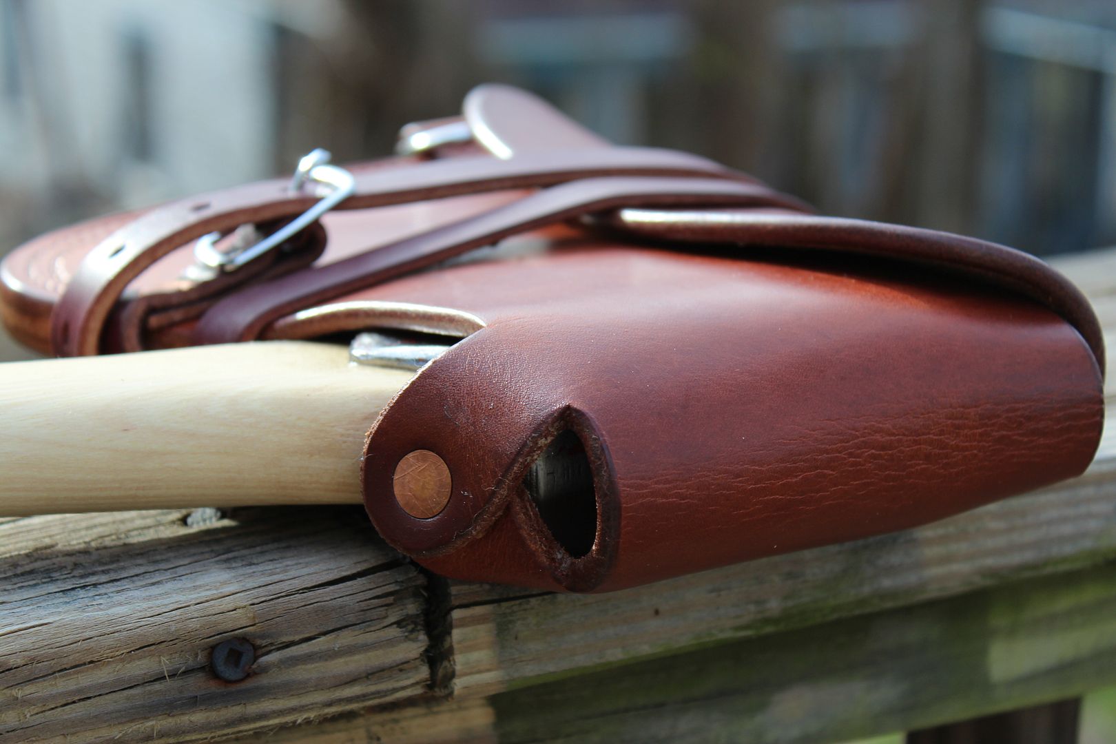

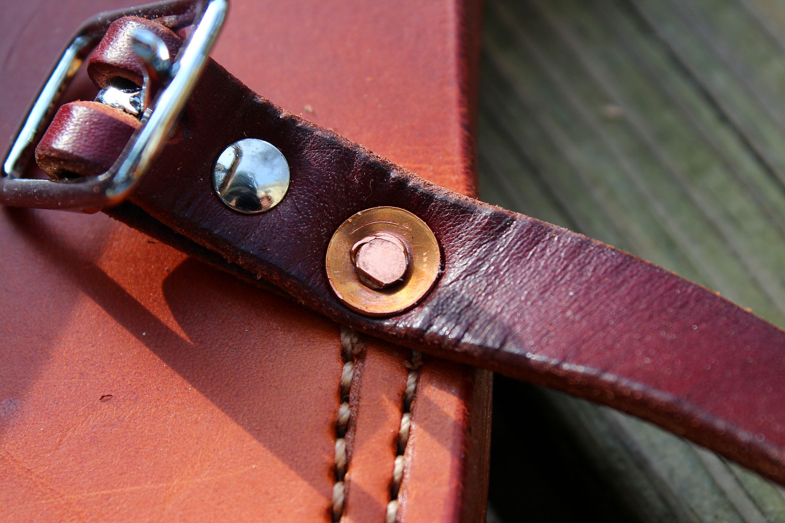

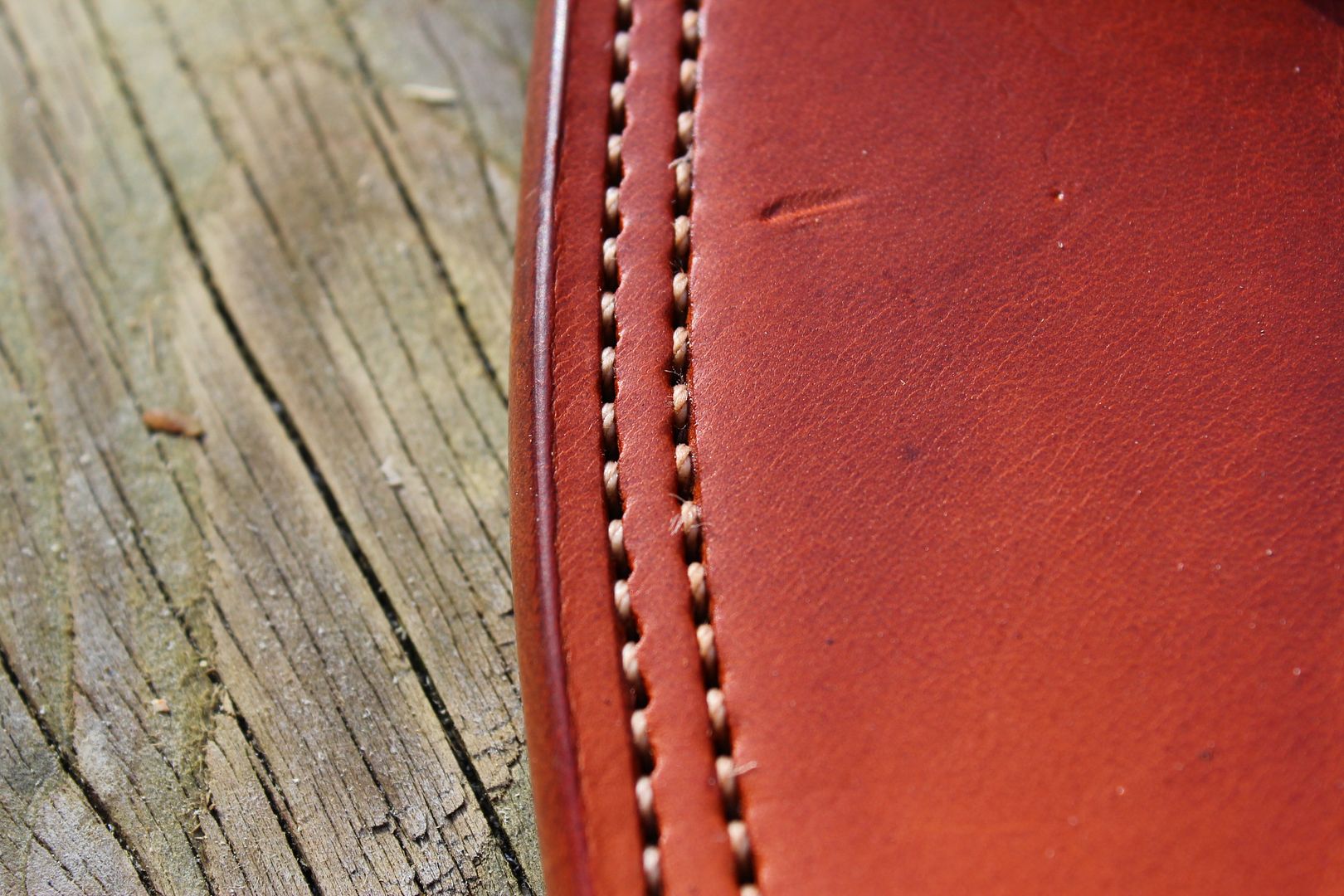

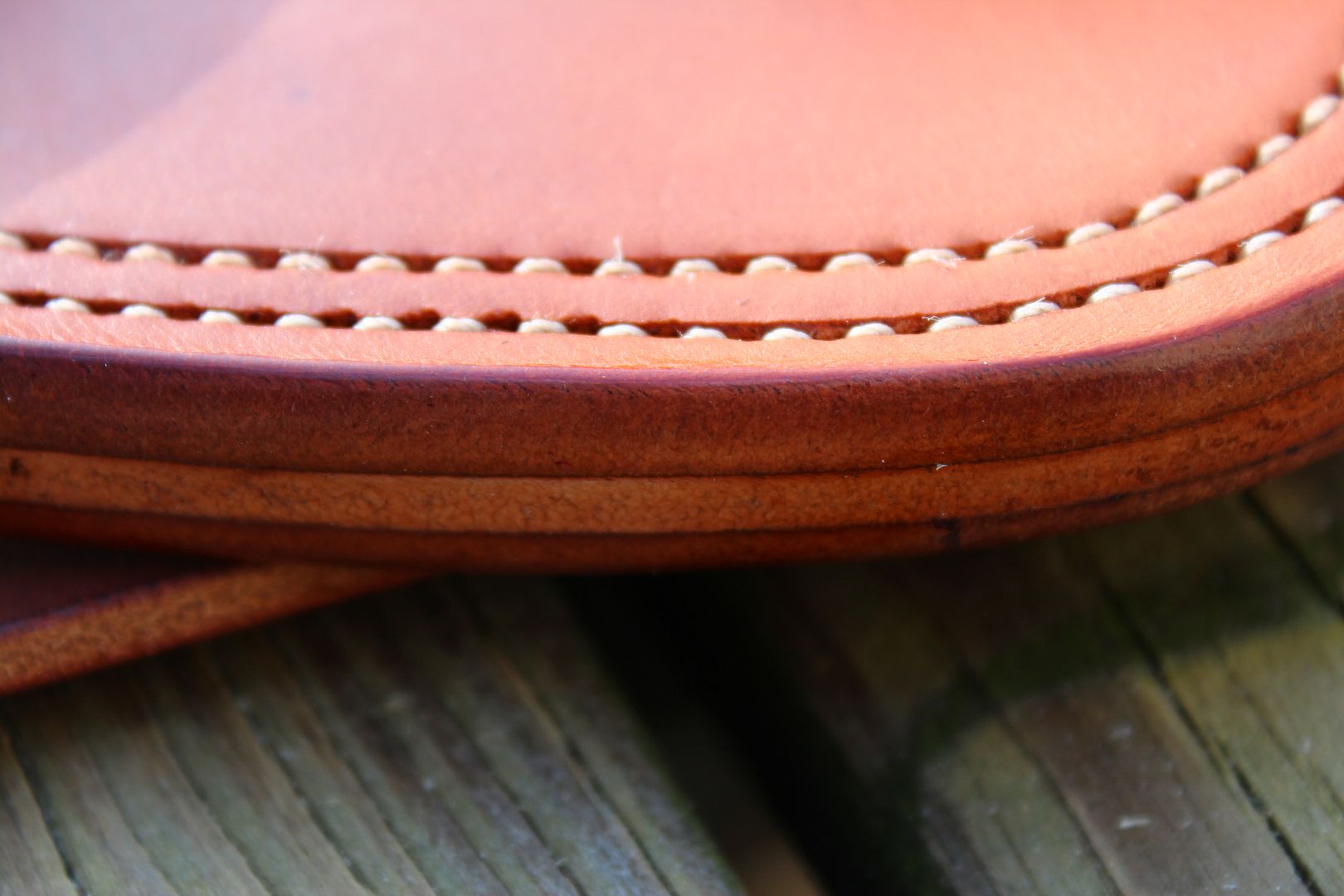

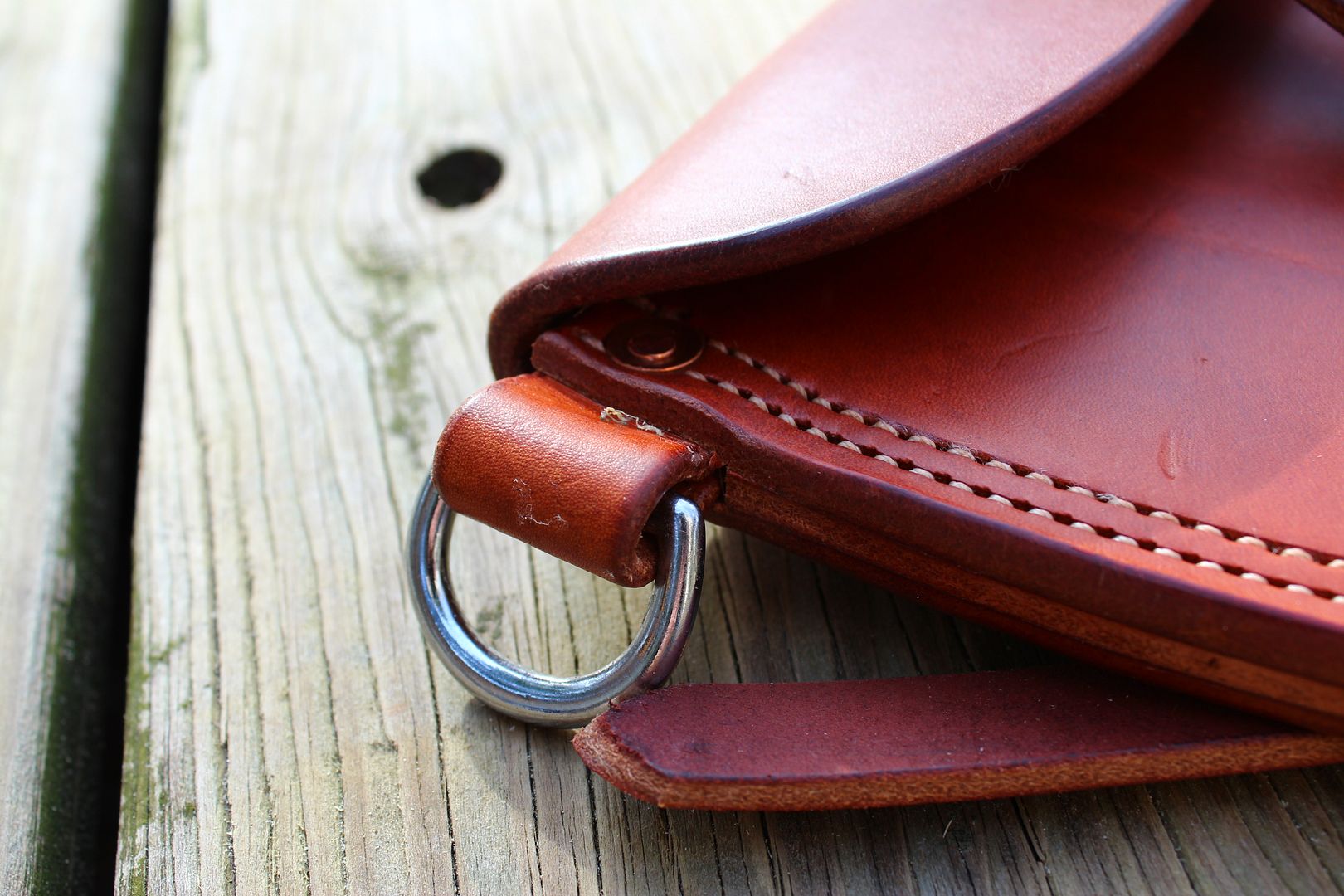

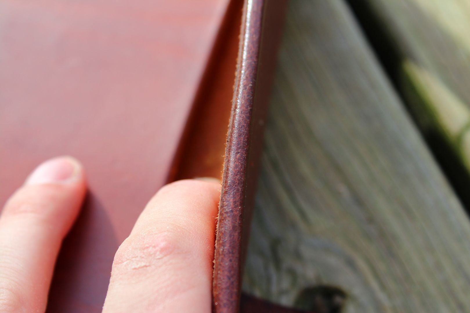

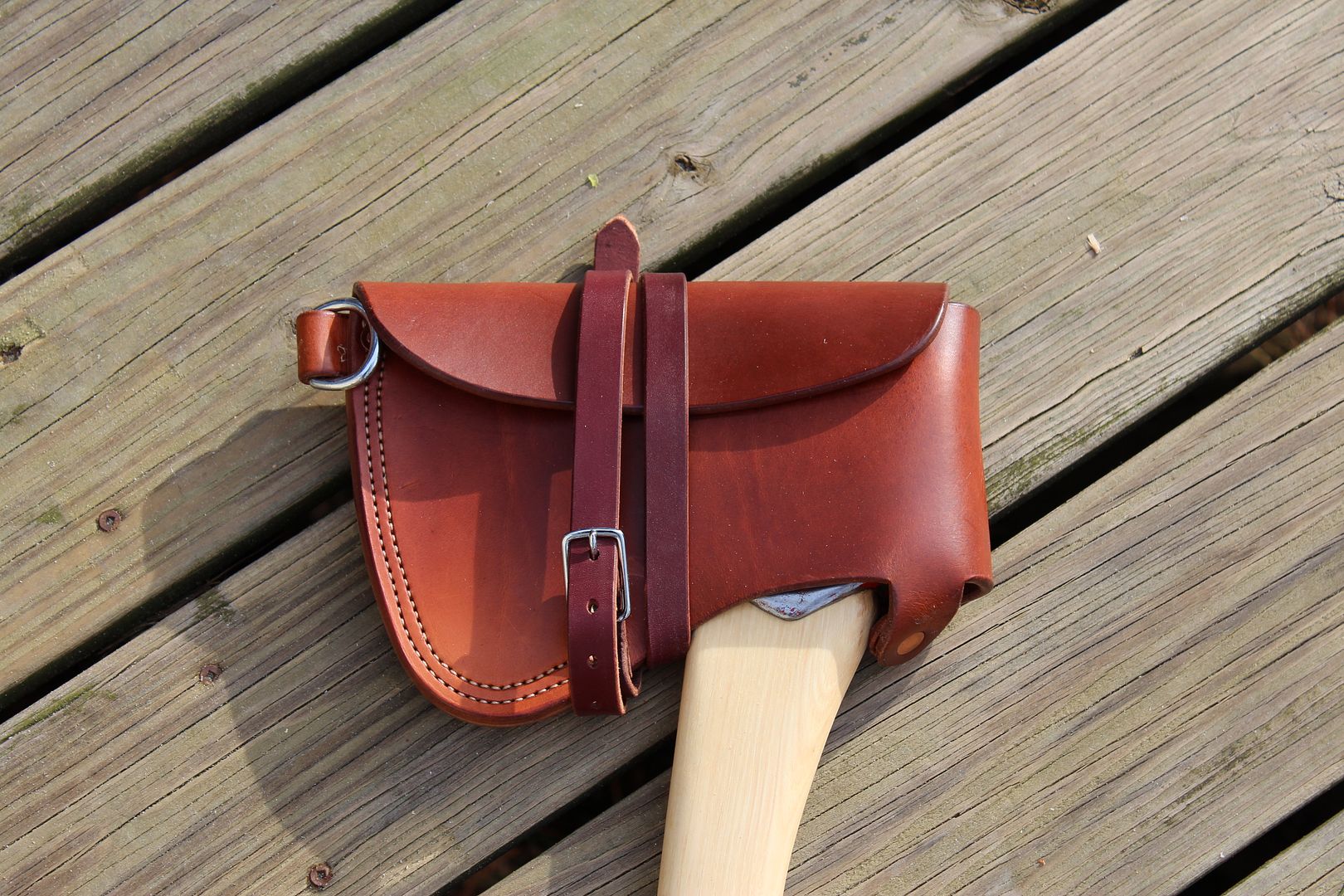

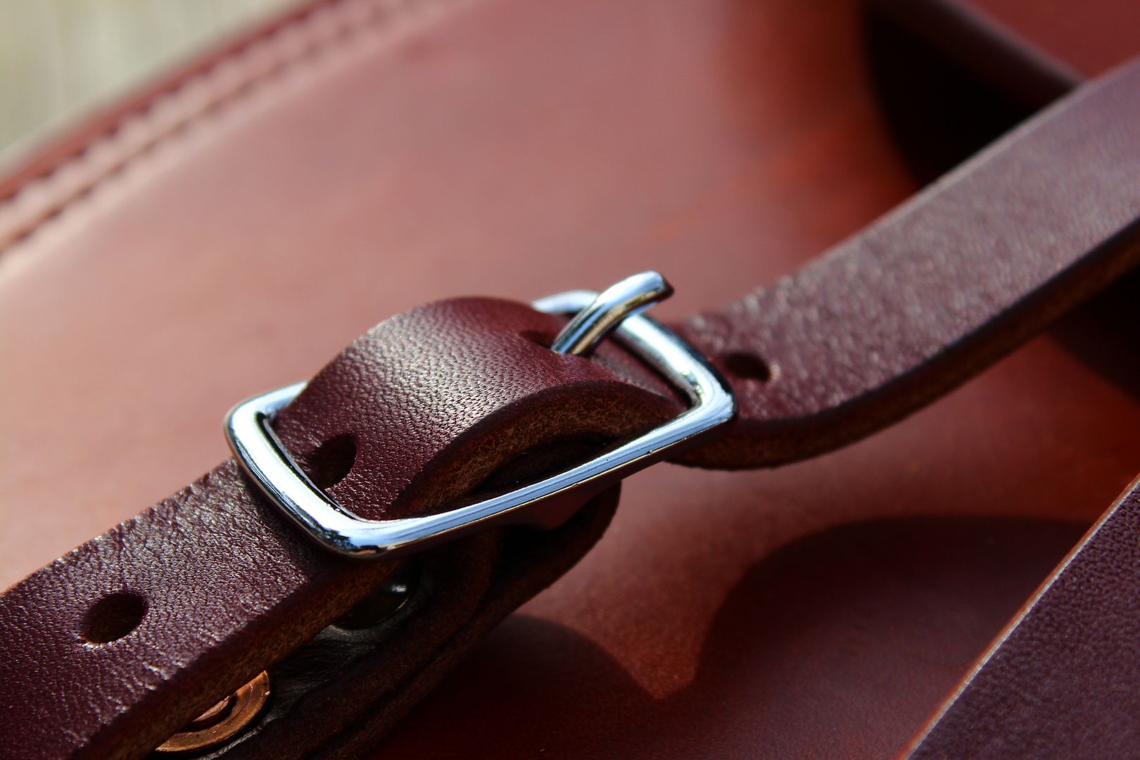

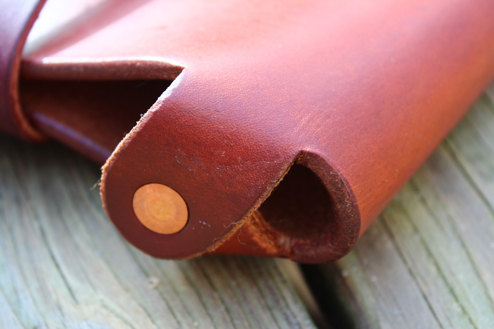

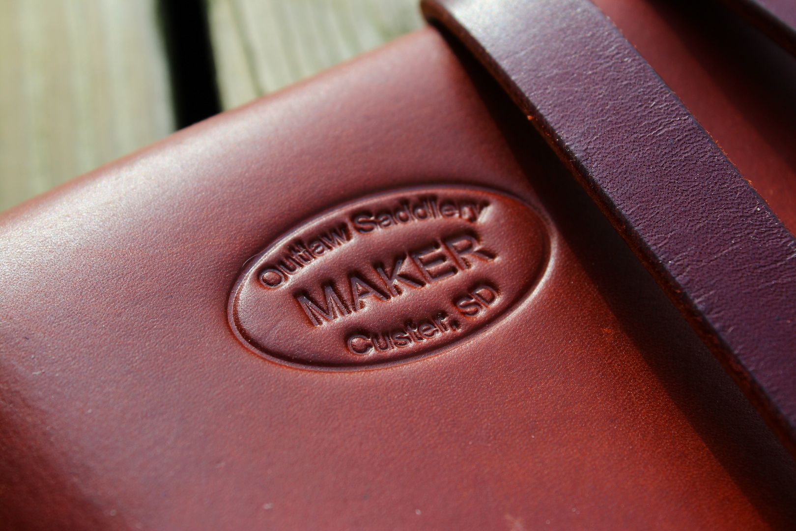

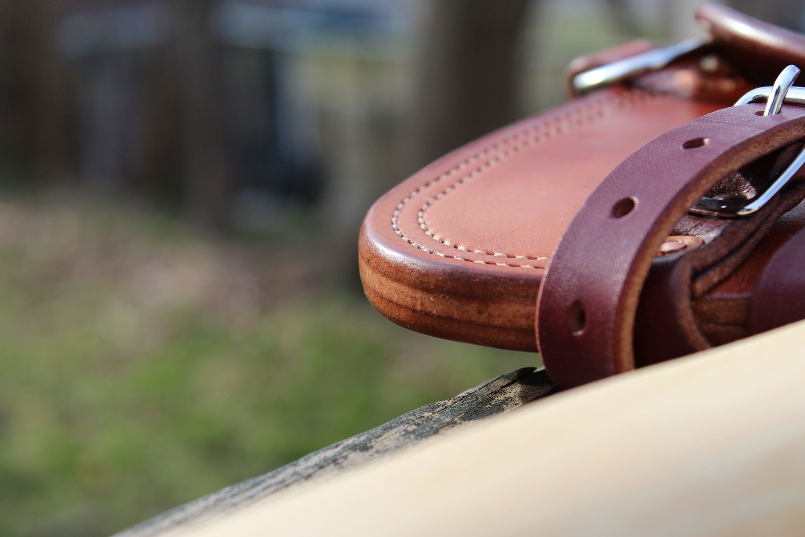

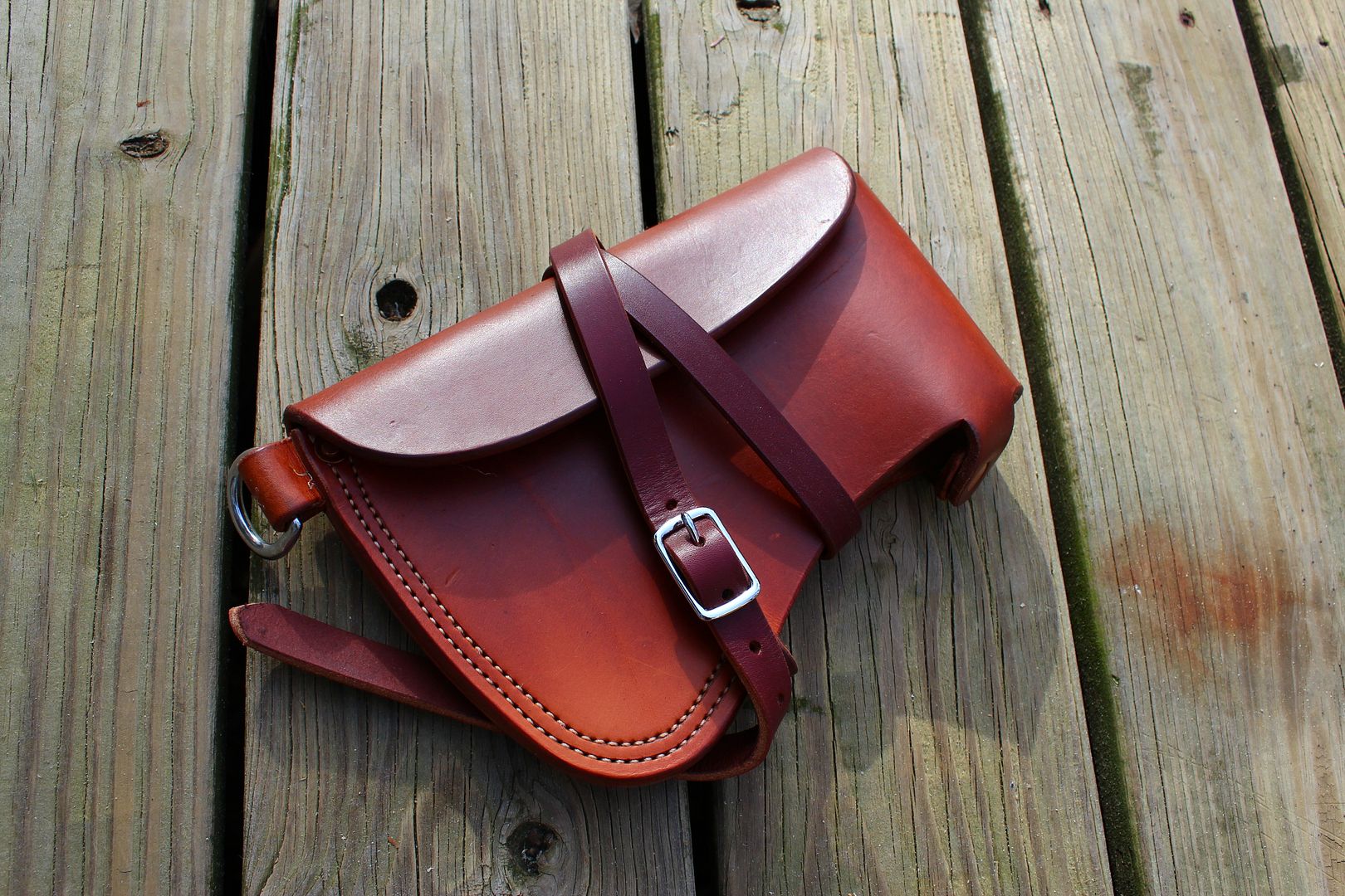

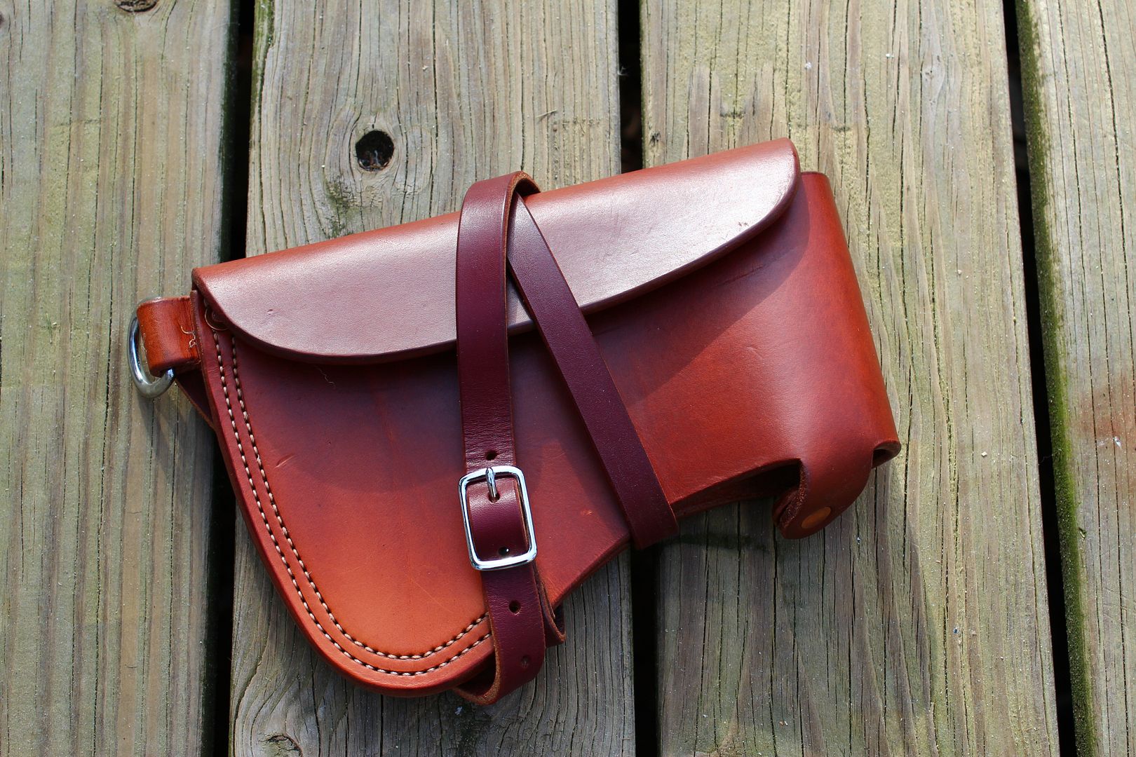

I ordered a sheath from Outlaw Saddlery on ebay. Been seeing their work for a couple years. So I bit the bullet and bought one. WOW was I missing out!!! This is the finest axe sheath I have ever seen.
Heavy 10-12oz!

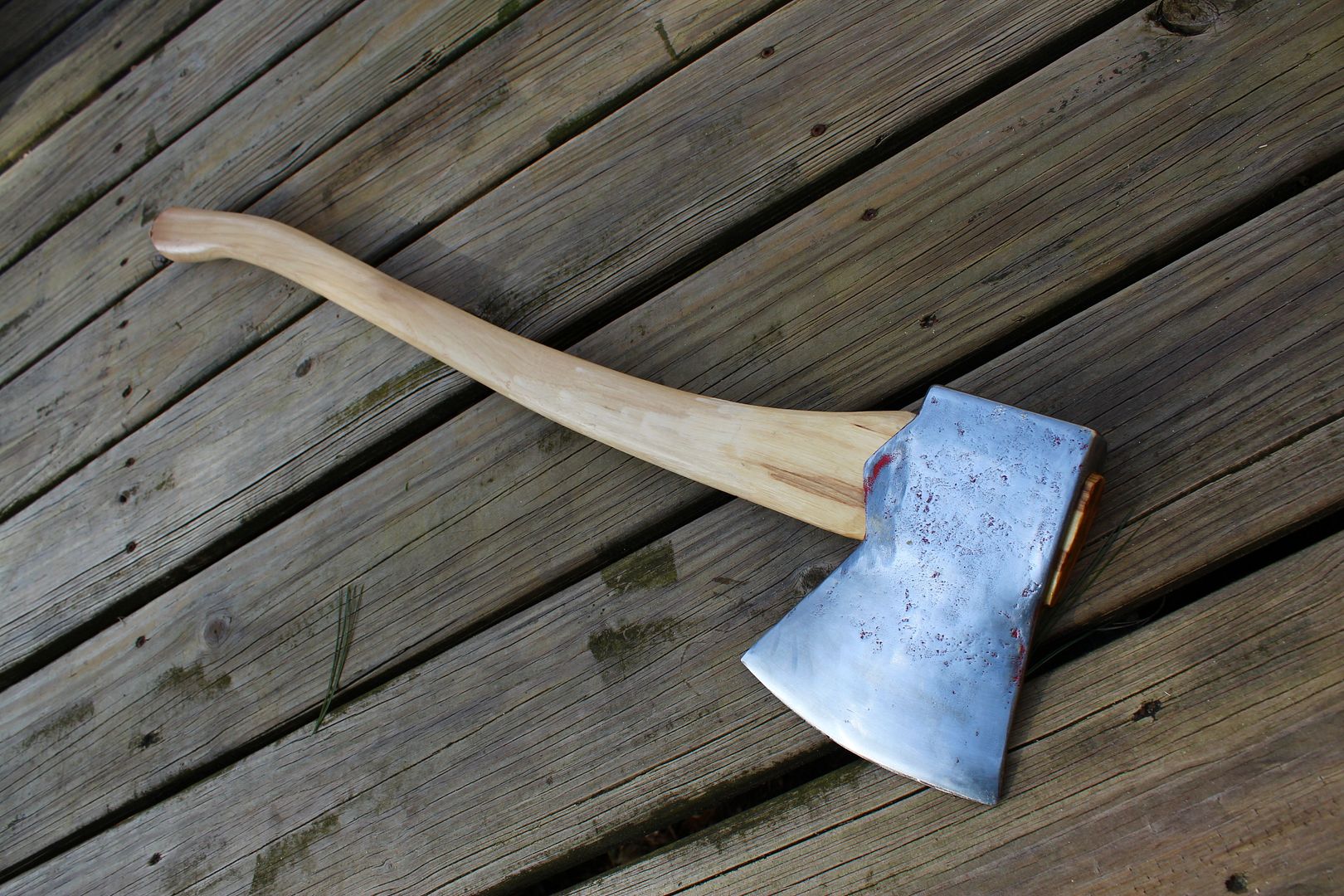

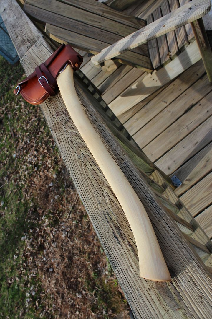

Lets check in, she stopped sucking in the oil, give her a wipe,

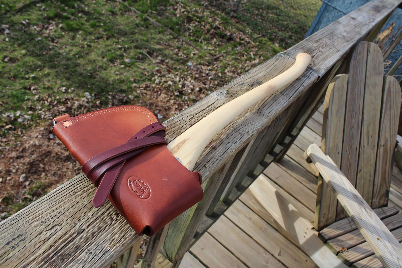

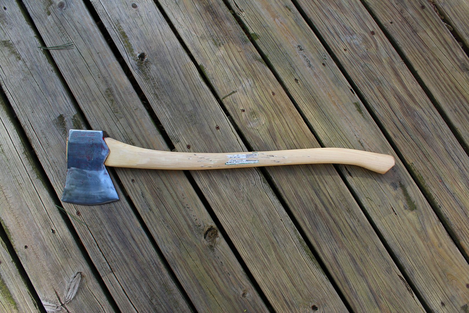

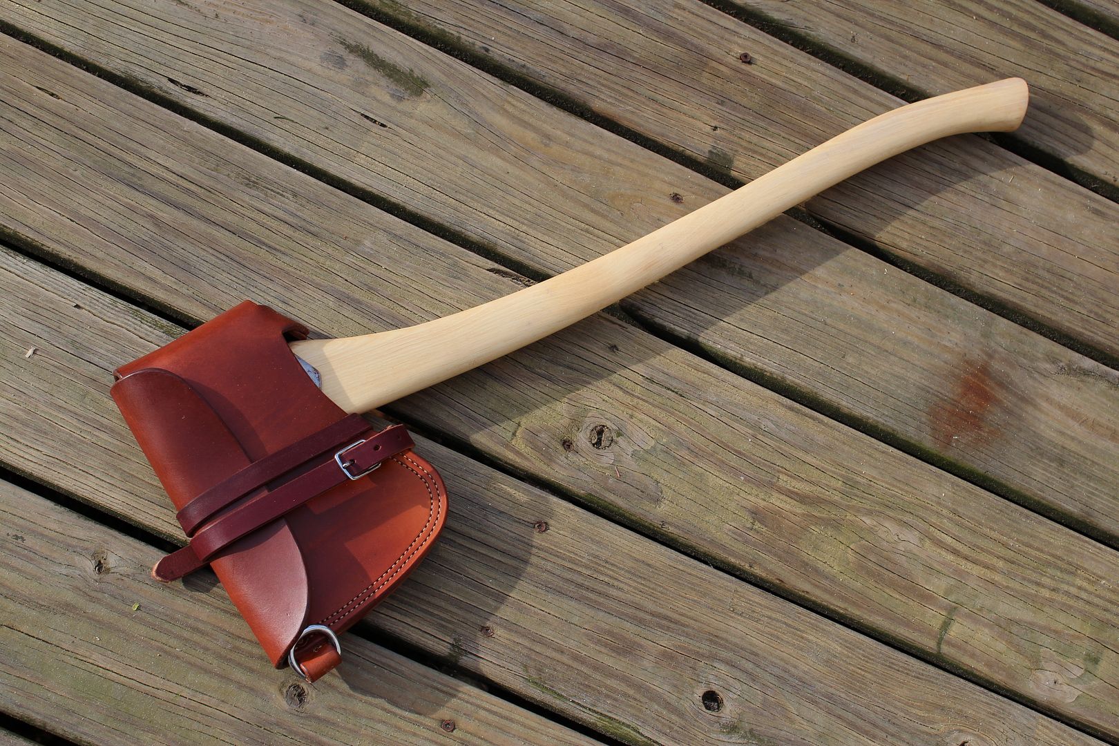

Now lets bring it altogether shall we?
mmmmmmm
Wife is on the way home with Fish fry reward.
Tonight when little man goes to bed, I am going to give this beauty of a sheath a nice mink oil treatment. Should come out nice.
Hope you guys enjoyed the thread!
Wow that's some nice work. Thanks for the tip on fitting the lugs, looks way faster than rasping. Very nice sheath, was it custom?
That is a great start to finish job you have there skogkniv.

Nice job. I've heard that pure mink oil is pretty decent, but it is very softening to the leather which may not be advantageous for a sheath. Compounded mink oil usually has agents in it that will eventually break down cotton threads and even the leather. My very favorite leather preservative is Obenauf's LP. It rocks.
For such a thick sheath, it will be fine for the surface. I have the non real synthetic stuff.

So this is the mysterious circle 'N' axe.
I do that, too.
It's odd, the head says 'Drop Forged' but the poll appears to have a casting seam on it.
I've been finding that lately as well. You fixed it well.
That sure is first class leather work. Really nice. But I wouldn't recommend mink oil on it. Animal-based fats are slightly acidic. And while they're wonderful on leather they're tough on the stitching. I'd suggest a wax-based oil/grease instead. They're PH neutral. Huberds is my old standby.
It's not actually a seam. It's probably where the swage blocks came together on the drop forge. Just wasn't ground out and finished all the way.

Casting popped right in my head as well with the back seam. So who knows. Steels seems sound. Only some chopping will tell of course. Another thought its its been sheered off after the machine stamped out the head?

man the sheath is super, best leather work i've seen to date.
