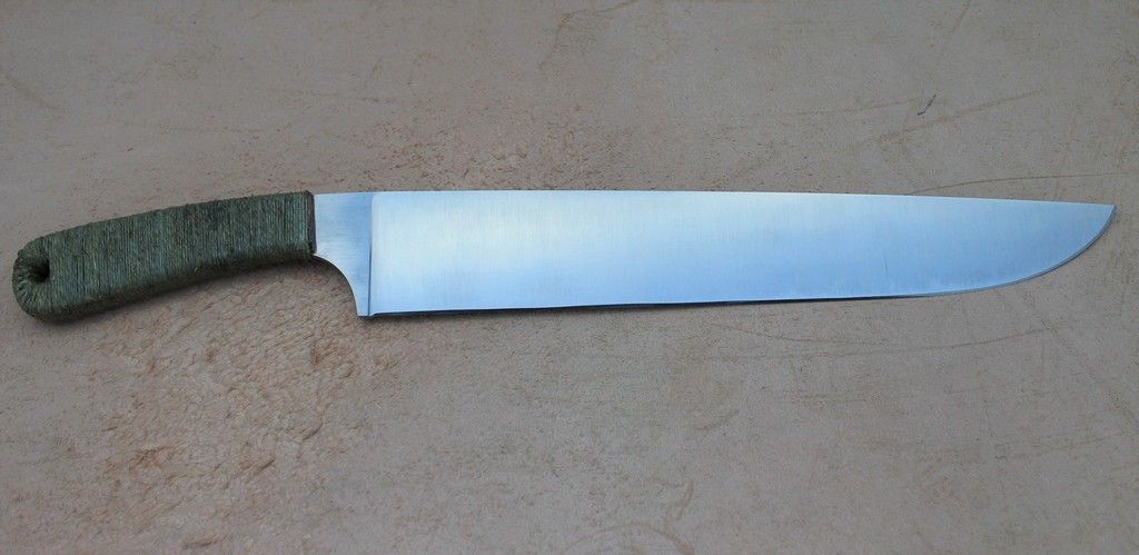

This one is a custom order that I finished up today, and was named by the customer. Its a chopper, built to spec. He plans to use it while he is down in Mexico, so I hope that it gets a good workout!

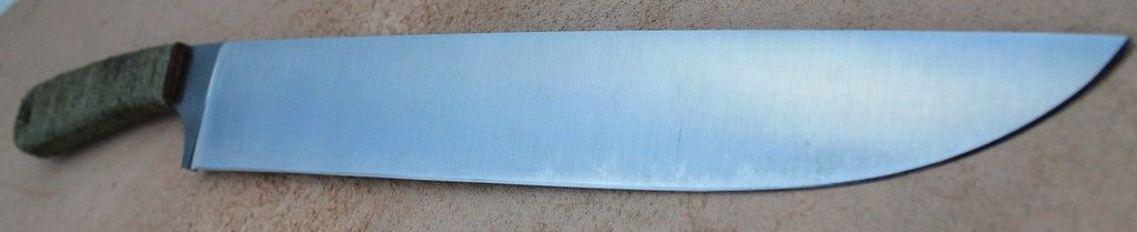

This thing is a beast in the hand. It likes to chop.
Here are the specs:

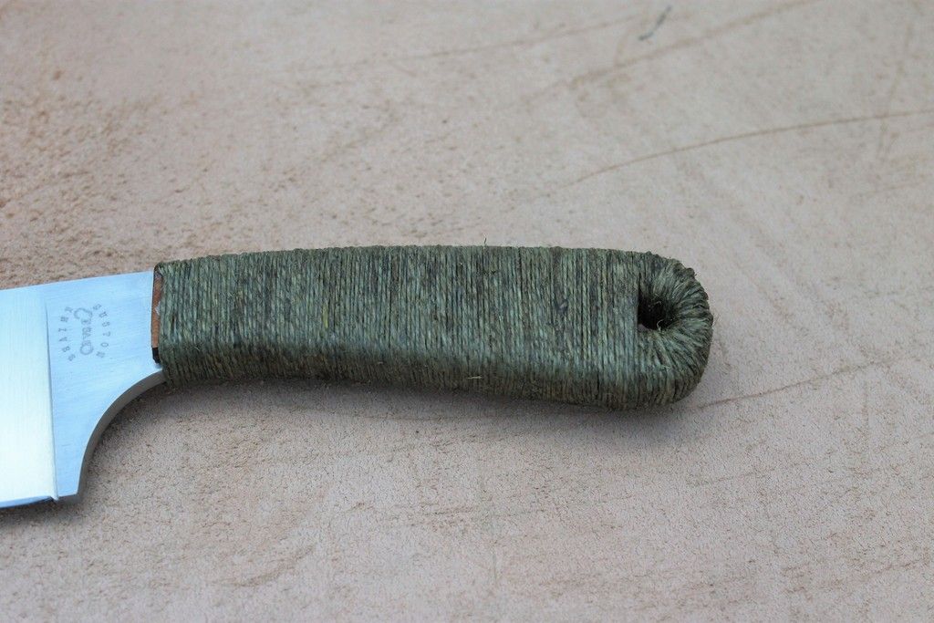

-Handle is 8-9 oz leather slabs, wrapped in epoxy soaked hemp cord.
-Steel is W2 hardened to a goal of 61 HRC
-OAL: 17.5″
-Blade length 12.5″
-Height at ricasso: 2″
-Thickness at ricasso: 0.2″
Thanks for looking
