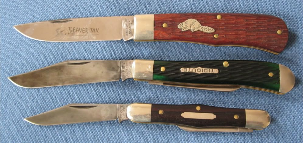

My only real nail breaker was a GEC #53 Cattle Baron that I eventually sold. More so because I didn't really like the color of the bone than the pulls. My strongest user was this #73L that I eventually used jeweler files to round the tang at the corners thereby making it easier to open. Now its about a 7 instead of a 8.5. The second pic was my first #73 user that I also rounded the tangs a bit. You can roughly see the differences between what a single blade #73 would look like compared to a big clip #48. Same #33 in both pics.
