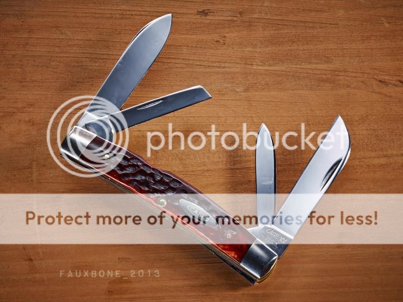

I'm a big fan of my 6488 Congress. It's in great shape and I carry and (carefully) use it regularly.
Everything is nice and tight - good snap, no gaps, no wobble :D
The only thing that troubles me is the fact that that the coping blade is so stiff that in 2 out of 3 tries I don't manage to open it :grumpy:
I have oiled the joints and practiced a lot but the thumb nail on my left hand is in poor condition by now...
Who knows a trick? Is there anything I can do to make the action smoother ?

The nail nick could be deeper - maybe that would help. If I open the spear there will still be the large sheep foot blade in the way:

Here's something to try. Get some dry graphite powder and sprinkle it in liberally in the joint. Work the blade as much as possible and let the graphite work into the joint. Remember, the key is dry graphite.

I just got a Rough Rider congress with this same "problem," but for the shield-side pen blade. The real issue isn't friction or spring strength, but that the nail nick is too close to the pivot to get any torque. Looks like that might be contributing to your coping blade issues. I figure it'll loosen out over time.
I tried the graphite and it really helps a lot. Thanks for the idea! It's still tough to open but I think I can break it in this way.
The shorter blades are hard to grab on the shallow nail nick with the longer blades sitting behind. And like this I can't even use a knife pick...
The strong springs add to the problem but I just love this solid feel - once the blade is open :D

You said your left thumbnail was getting worn out, but I assume you are right handed (most people are), so your right would be both stronger and more coordinated. With the knife closed and the nick of the coping blade facing you, just turn the knife 180° and open it down and over with your right thumbnail. Now that the graphite has worked, this should be much easier.
