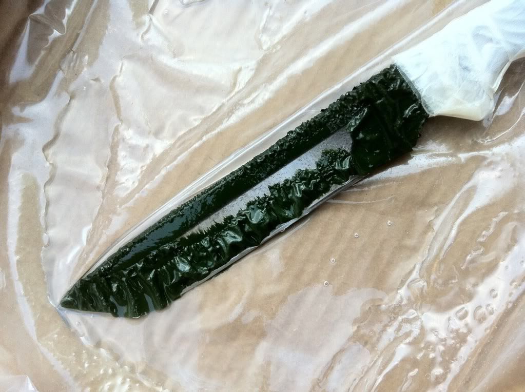

I stripped my DSF today and wanted to share.
It was very easy, I used a can of spray stripper.
Sprayed it down, came back 20 minutes later and this is what I saw! :eek:

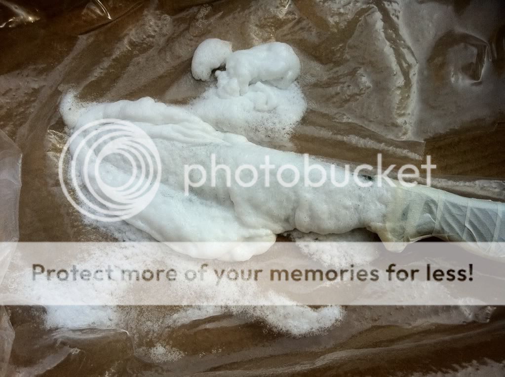

About a minute with a nylon bristle brush and rinsing it off...
It was much easier than I thought it would be and I am very happy with the results, the DSF looks really good under that coating! Anyone that's on the fence about stripping their knife GO FOR IT!!!!

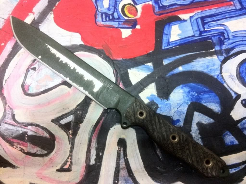

Here is my SAR5 stripped
Just dimples and grey INFI under there.

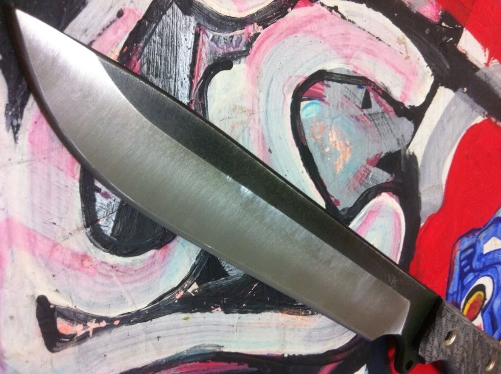

Scrapper 5 that I stripped and convexed.

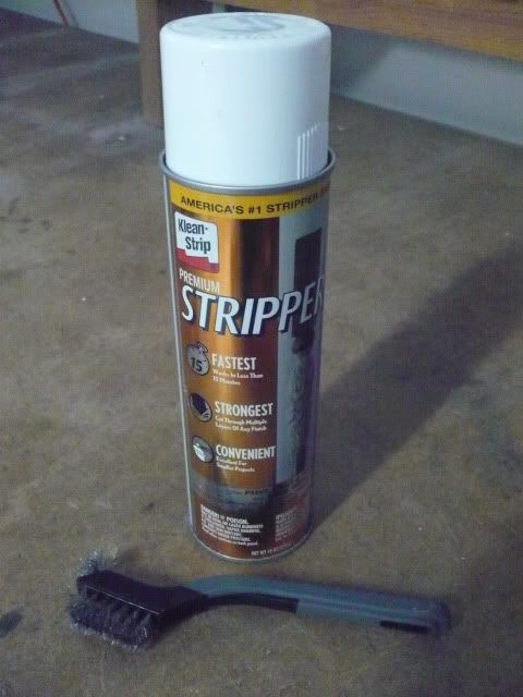

what exactly did you use to strip it?
It's paint stripper in a can, gel paint stripper also works very well. And it's okay if the stripper gets on micarta scales, it won't hurt it any.
